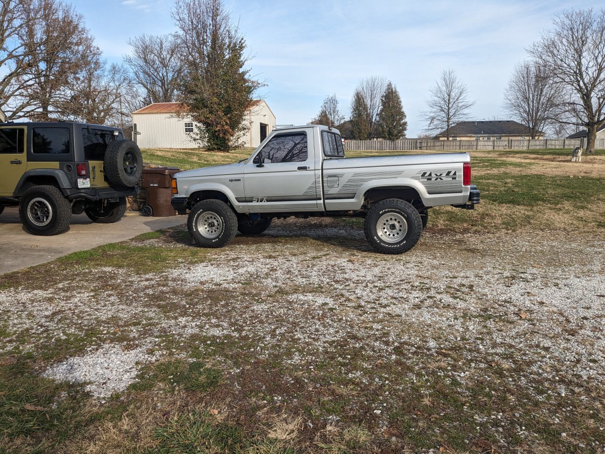

91 with James duff, add a leaf, 31x10.5, Does ride little stiff with Duff shocks but I don't wheel it.
