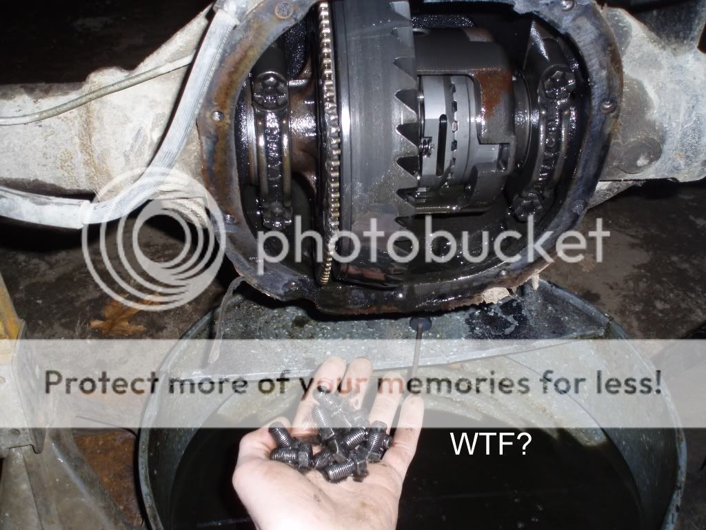

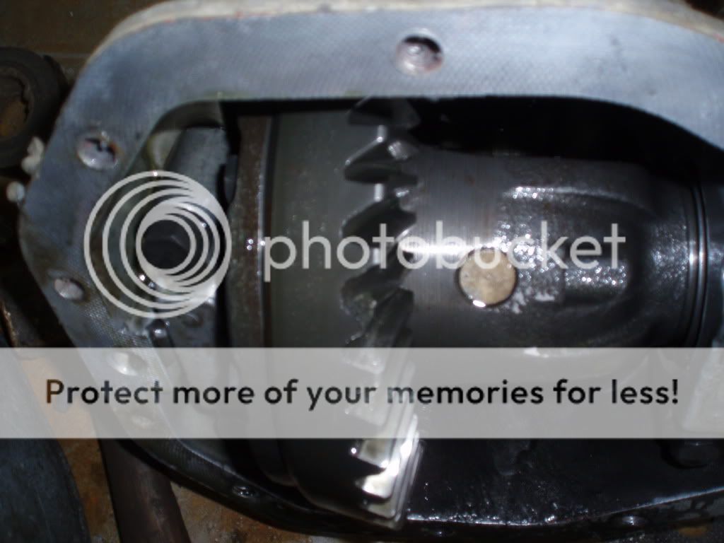

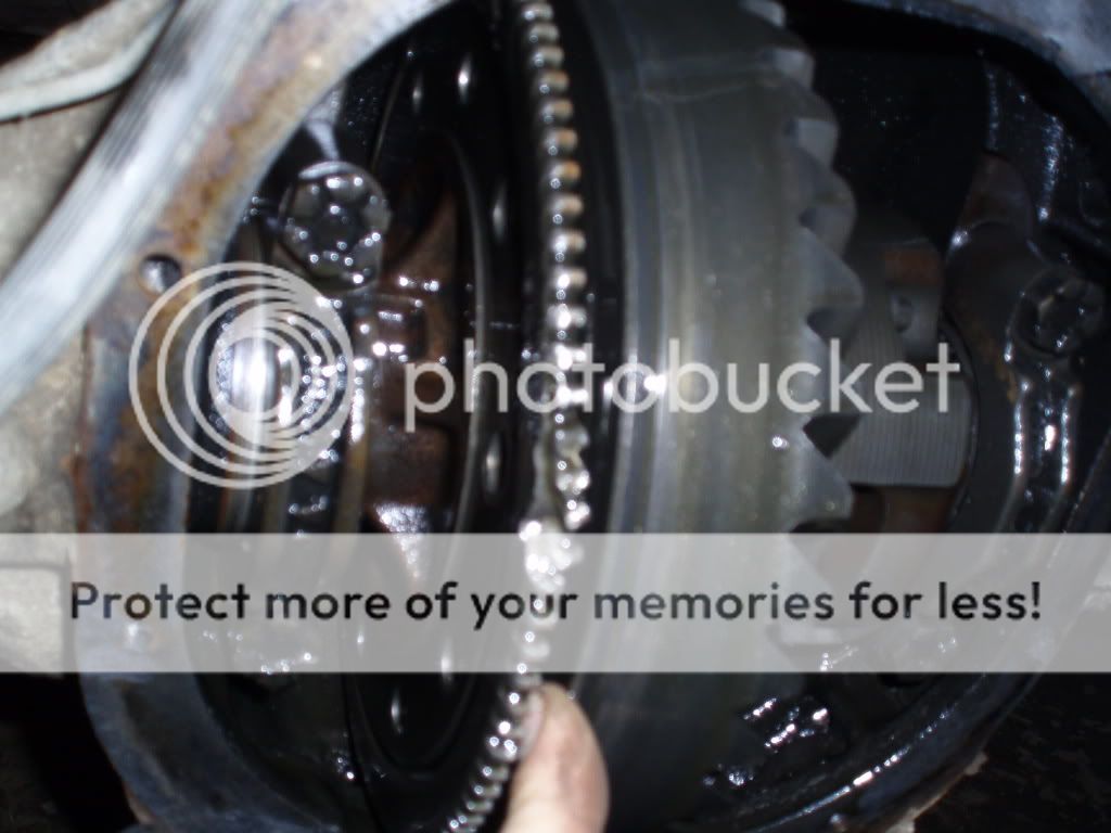

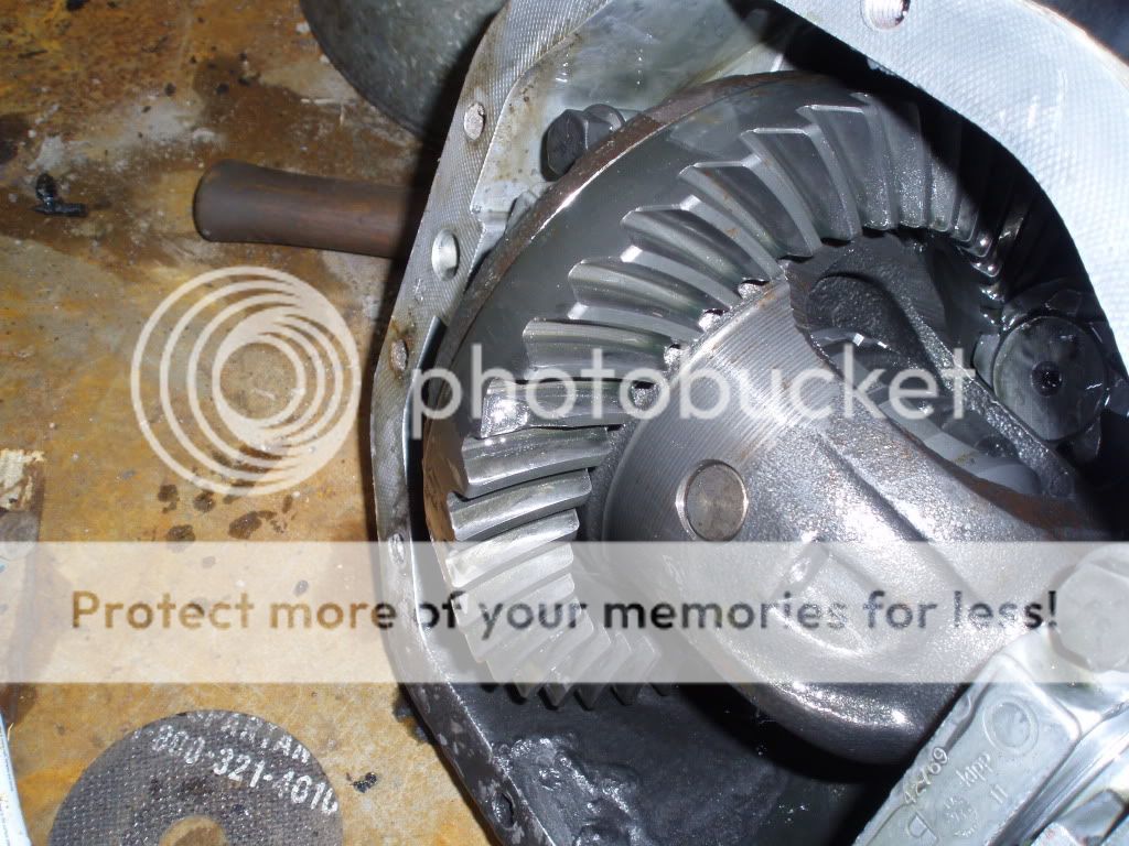

Hmmmmmmm. I think that the thread lock might have been forgotten on the ring gear bolts.
Carnage totals so far:
Thrashed ring gear bolts.

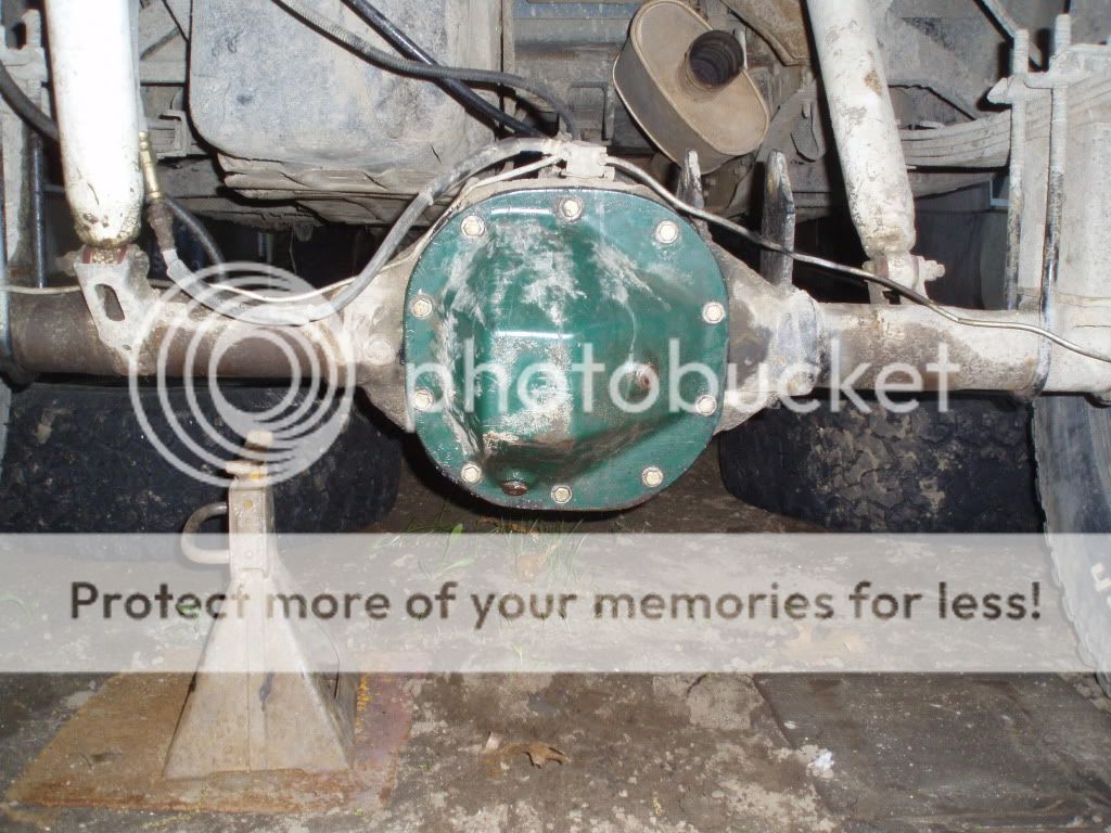

Dented diff cover. .......... Yeah. Dented.........
egged ring gear bolt holes in carrier.
Now, how in the heck did that happen?:icon_confused::icon_confused: :icon_confused::icon_confused:
At least it's not a busted pinion like you thought before.
Still..............................Weird :icon_confused:
Wahh Tim.... I hope my install last night holds together with blue loc-tite....
... I don't like the look of what happens without it :(
Well man, atleast from what you've told me the gears are salvagable... Crappy that the problem was a result of install, hope you loc-tited the front :X
He had a friend do the gear install.
It doesn't look to me like lock-tite was used either.

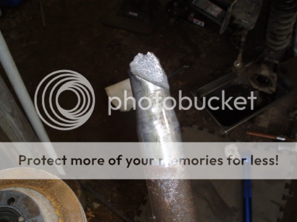

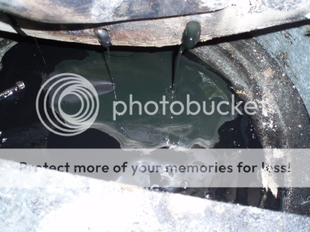

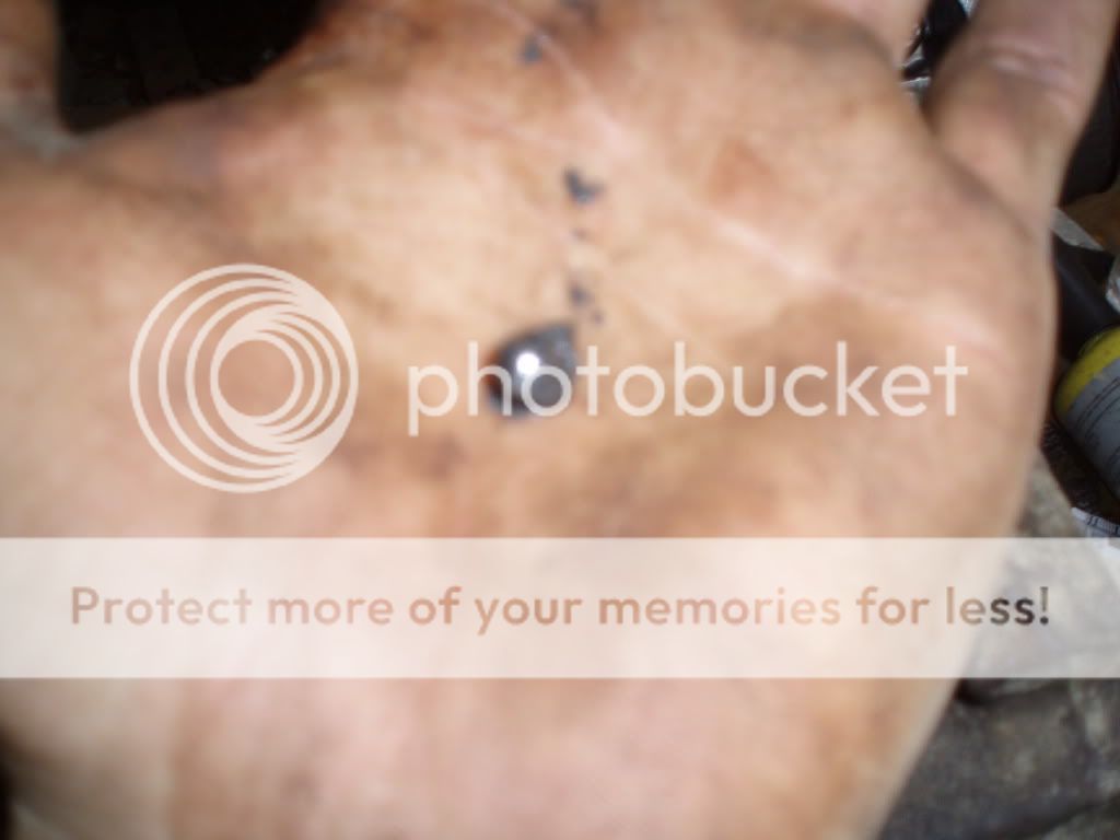

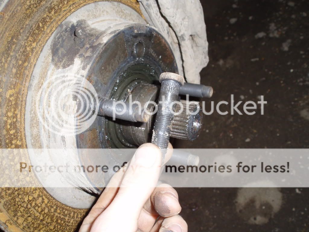

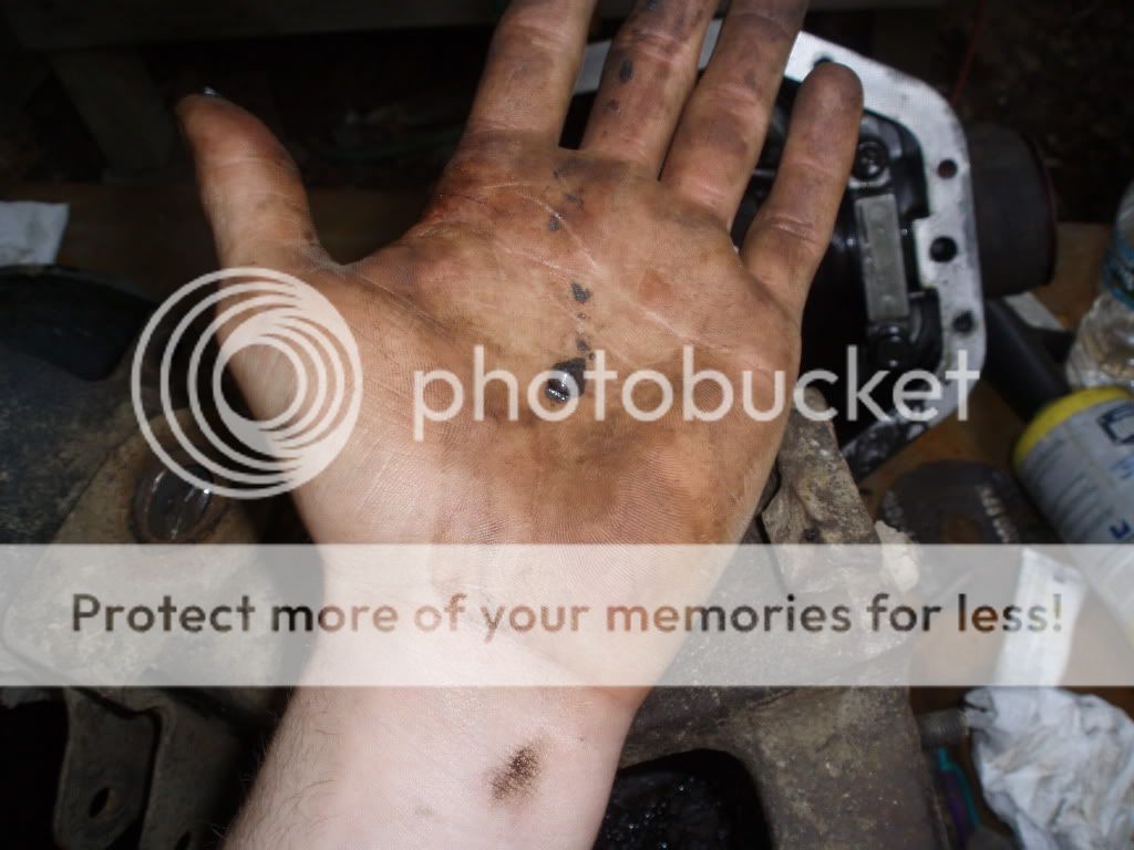

I suspect that this gear damage was a result of a piece of the broken shaft getting where it shouldnt have....... that is between the ring and pinion thus the broken tooth. that combined with the lost oil which wasted the bearings leads to FUBAR.
Thus the carnage went like this
Missing/insufficient thread lock----> Ring gear bolts fall out------> Front wheel drive + Stupid decision to wheel the next day :badidea: ---------> borken front shaft + attempt to drive home --------> chunk between ring and pinion --------> AAA --------> Gears destroyed.................:bawling::buttkick: :owned:
