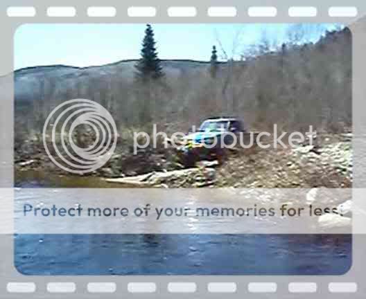

Then a small water crossing.

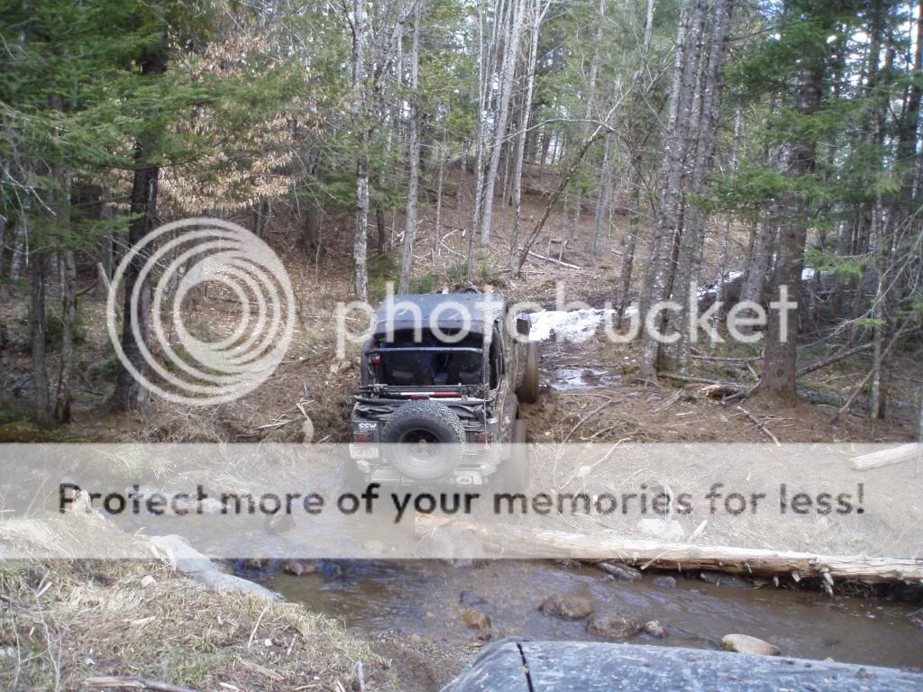

Lifting my 97

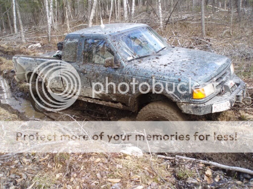

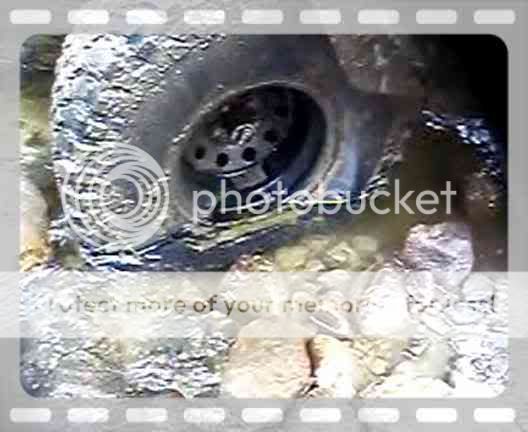

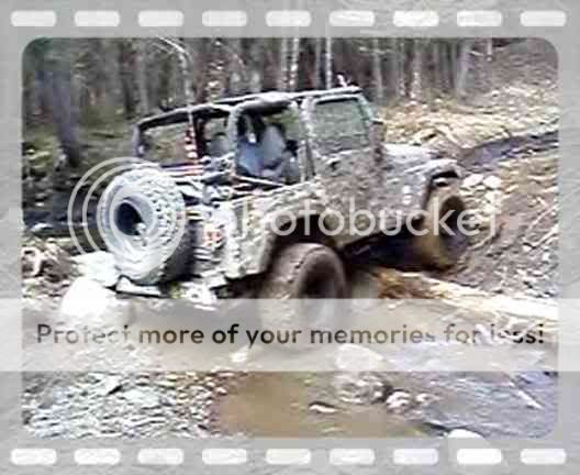

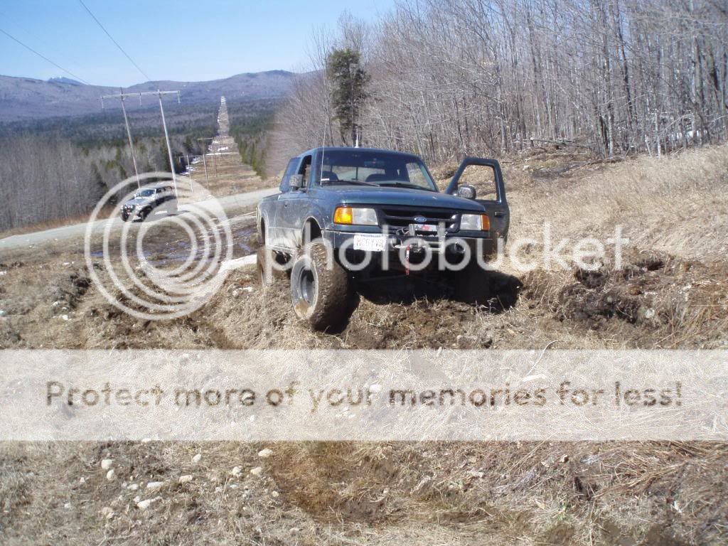

And then after some more dirt roads, this happened.

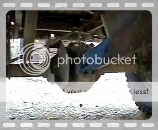

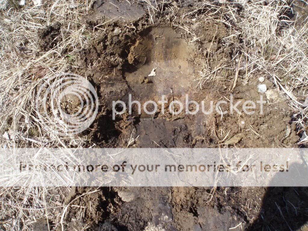

I was feeling it out, trying to see if I could get any traction back, leaning out, looking at my rear tires, 4Low, engine at idle, I hear a *POP* and my driver side back tire stopped turning..........
Oh hell.
"Dude, I think I just snapped an axle shaft."
Um........ This side isn't turning either........
Oh crap.
Lifting my 97
Lifting my 97
Lifting my 97
Lifting my 97
Lifting my 97

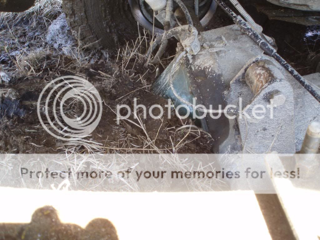

I winch out of it, turn around and get back on the road. Pull the fill plug, turn the drive shaft and nothing moves...... Great. I snapped my pinion shaft.......

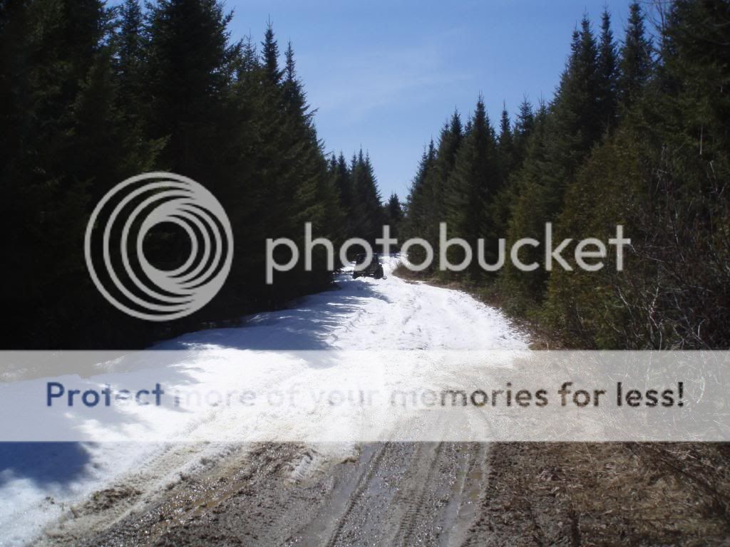

So we decide to head back but try to avoid that water crossing. We ended up getting into more trouble as a result.

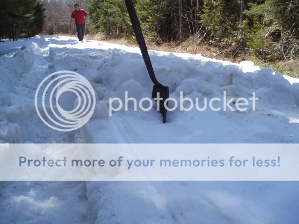

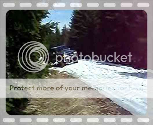

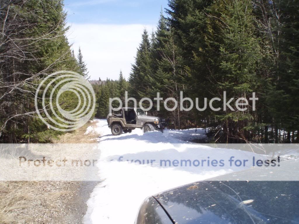

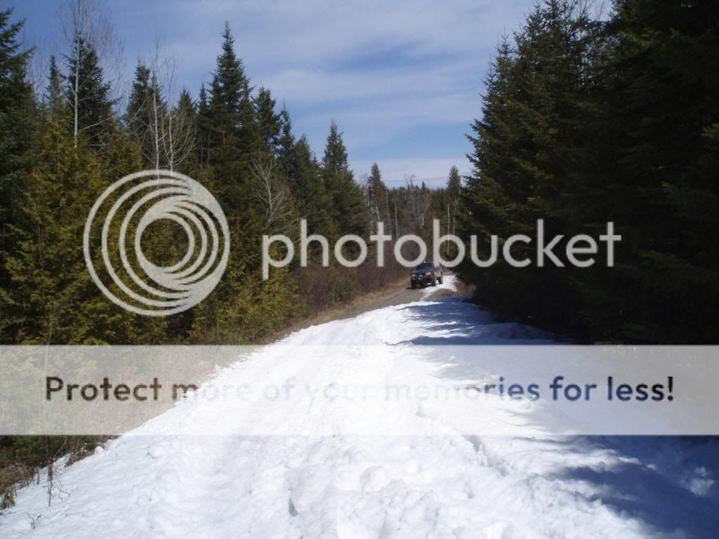

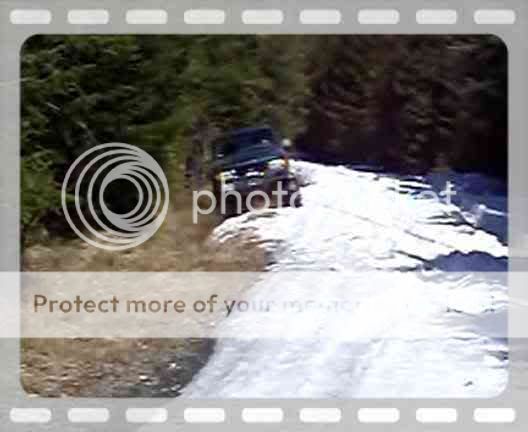

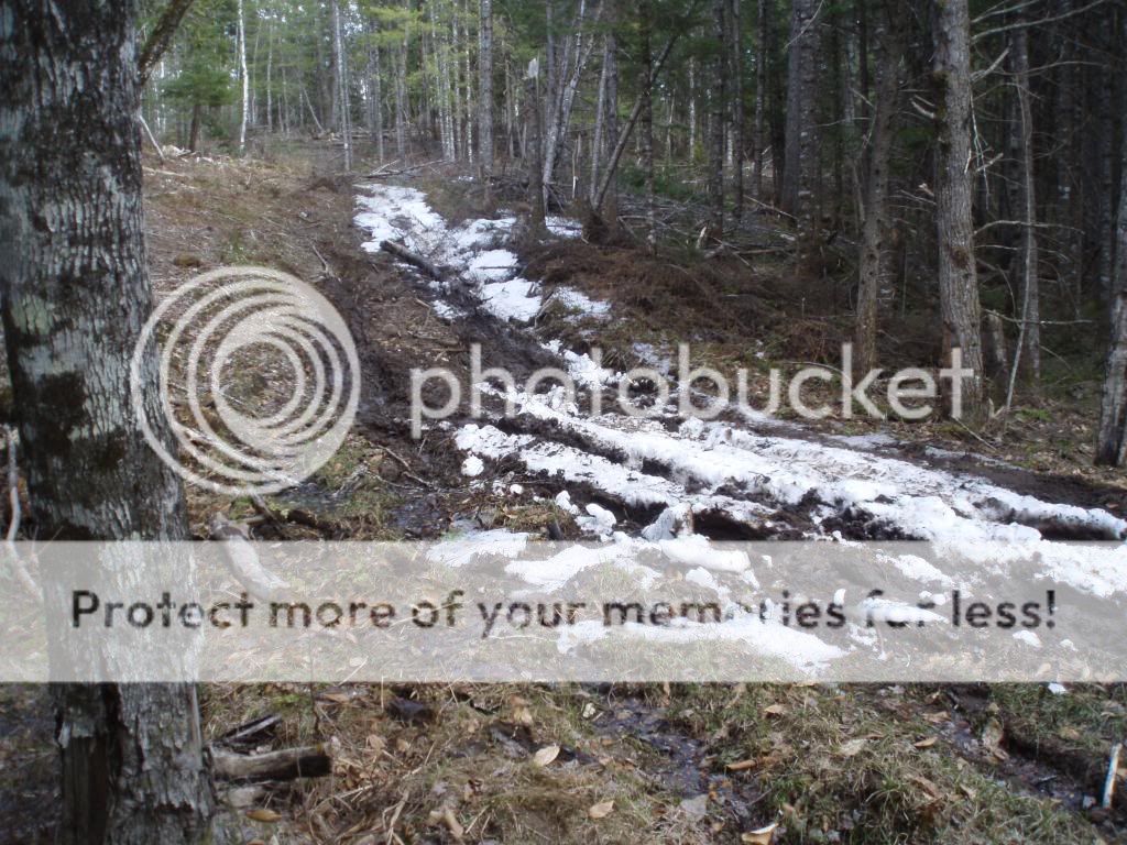

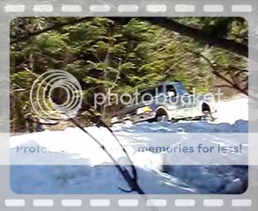

We go down a snow covered hill and come to a dead end. We have to come back up it.
Lifting my 97

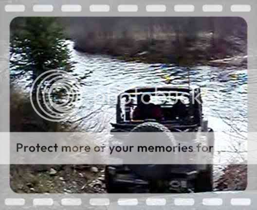

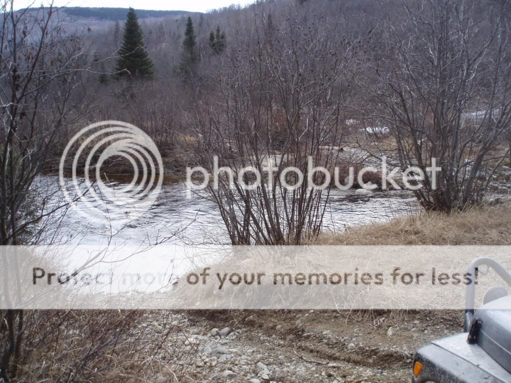

And then we get back to the water crossing.
Lifting my 97

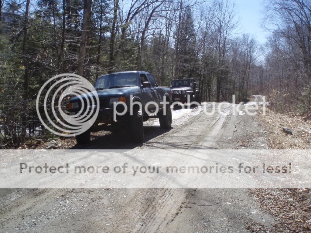

And finally we got home.

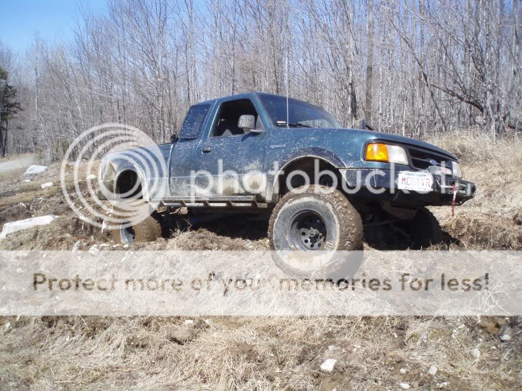

The truck did great. I was keeping up with my buddy in his open diffs jeep on 33" ATs in my front wheel drive locked truck on mud terrains.
Lifting my 97

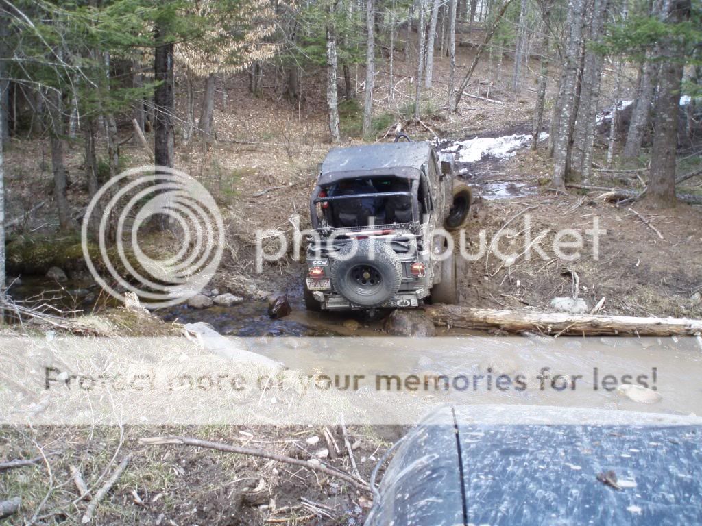

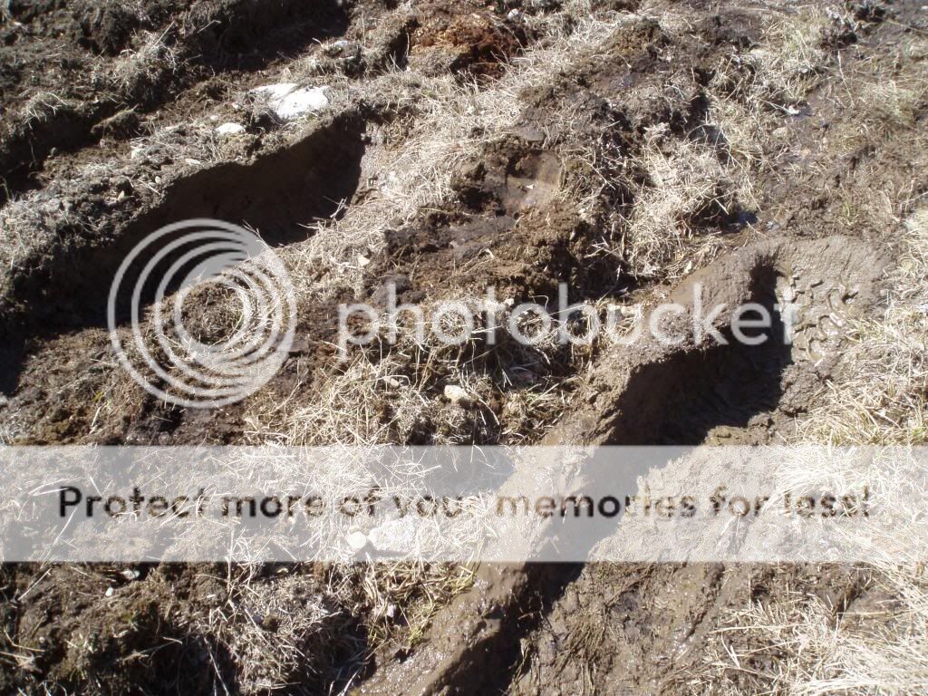

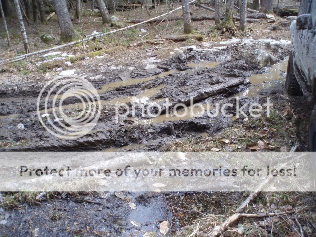

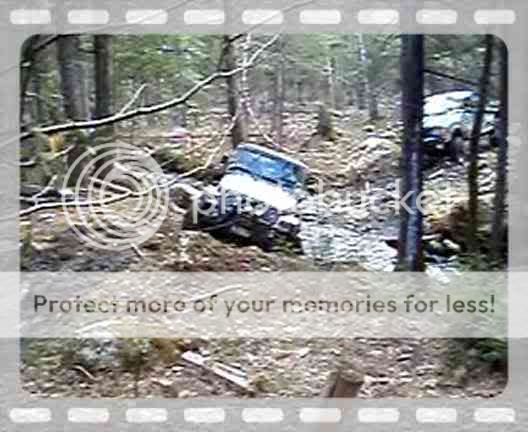

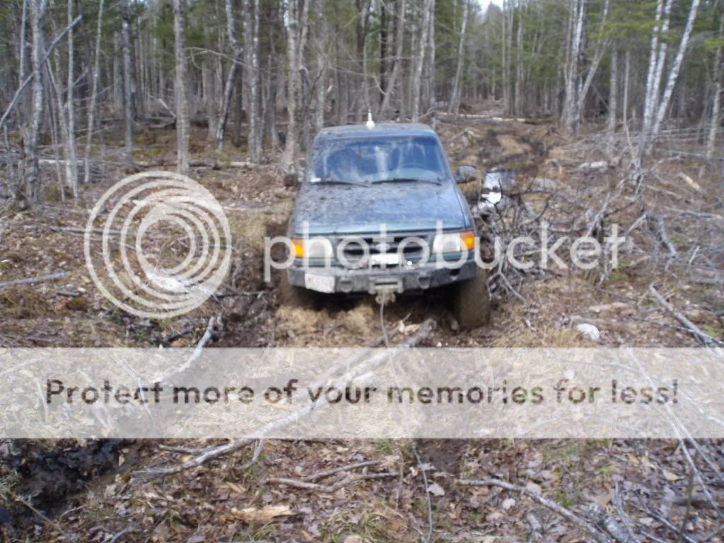

And then I blew my driver side inner axle shaft coming back through this brook.

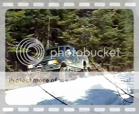

The next 300 feet were a winch fest.

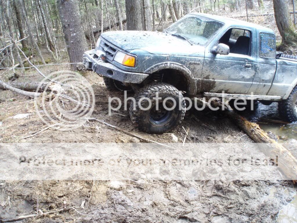

And then I almost pulled this tree over. It was straight up when I started winching off of it. Inspite of having the tree strap right at the base of the tree, the soft ground wasnt strong enough. I resecured to a different tree and winched out.

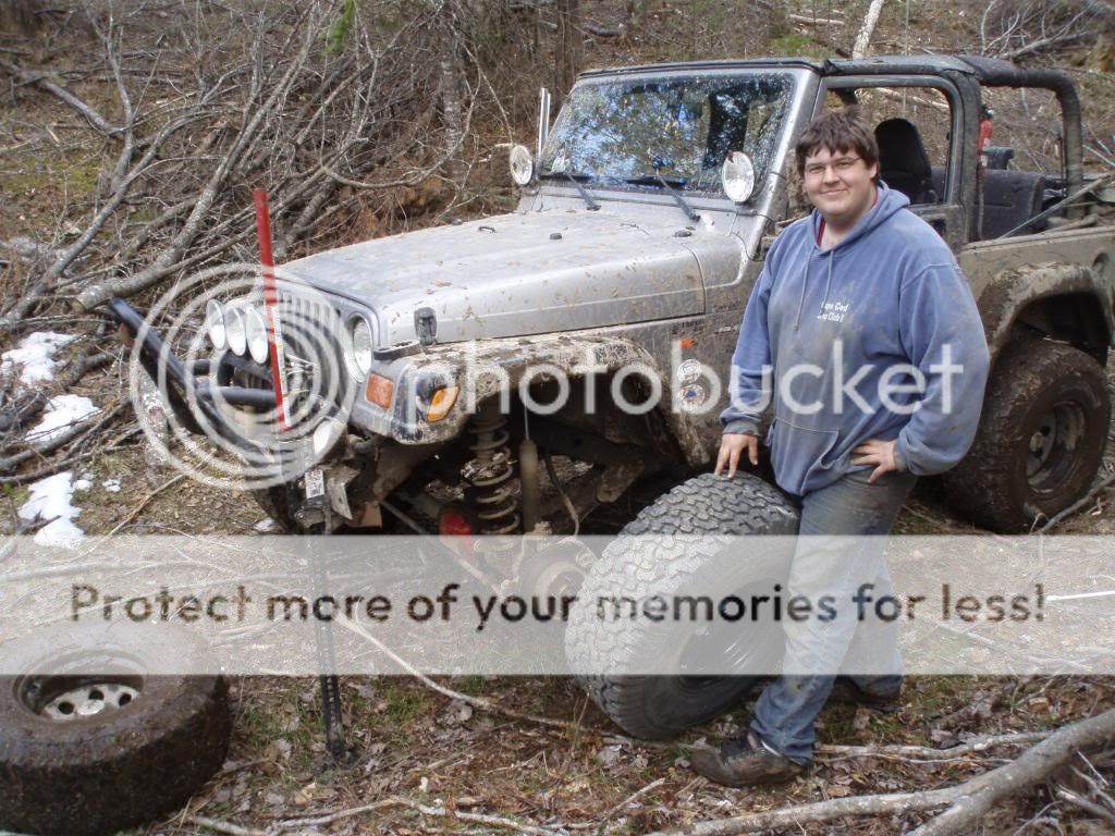

And then my buddy lost a valve stem while maneuvering to winch me.

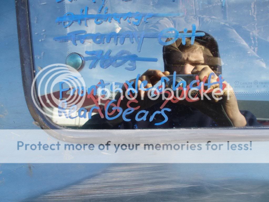

The next day we decorated my truck. And then began driving home.

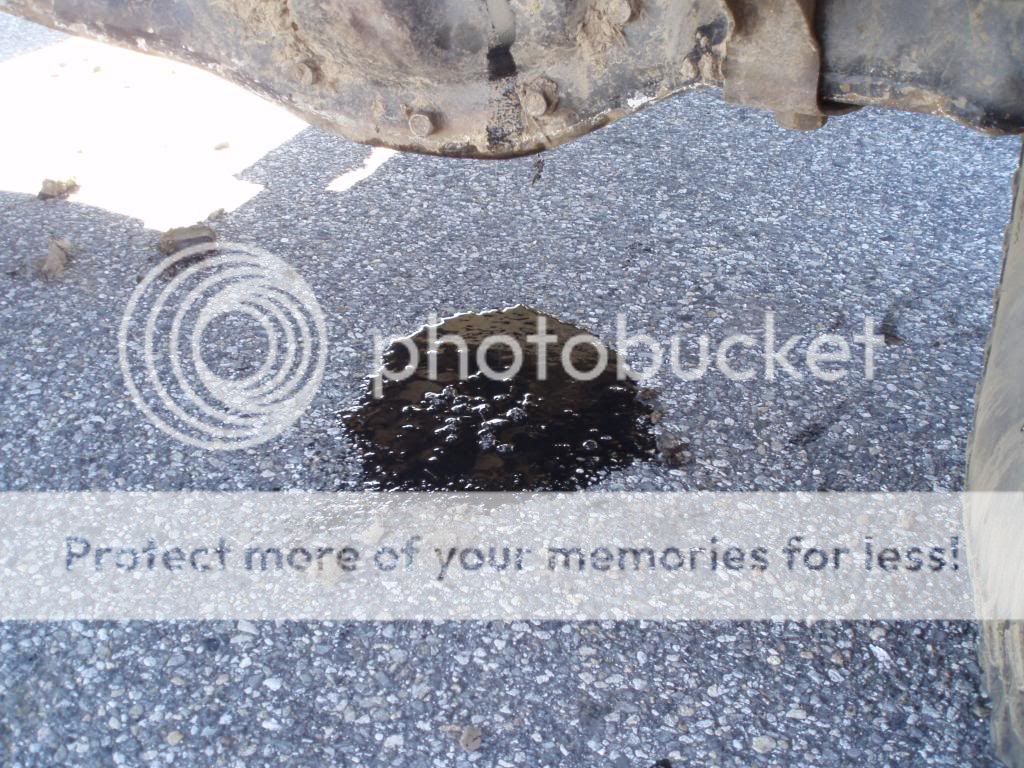

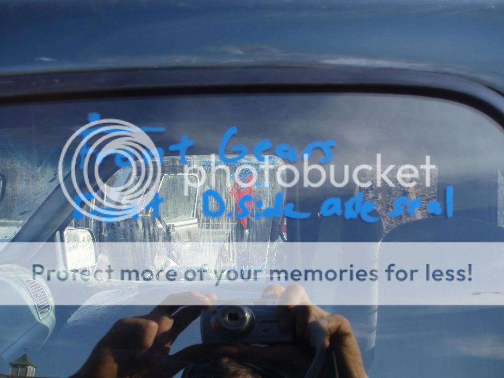

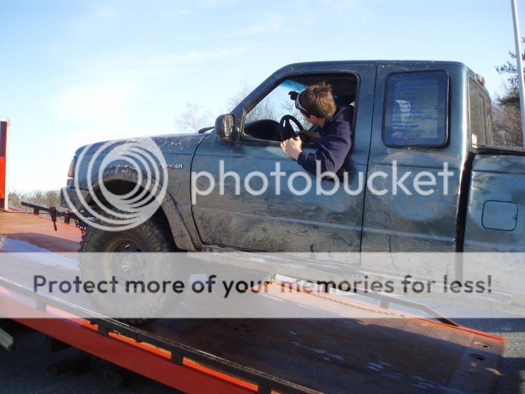

A little over half way home I started hearing funny noises coming from my 1wd front end.
That broken axle shaft decided to wipe out my axle seal.
Lifting my 97

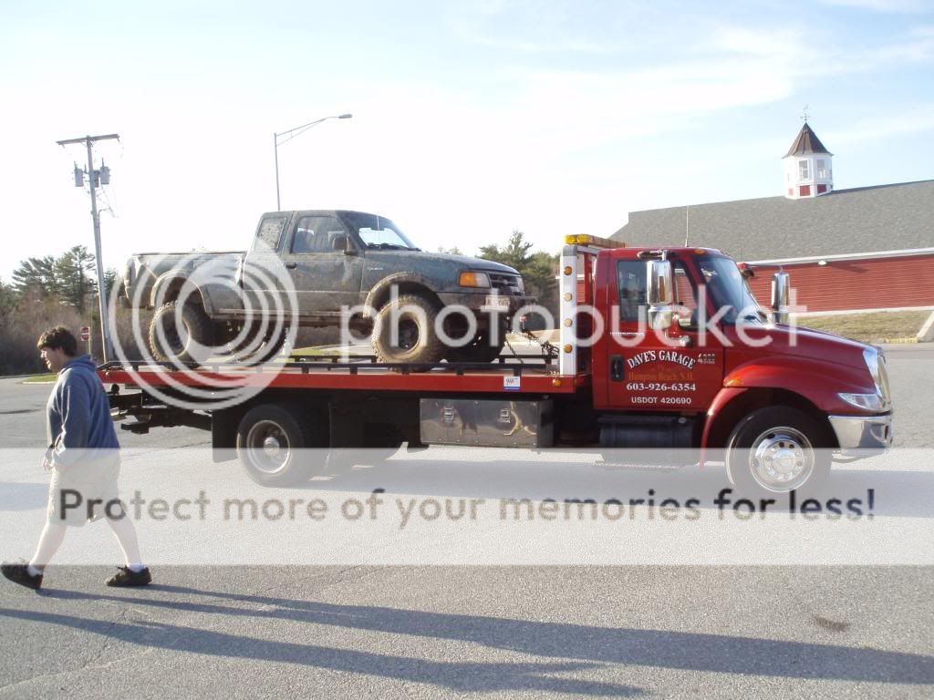

Thank god for AAA.

Good news is that the rear gears are getting replaced under warranty.
Front gears may be salvageable.
Replacement axle shafts are cheap and plentiful at the junkyard.

OK timeout - did you pull the diff cover and remove the head of the pinion? If not how did you drive with it still in there? I would think eventually the pinion would be pulled into the carrier, resulting in more carnage.
The differential would still be spinning.
When turning the drive shaft I felt no resistance so my first thought was that it sheared of clean and perpendicular to the shaft as opposed to a spiral break. It did occure to me later that the carrier might get chewed up but seeing as how I have a spare, I wasnt worried about it.
