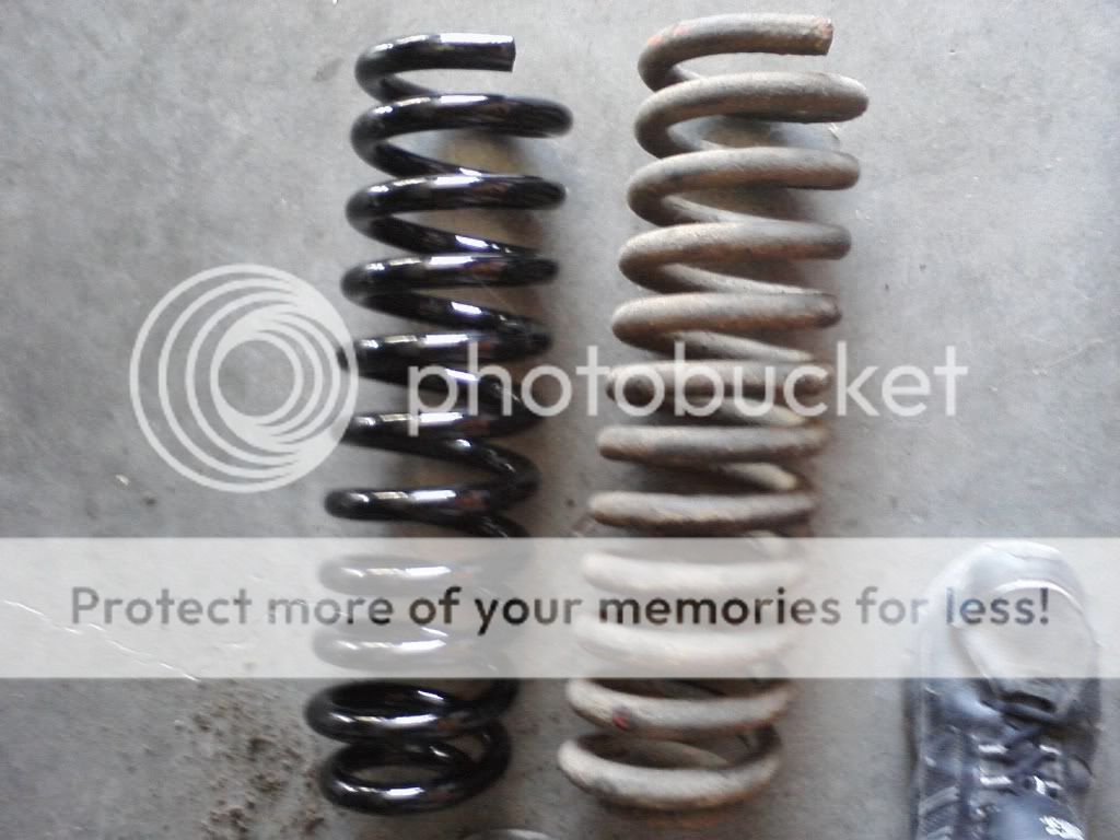

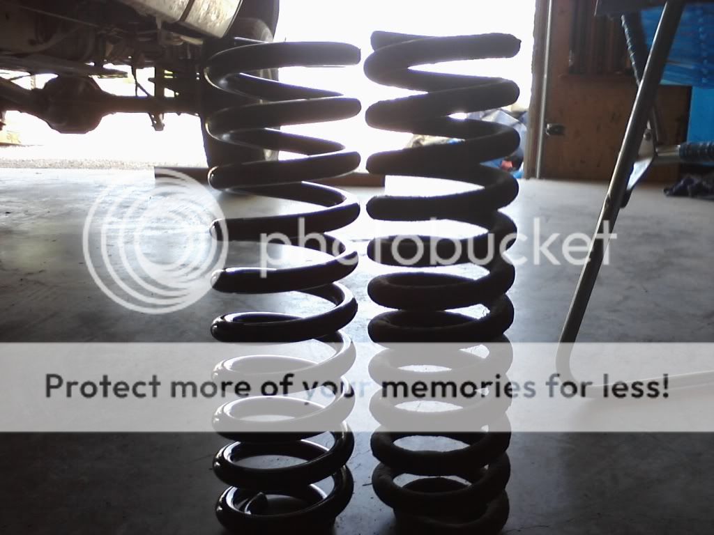

I am installing 4" skyjacker coils and shocks on my truck and I took out my old coils(sagged F-150 coils) and compared them to the new 4" skyjacker:
(new left)Almost the same height... ok whatever maybe stiffer.

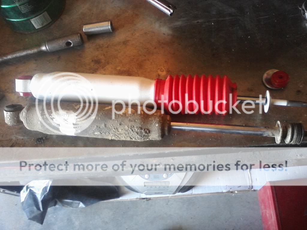

Compared the shocks:
New is shorter extended... hmmm

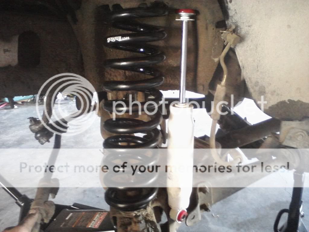

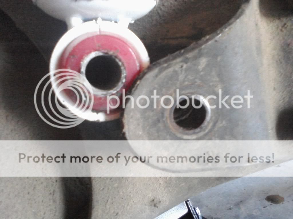

Got the springs in and went to put in the shock but once I tightened the top I saw this:
The shock is too short fully extended. It looks like it will bottom out on the shock. I could maybe understand the coil being shorter, but the shock being too short really concerns me.

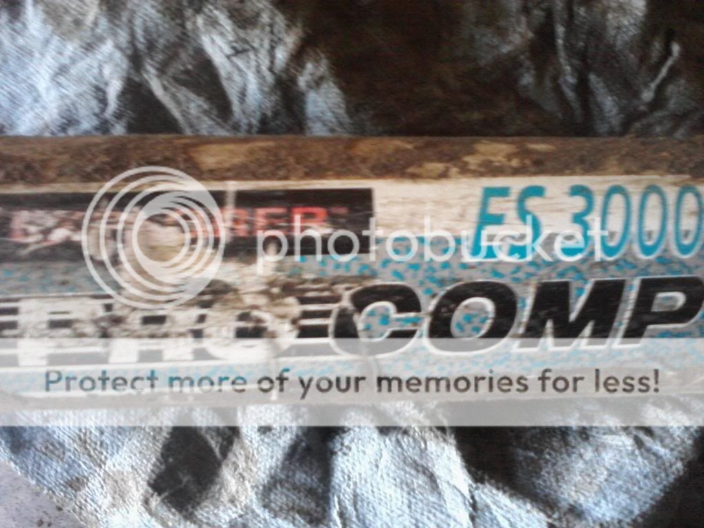

Well I decided to put in the new springs with the old shocks in since they are the correct length. Cleaned one up a bit and found this:
They are pro comps so obviously their stlye actually fits... Anyone else have this problem with skyjacker shocks?

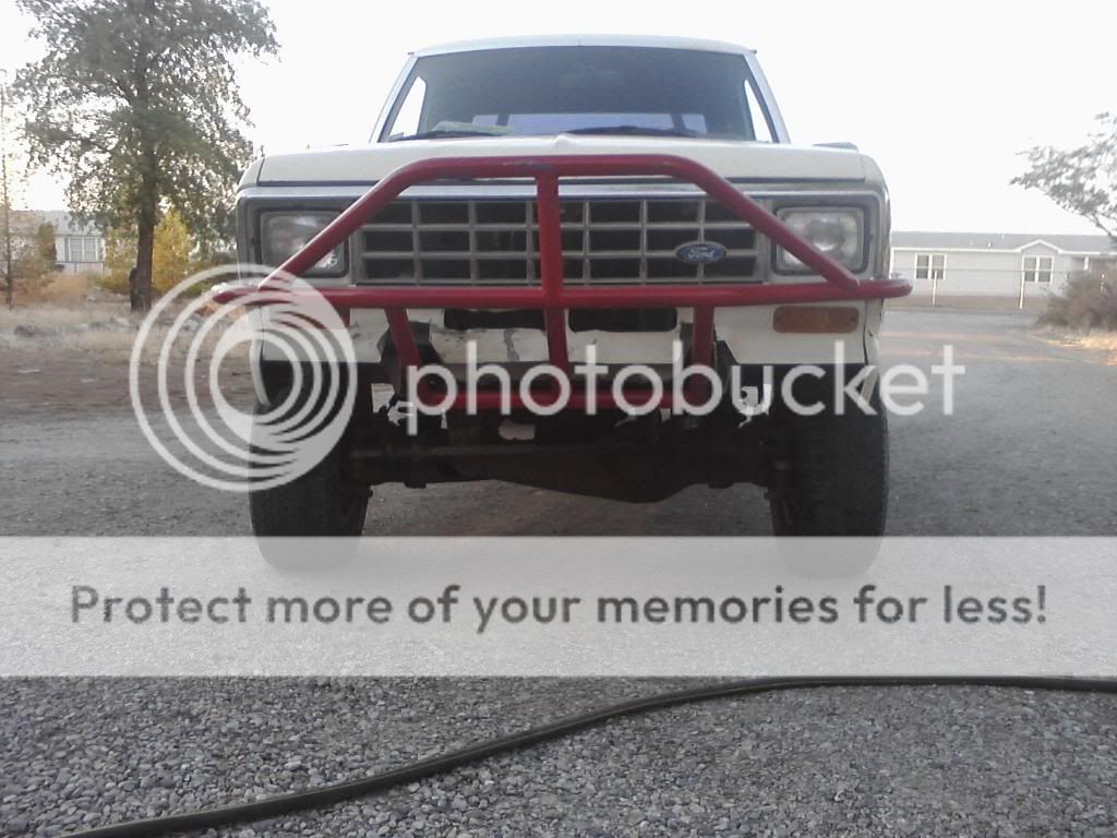

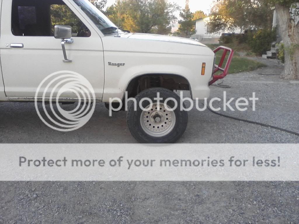

Oh and to add to my problems this is after the "4 inch" coils:
It sits LOWER than before:annoyed:

I had the same problem when I put a SJ stage 2 lift. The front I had to jack up just to bolt the bottoms in even thought they were for a 4in lift. apparently there lift droops further than their shocks allow, even though there are for that size lift. The rear ones on the other hand were entirely to long and only have about 2in of exposed shock shaft exposed. I plan to just buy different non skyjacker shocks in the future.
Wont this mess up the shocks eventually? That was why I didnt install right away.

If you have 2 or 3 inches of uptravel, you're golden. It's all about the downtravel, and with the suspension setup you have now, you wont have to worry about travel, because there wont be much.

I was just out messing with the jack and jacked up the truck to where I would want it. Ride height it was 21.5" hub to fender, after i jacked it up it was 24". I was thinking if I put about 2" in washers I could acheive this right?
Also I think I am going to keep the 4" skyjacker rear shocks. they seem to look like they will work. If not then I will send them back and get 4" f-150 ones that should work.
Anything sound wrong with these plans?
You have to remember the 1.5:1 lift height ratio of the TTB. If you add 1" of washers, it will lift it 1.5".
