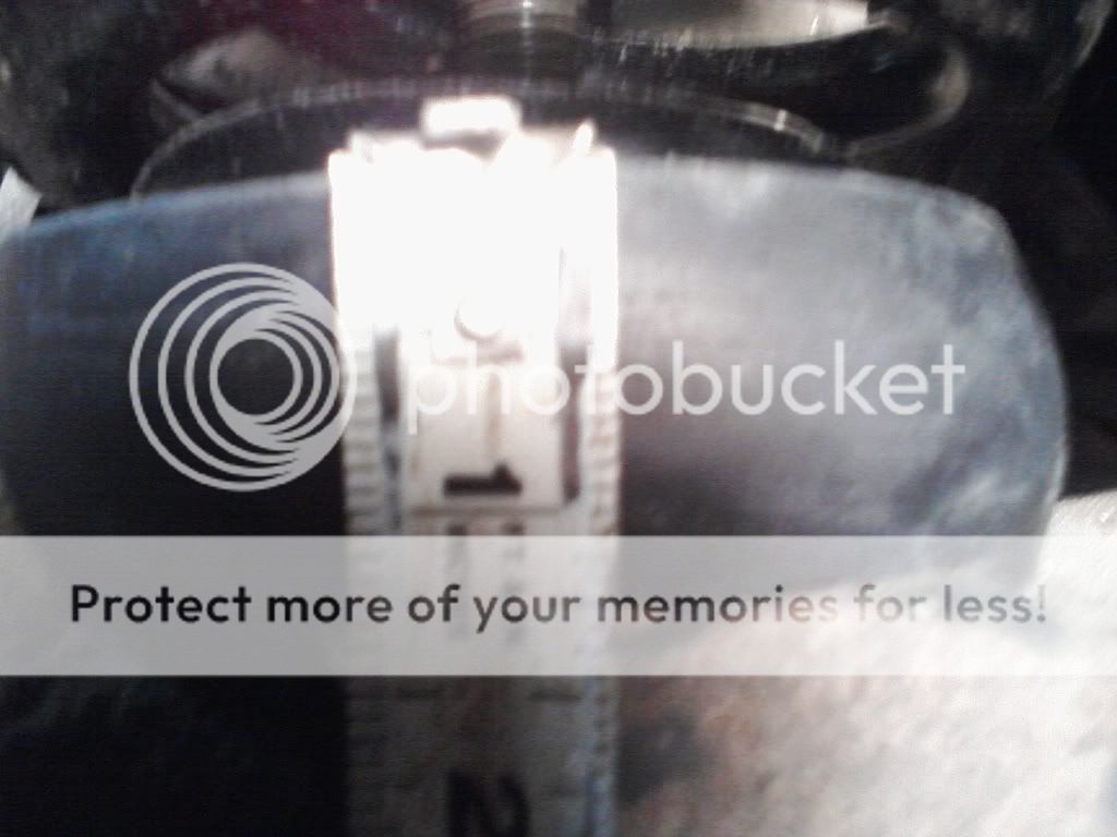

Okay bought leveling spacer off of ebay. Spacer height before install:

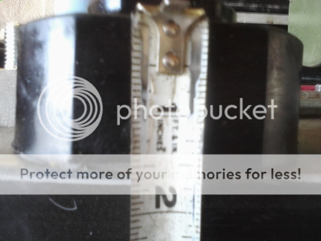

Spacer height after install and torque: (looks kinda twisted ans mashed...)
This is how the spacer is supposed to look right? I thought it was a solid spacer and stayed the same height.:dunno:
This is how much the spacers changed the height:

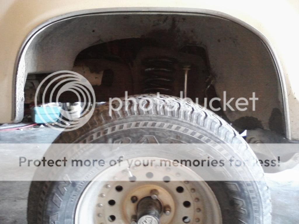

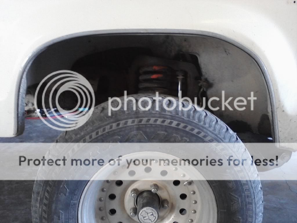

Old coils left, sj 4" coils and leveling spacers right.
Does this look like about 4"? As long as I dont have a problem with the spacers and can clear 31s im good with how it sits. What do you guys think?
