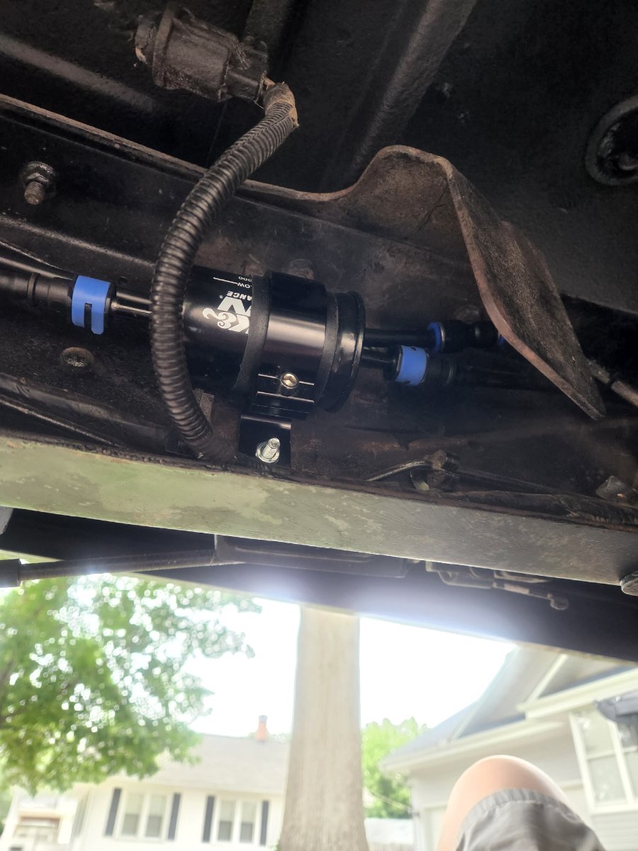

There’s two good reasons to redo the lines. The first is age. The second is that to go to a single pump in the tank, you need to at least eliminate the frame pump. Realistically you could also toss the fuel reservoir as well. Splicing stuff in creates more potential failure points on an already old system.
On my 00 and 92 Rangers I pulled the bed to deal with the fuel system. Of course, I also had other work to do that the bed off the truck made convenient, except for when the pump got replaced on the 00 (that was done prior to the lines needing replacement). My 89 Bronco II got an access hatch above the pump by me probably 15 years ago so I didn’t have to drop anything to do the lines.

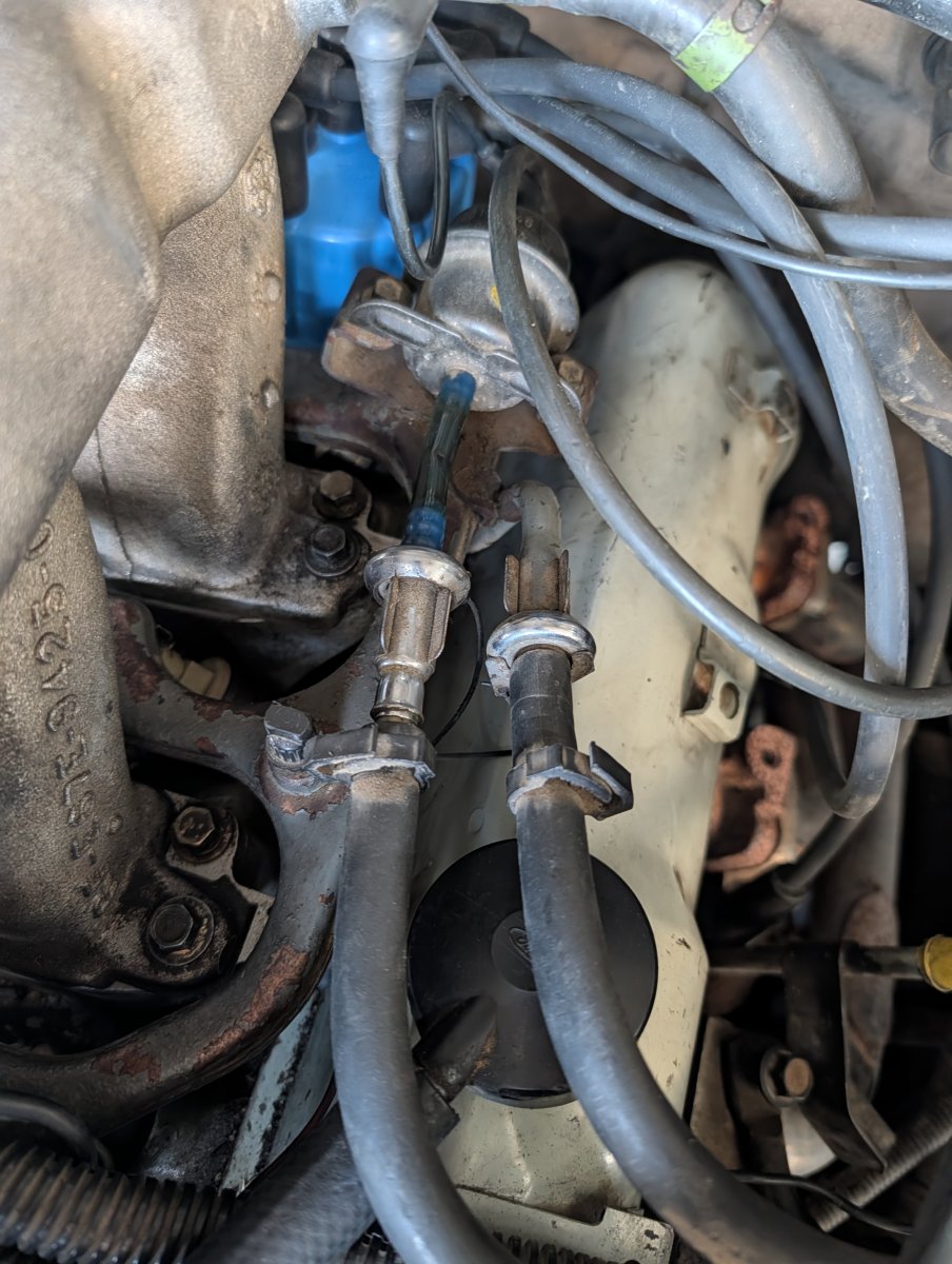

On a note about the lines, this truck has a carbon canister under the hood. Doubt it does anything anymore. Should I need to worry about that?
