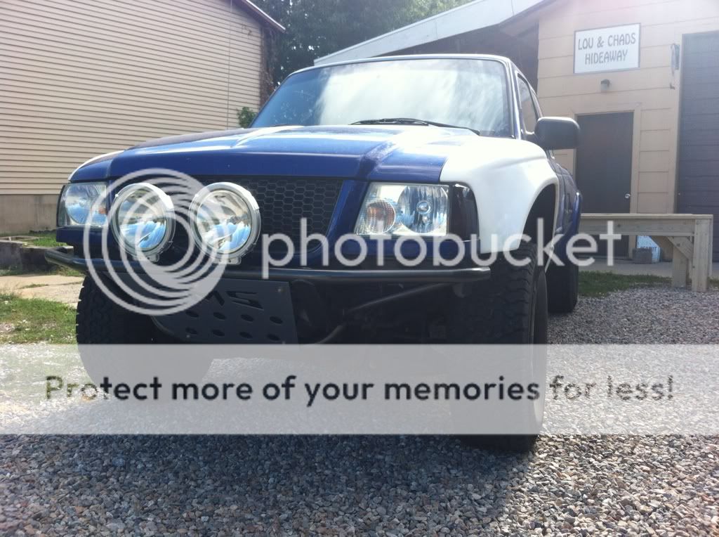

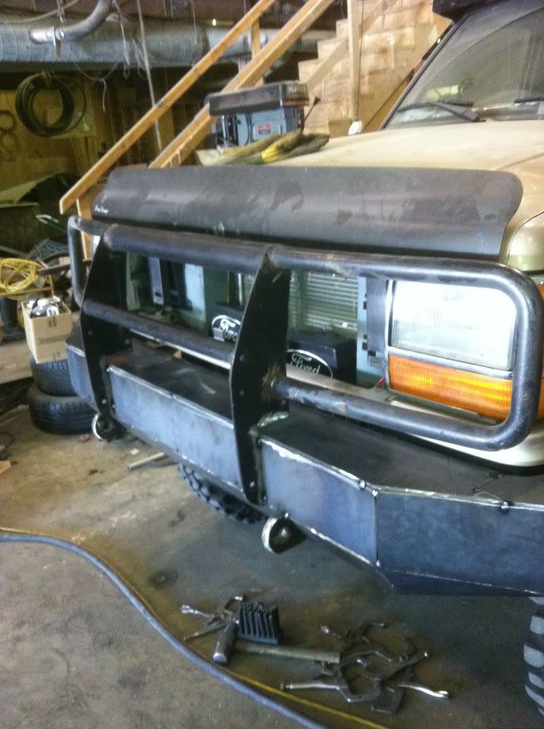

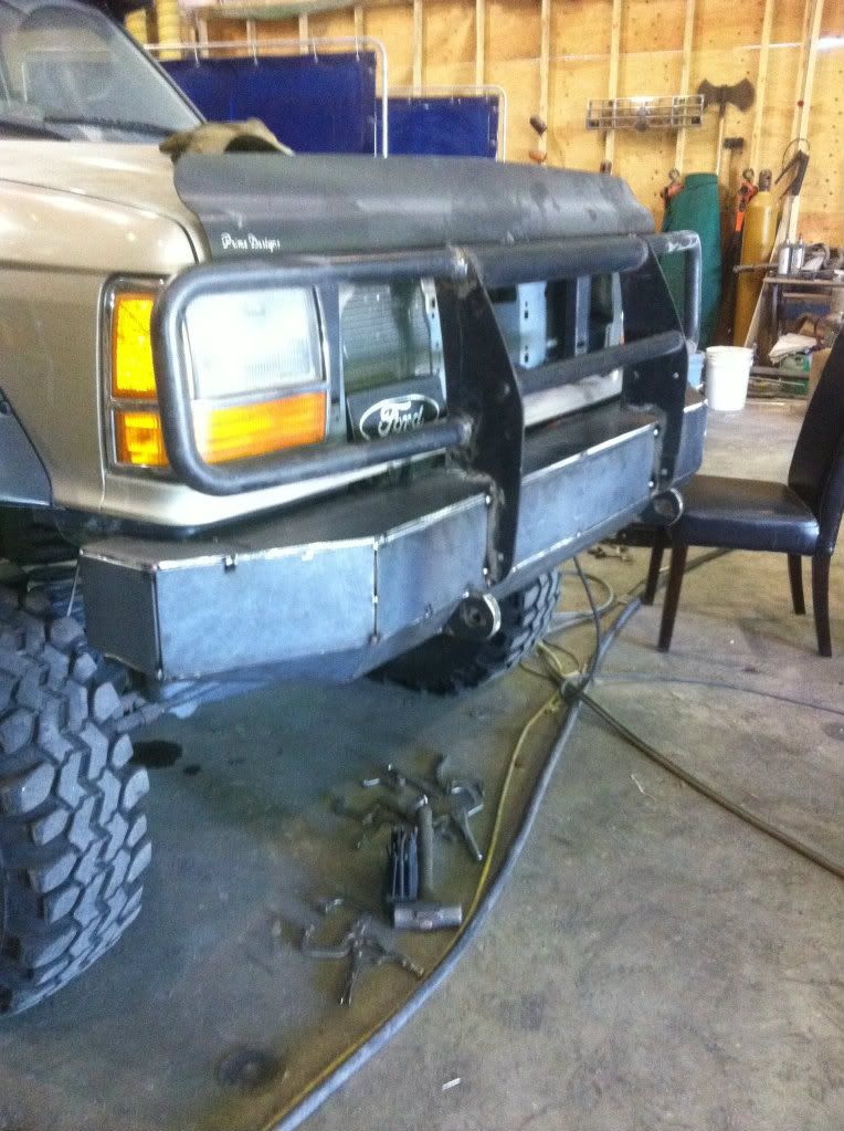

New one I'm building

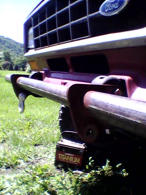

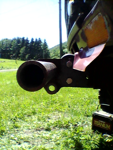

minimalist
2.75 OD X .250 wall DOM tube run thru 3/8" thick mounts with built in recovery points

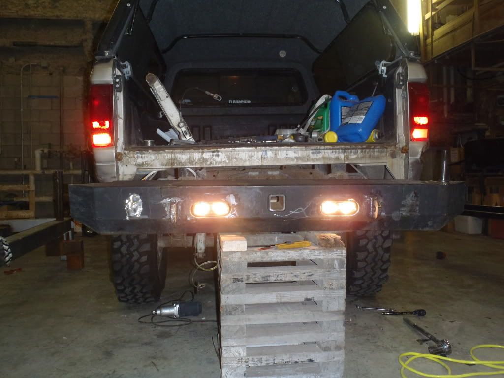

I built mine out of 1/4" thick rectangular tubing.
Sent from my SAMSUNG-SGH-I997 using Tapatalk
front is made out of 1/4" and has 3/4" frame mounted tow points laced through the bumper. there is a 1/2" plate running between the frame for a winch.

the rear has a tire carrier ( not shown ) it was not made by me but I modified it to make it stronger and added some reverse lights.

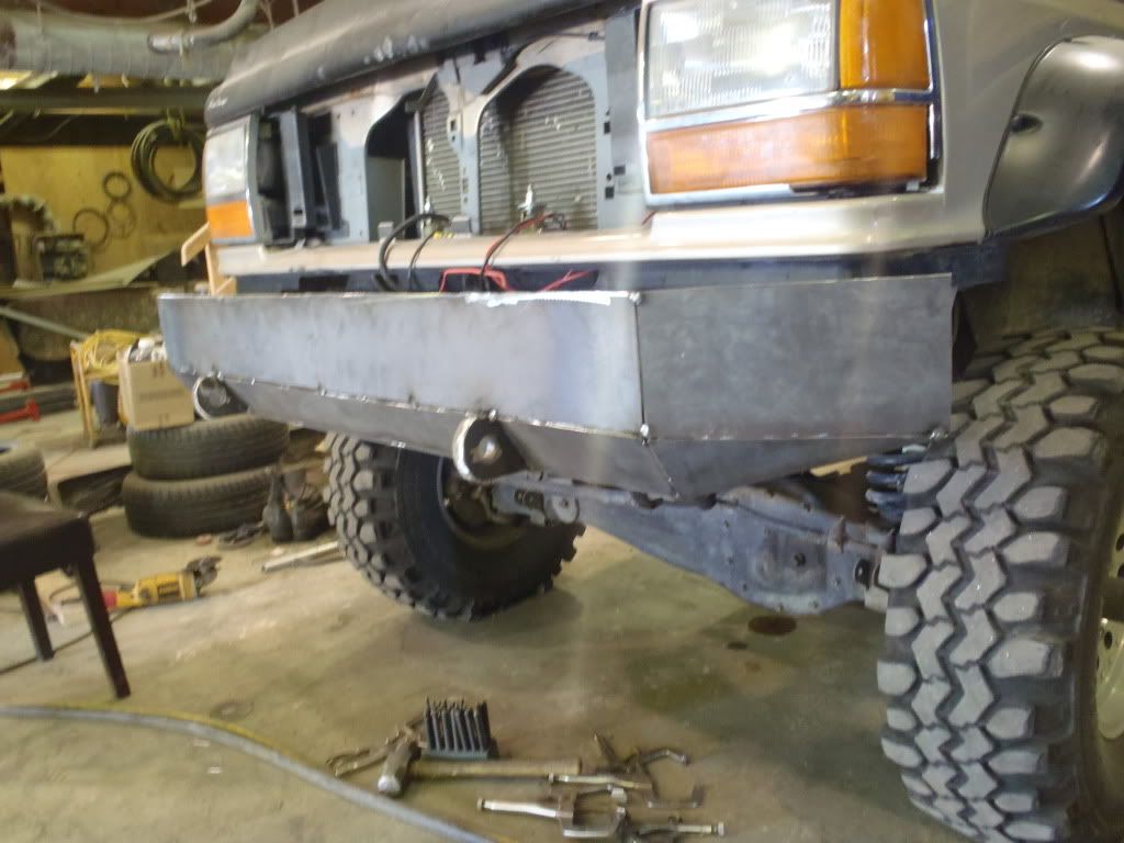

My Bumper

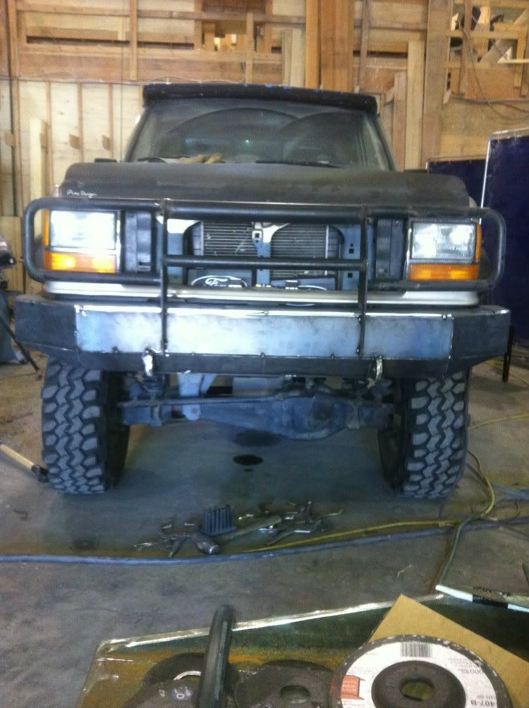

I thought I would share some of my bumper build pics. It's all pretty much 3/16"

My younger bro, myself and a buddy's welder and shop. Did it all in one night and sourced the metal from a upick metal scrap yard.
