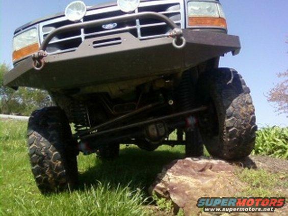

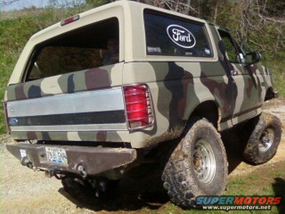

I haven't got a start on the ranger's bumpers yet but these are what is on my FSB...
back~
Lets see your bumpers
front~

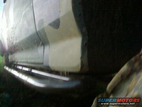

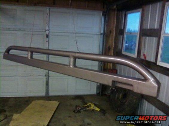

sliders~

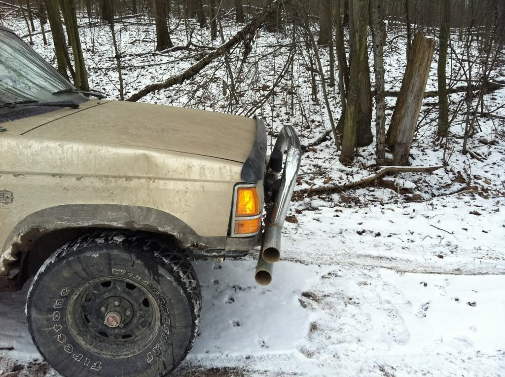

very nice... almost the design i want for my rear... and almost the same design of sliders that i have already

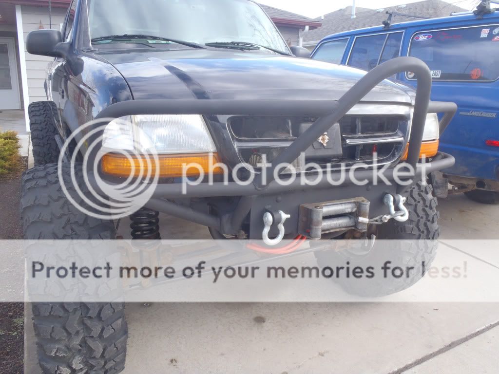

1.75in .120 wall dom tube. thats what i use because thats what fits my bender

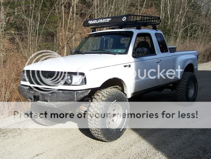

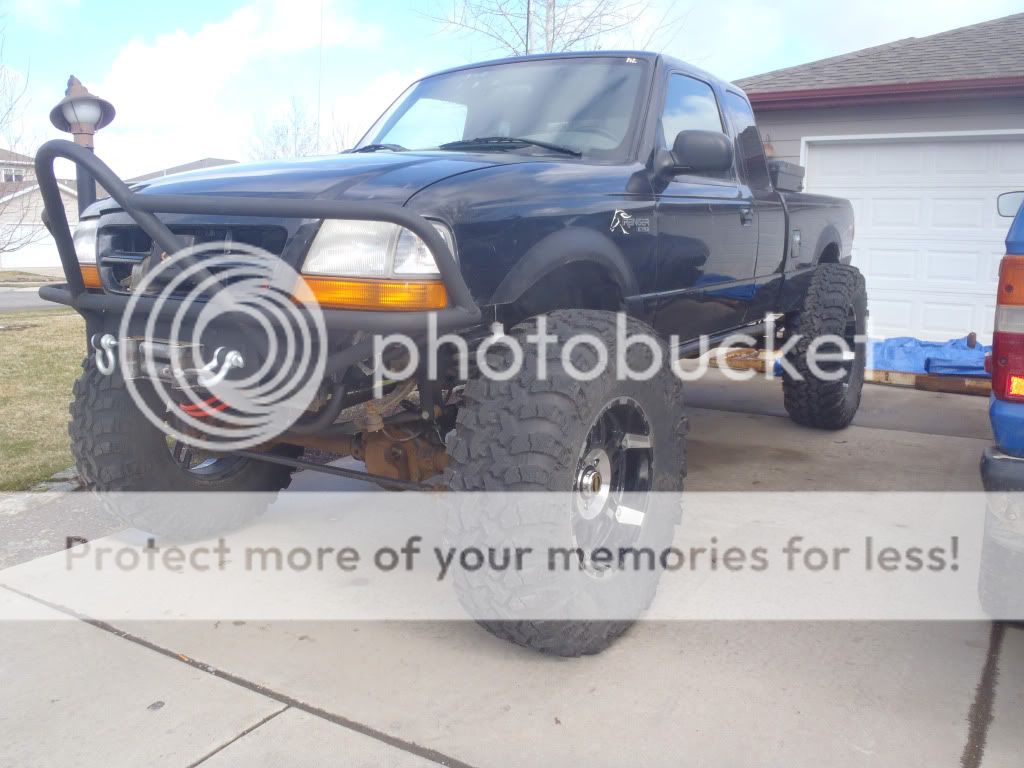

How about a Mazda B-series bumper on a Ranger??? :icon_twisted:

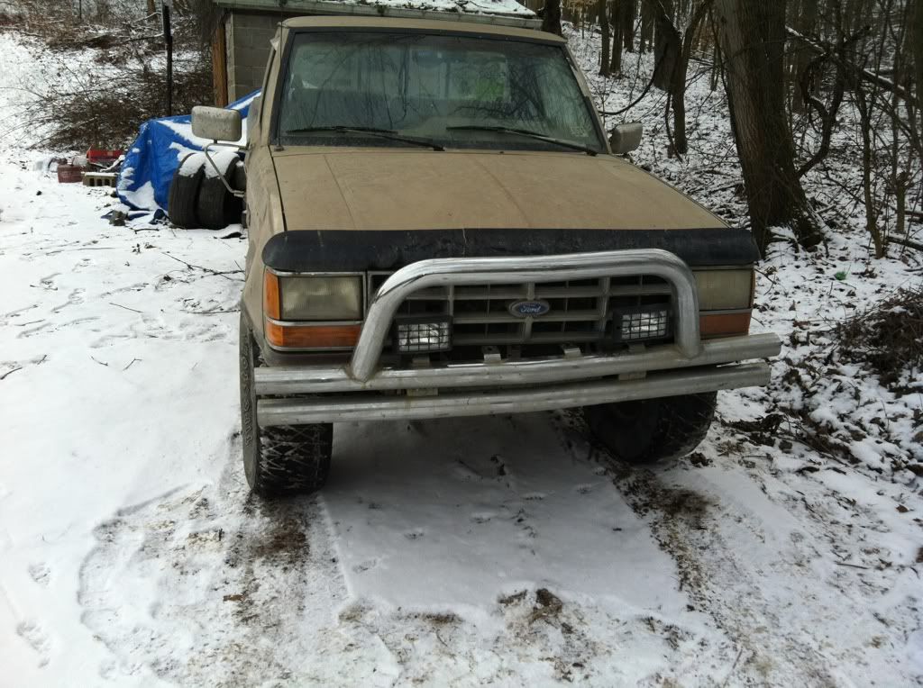

Thats badass and almost exactly what I had planned for mine. I also am going to inset my 8274 like that so it dont hang way the hell out there. Any more pics of the frame connection points if you dont mind?
Thanks!
about the pictures, i could take more but you dont want them. it is welded to the frame, which is not ideal. when the time comes to take out my engine i will have to cut the thing off.
so you should bolt yours on
and i did a terrible job trimming my grille, i have to do it over sometime...
Thanks!
Oh yea i am def going to bolt it and box the frame horns. I am remote mounting the control box and making my own grill, something way sick. But hey your bumper itself looks really good, i will be posting up my rear bumper pretty soon i will let ya know in case you are looking for ideas there, its pretty sweet.
like your front bumper
i have a 1987 ford bronco 2. i want to put a front bumer on mine like yours . can u please give me measurements on yours so i can have one made up foe mine . . . . . . thank u. . . . .

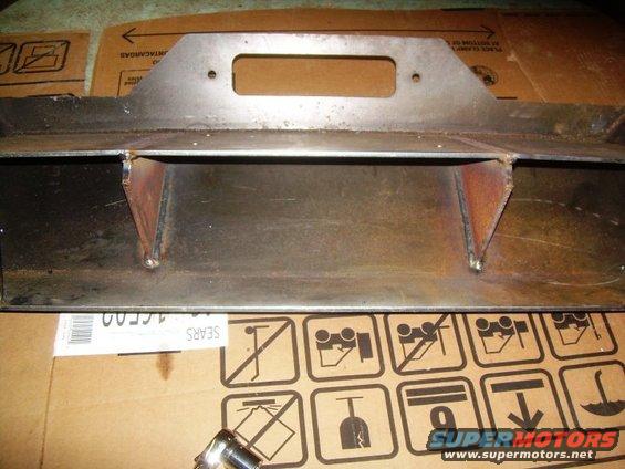

Front bumper off a 70's Chevy truck cut down sides still need to be cut and weld on and the frame pulled alittle so it sits level

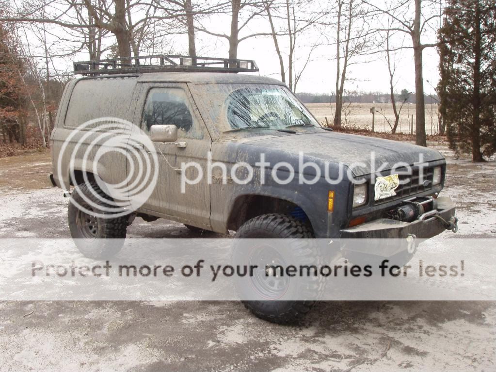

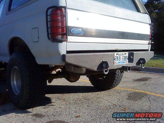

It's simple, but I like it...It's 3/16" thick steel.
