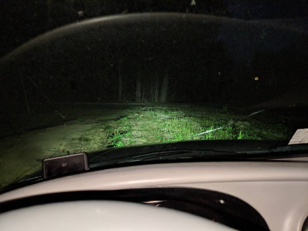

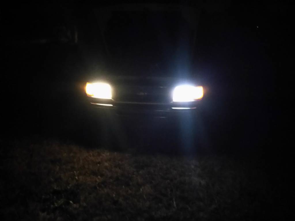

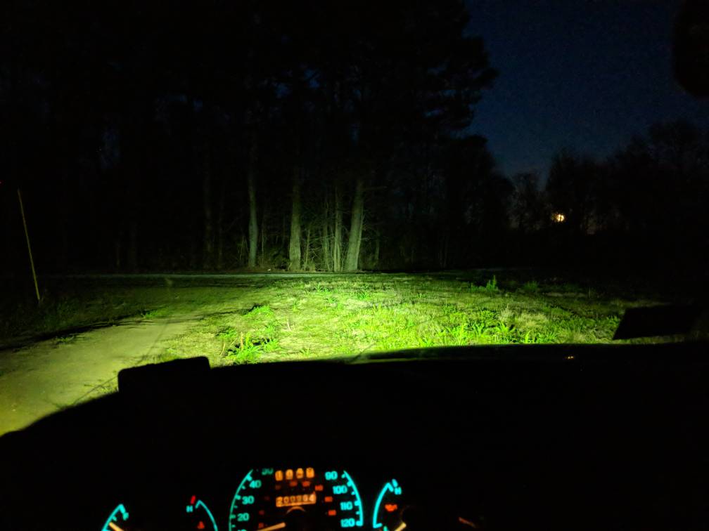

I've got them in my 97... eBay specials and they work pretty good with the hazed up lenses.
Sent from my Pixel 2 XL using Tapatalk
Only downside I found is they interfere with my radio signal when they're on

I've yet to see any aftermarket LED offerings that are the correct light color (they all are a bluish 5000-6500°K, which 'looks' very bright up close, but has an inferior ability to penetrate deep into darkness).
I would suggest doing the 2000-grit wet-sand & polish procedure on your lenses if they are hazed up, and if that's not enough, add a set of halogen auxiliary driving lights.
An HID projector conversion is another option I've seen where you can get properly-colored bulbs (4000-4200°K), though HID can be 10× worse than LEDs when it comes to radio interference (especially if you have 2-way radios). Don't just stick HID bulbs in your stock housings though, you need to use actual projector lenses to not piss off everyone oncoming.
