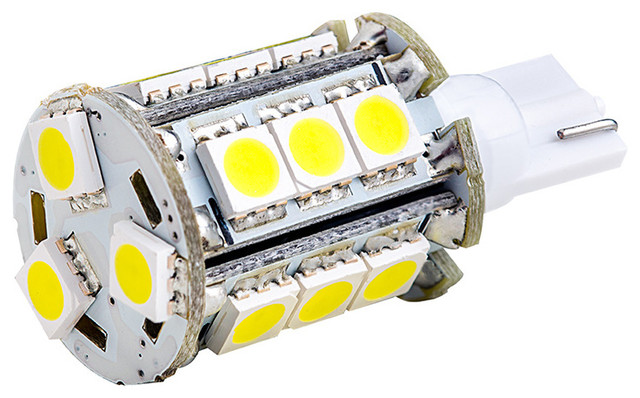

Just be aware of what type of 194's you get, 20 SMD are tight.
OK, thanks guys. Haywire, theres more than one type of 194 LED?

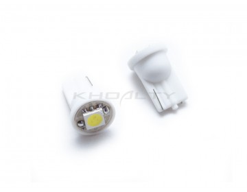

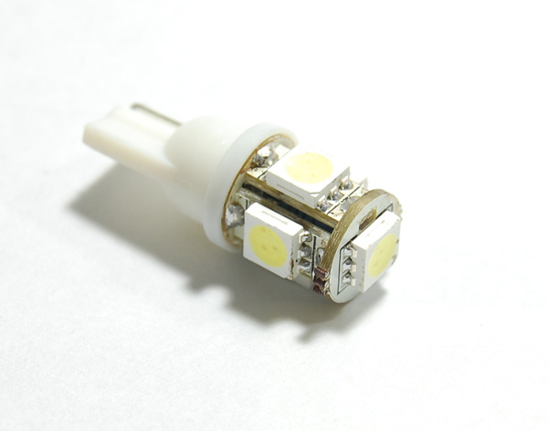

Yes. "194" refers to the general shape and size of the "bulb", mainly the wedge base. You can get 194 style LED replacements in various configurations, such as these pictured below. Not all will physically fit in your instrument cluster locations. Also, LED's use less current than incandescent bulbs, so they may cause some circuits to act strange. I used 5 SMD LED's (like the top picture) in the cluster in my '93 and took a couple of them back out because they stayed on all the time. I'll check my thread later to see which ones. Also, LED's have a polarity. they only allow current flow in one direction. So, They must be installed in the right direction.
