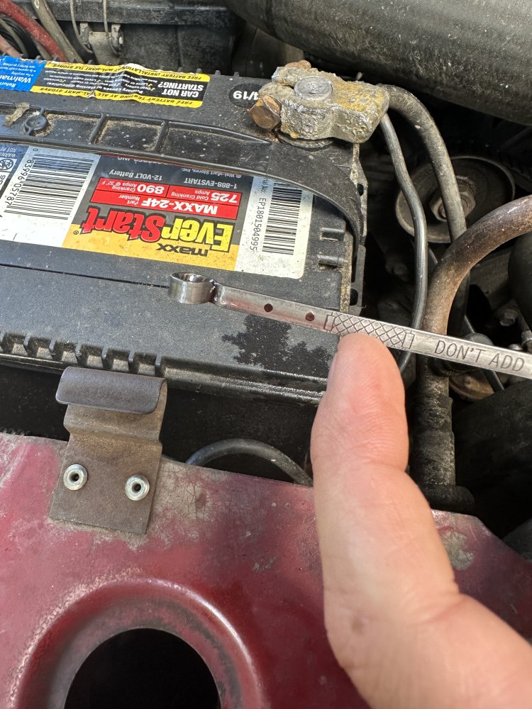

I started the truck and filled tranny fluid up. Took for a drive and ran through the gears a little. When I checked the fluid it was dead nuts in the crosshatch area.
Unless someone here thinks otherwise, Im going with.. I got really lucky.. that’s my story and im stickin’ to it!
