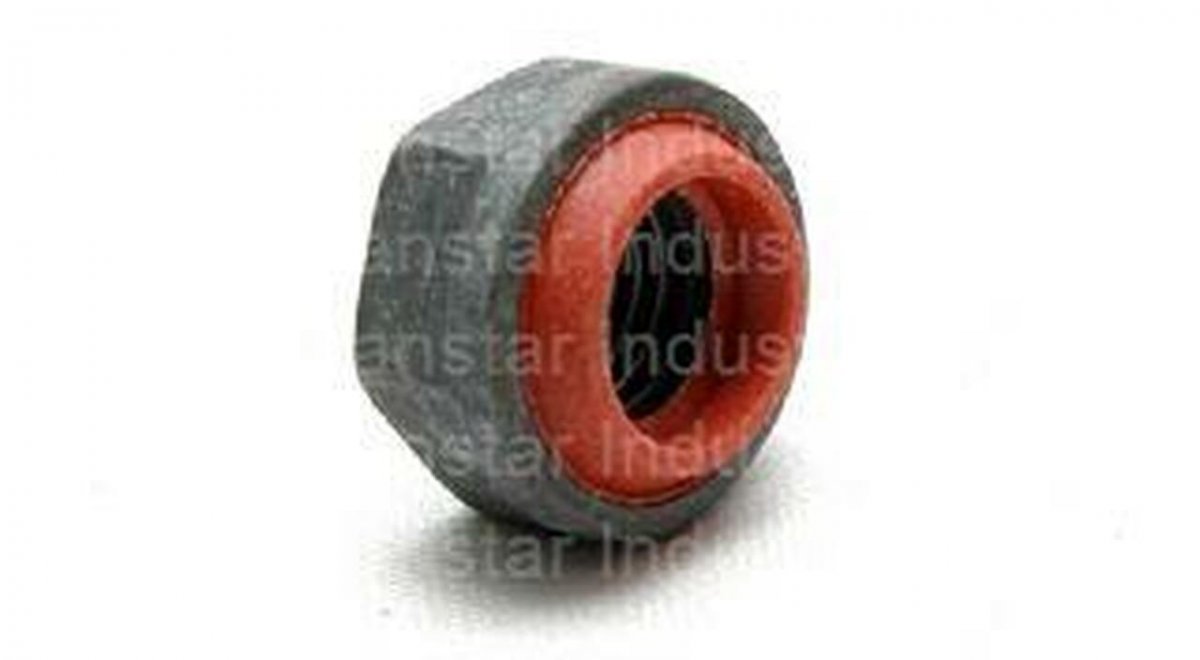

That leak definitely needs to be addressed. Transmission fluid will spread out more than engine oil so spot will appear larger with smaller amount of fluid. My opinion only is I wouldn’t recommend any type of additive and as far as RTV sealants not in applications that don’t require it. Your results may vary. Take close look at the band nut again. After looking at pictures again I would suspect the band nut just because of the clean area on the case where fluid has run down.

The band nuts have a rubber seal to stop fluid from leaking between case and also seal threads.

these nuts are on order (y)
Im guessing the trick is keeping the band adjuster still while the nut is backed out. same for when new nut is installed.
