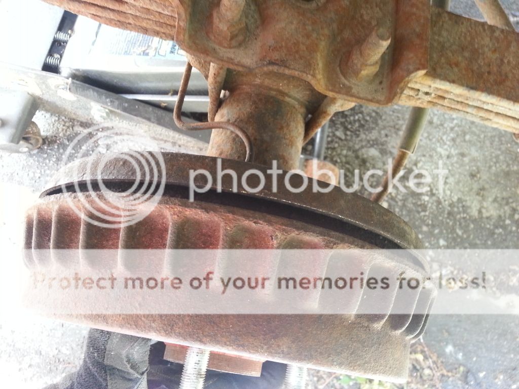

OK, I got to work on these again. I've been very busy and driving my moms van. I took the drum off the passenger side and poke around at them. To the best of my mechanical knowledge everything seems ok. (Sorry for the crappy pics, no idea why they turned out that way.)

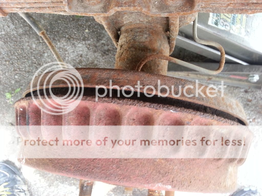

Here is a pic I took after messing with it.

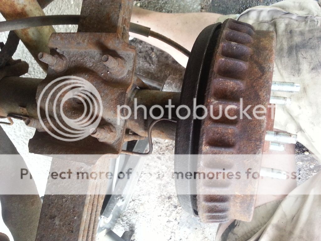

Getting frustrated I took the other side off to see what was up, well the other side looks exactly the same
So is it safe to assume that's just the way they are?

Well...no...
It almost looks like you have a 9" drum on a 10" brake setup...judging by the way the drum outer edge seems to line up with the backing plate inner edge...
The drum should actually go over the backing plate edge...at least that's the way mine are and always have been on any vehicle I've ever owned with drum brakes...even my Zuki Sidekick was like that...
A gap like that allows all kinds of stuff to enter into the brake area...I think you have 10" rear brakes...or the simply the wrong drums.
