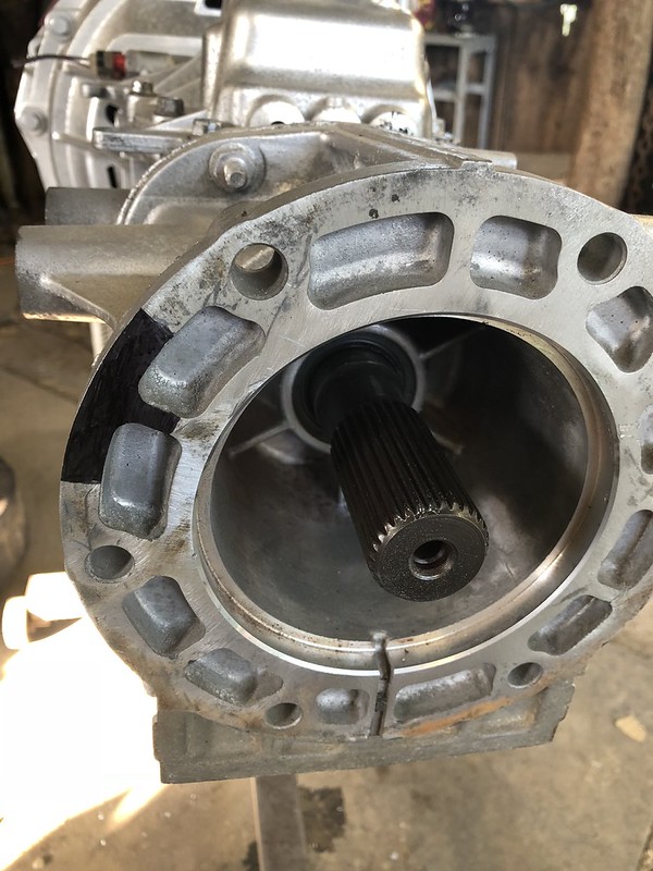

I'm chasing a leak on my 2010 Ford Ranger and am hoping someone who's been through this can help me identify the correct seals before I pull the transfer case.
The leak appears to be coming from the area between the transmission and transfer case. The underside of the transfer case is wet, but I haven't definitively proven whether the source is out of the manual transmission, out of the transfer case, the seal between the housings, the shift rail plugs on top of the transmission??

I've never looked up those part numbers. So I can't help there. From what I've read over the years, the shift rail plugs are a common leak point.
I would recommend that you clean everything up real good with degreaser or brake cleaner. Then watch to see where the leak reappears from.

Extension housing is dry. The paper gasket between it and the tcase isn't part of your leak. The rubber shift rail plugs have a reputation for leaking regularly.
And they would be leaking from the top of the transmission.
I've never been around a R1 but my M5ODR2 (slightly scaled up version used in the F-150) actually has a drain channel. If the seals between the trans and t-case are bad it would be leaking from there, not the top of the transmission.

The Ranger version has a drain channel similar to that as well and would definitely be leaking from that area if it was the issue.
