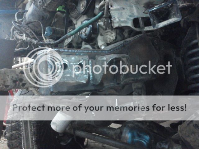

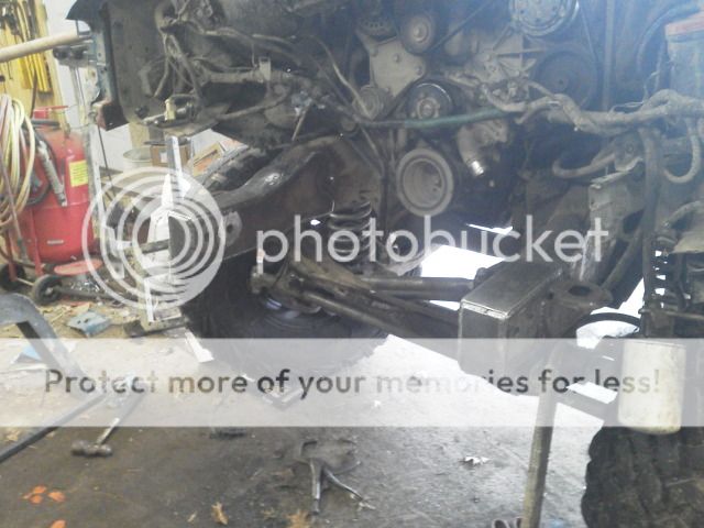

1/4" plate back to the steering box. Remember to not make any vertical welds to the frame. It will fatigue and eventually crack.
-PlumCrazy
10-4, very nice work. Did you chop the horns off and rebuild? Or just cap the frame horns and reweld the rad/body mounts?
I just cut the bumper mounts off, and the body mounts off, then plated it. I was careful removing the mounts so I could weld them back on.
