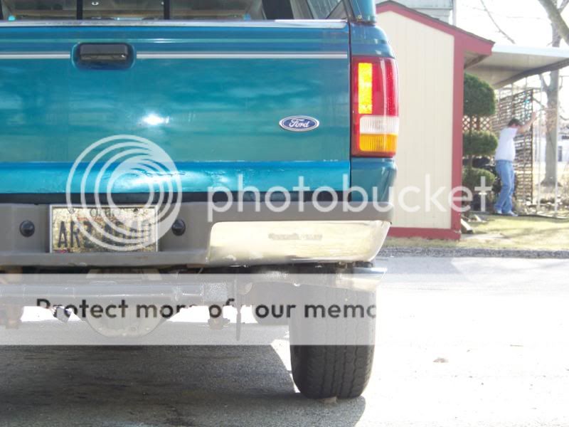

still waiting on my package from ups to arrive, in the meantime i did something about my rust-holes in the tailgate & bumper. im no body-man, but at least its better than it was before.

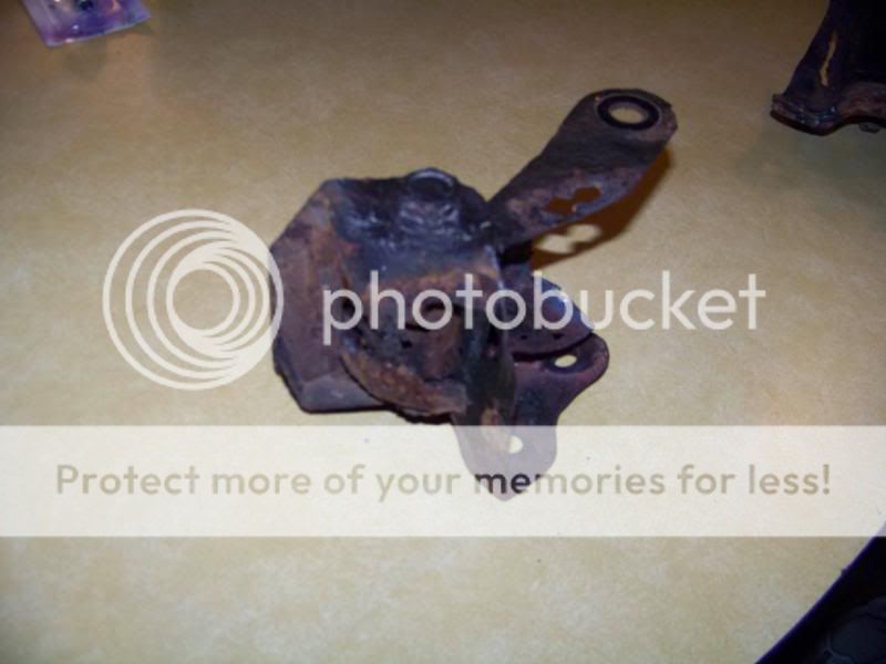

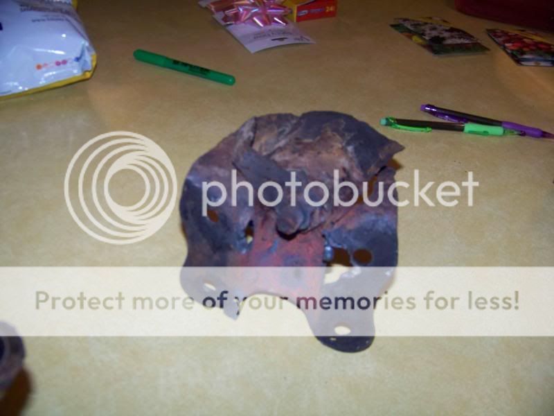

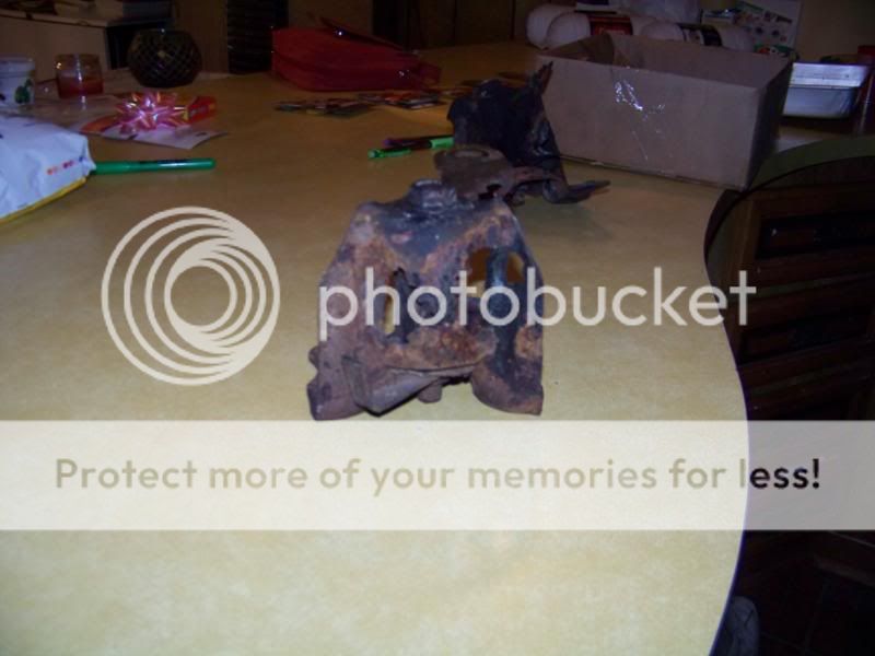

all the pictures of the ones above were no where near as bad as mine. but i did mine with the bed on and used a torch to get the tops cherry red then too an air chisel to the heads. it took maybe an hour to do at the most
