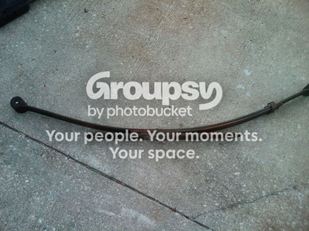

Here's the old leaf.
Can anybody guess why I was replacing it?
