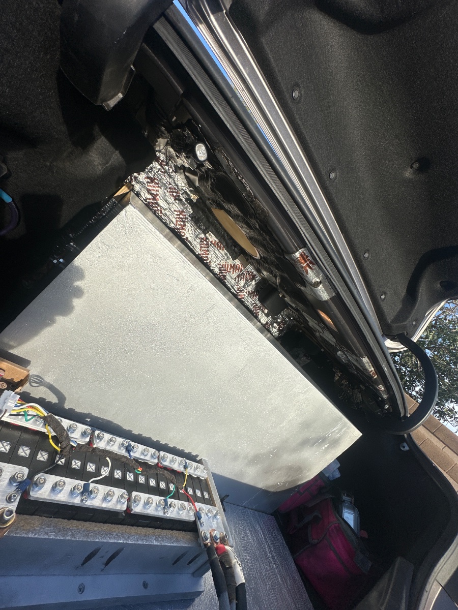

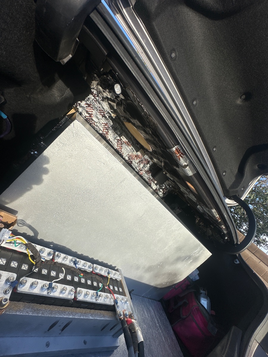

I run lithium for my personal ride, since its car audio set up, high amperage draw by the millisecond. It all depends on your charging voltage, alternator output amperage, etc.
i bumped my voltage to 15.3v since i run SCIB LTO.
If your running a stock voltage 13.5-14.7v then lifepo4 would be more suited for you. Typically we use a balancer opposed to a BMS due to the current draw. It really depends on your application.
If your RV doesnt pull a whole lot of amperage you could get away with a BMS and it should be the safer option incase a undercharge or overcharge condition may happen for whatever reason.
I would like to also add, as other stated, DO NOT RUN LITHIUM UNDER THE HOOD.
If cold climates is a problem you can add a battery warmer which turns on based on certain temp threshold.
