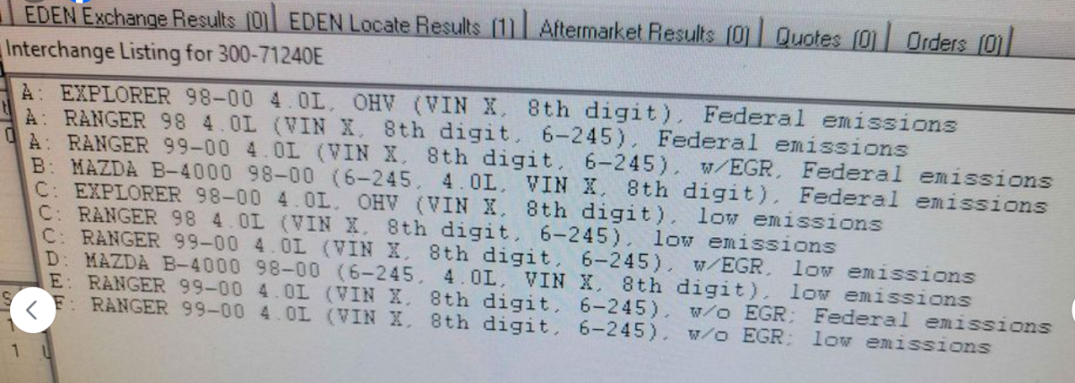

During my attempts to source an engine a guy displayed this interchange list for the engine he is selling (ENGINE 1999 2000 Ford Ranger 4.0L Vin X, 8th Digit W/O Egr Federal Emissions)

Of note is that flywheel/flexplate flange on the crankshaft changed from 6 bolt to 8 bolt in 1997. You'll either need to get an engine that matches yours to swap the flexplate over, or buy a new flexplate that matches the engine.
