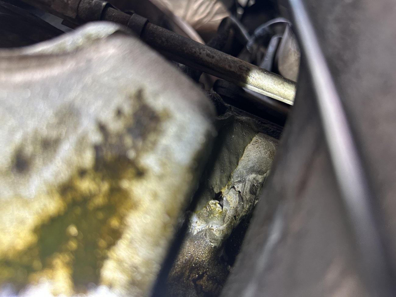

Hey all, I have a 2010 2.3 with an absolutely beat-to-hell oil pan. The Haynes manual says that my year's pan can be removed by just jacking up one side of the engine, but gives no more info on the procedure and I can't find anything online for the newer 2.3s. Does anyone have experience with this? All the shops I've contacted have given me the F-U price of 2-4k, which is more than I paid for the truck.
Here's a pic so we can cringe together at the repair job.
Later-model oil pan replacement?
Did you read the whole thing? Besides raising one side of the engine with a special hoist bracket, they want you to loosen the transmission bolts from the engine and slide the transmssion back 1/4 inch or so also.
Is it leaking? Some people are good with jb weld.
I don't see that info in the section, thanks for providing it. Maybe it was added in a newer version? Mine's copyrighted 2013. Just says to raise left side, remove dipstick tube, and loosen trans if needed.
It's definitely leaking, mostly from the weld but possibly from the gasket too. Hard to tell, but while I was wiggling the engine to remove the water pump the leak rate temporarily doubled. Which I would think indicates gasket (or even something more sinister).

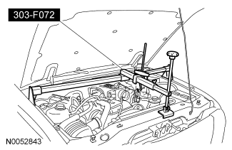

  1. Install the 3-Bar Engine Support Kit and raise the LH side of the engine approximately 25 mm (1 in).

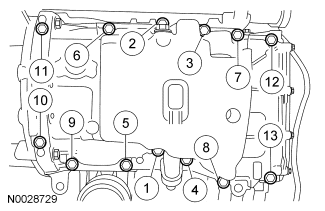

  1. Tighten the 13 oil pan bolts in the sequence shown.
    • Tighten to 25 Nm (18 lb-ft).
