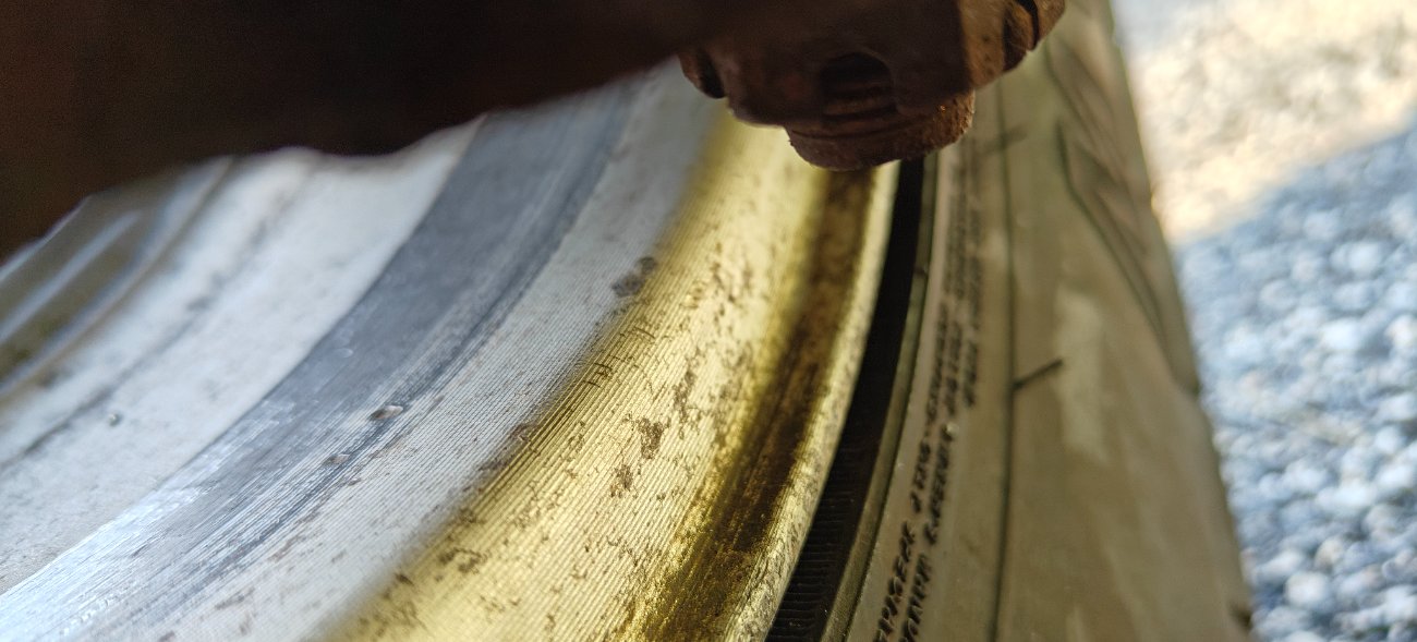

Did Ford use a larger front brake setup in the last few years of production?
There are lots of write ups on using Jeep YJ/TJ/XJ/MJ/ZK wheels.
They all say the 15" fit but you will need to run 2" spacers to make up for the totally different backspacing.
I swapped on a set of 15x8 "Gamblers" today, using Titan Wheel Products 2" spacers.
I have seen Rangers wearing these particular wheels in this forum, in Reddit forums and FB groups so I know they aren't an oddball.
I've got a weird little rub.
The front brake caliper mounting bracket is just kissing the inside of the wheel. I can hear it scraping/squealing when driving forward, oddly not in reverse tho.
I can barely feel a difference between the grooves in the aluminum from manufacturing and where it's rubbing. I've driven about 2 miles.
It's hard AF to get a picture so this is the best I've got.
Larger Front Brakes On 2011?
Whaddya think? Send it and let them "self clearance"?

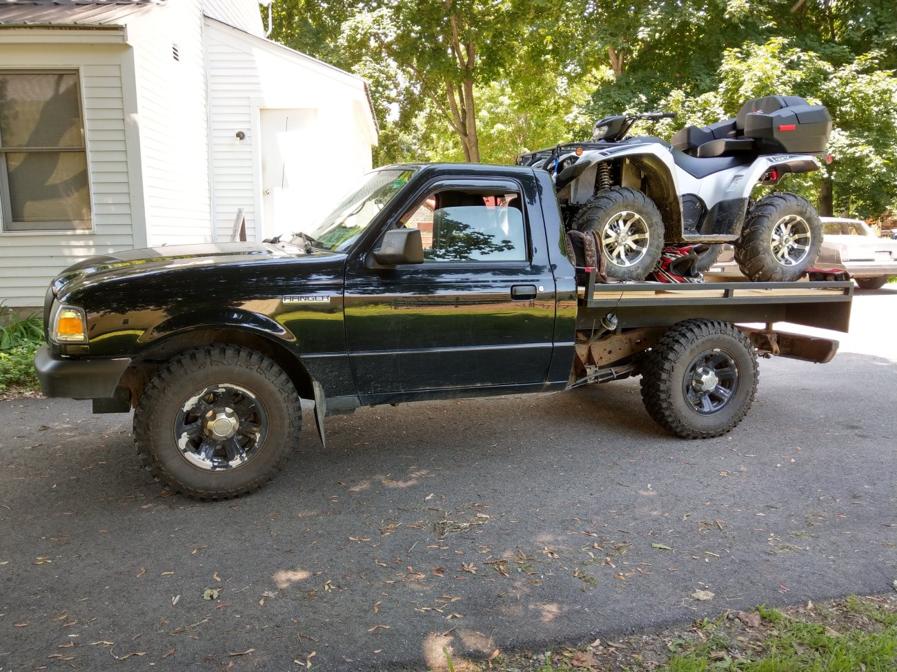

I ran jeep wheels on my 2010 for a couple years and didn't need spacers at all.. forget what model/year jeep they were off of though.. mabey I can find a picture..

I wouldn't.
Clearance the bracket.
I wouldn't.
I second that. The bracket has more material to lose than the wheel. You're heat cycling that rim in ways it wasn't designed to withstand while slowly compromising its overall integrity.
about 2004 the front rotors on 4wd went from 11.25 to 12"
there are some 15" wheels that fit, they have an enlarged rear opening to clear the bigger brakes.
other wise spacers are needed.
you do not want aluminum rubbing on anything, and since wheels & bearings flex while driving you'll need at least 1/8'.
EDIT, well maybe 1/8 inch instead of 1/8 ft
damn hash marks
The heat generated/cycling is what had me concerned.
It's rubbed enough now where when I pull the wheel back off it should have revealed where it's making contact and I can just hit it with an angle grinder and take a couple tenths off.
I knew I needed the spacers to make up for the backspacing differences to clear the brakes.
Didn't know about the larger diameter...
The "point of contact" will have revealed itself so I'll know where to start.
I'm sure I can take at least 0.125 off each end if it's contacting in two places
I know I'm over thinking this, but I wonder if it's also partially an alignment issue amplified by the 2" spacers and different wheel geometry?
AND the slightly larger brake package.
It has some noticable negative camber (top of tire leaning in).
I suppose it can't hurt to find a shop to align it on Friday...
