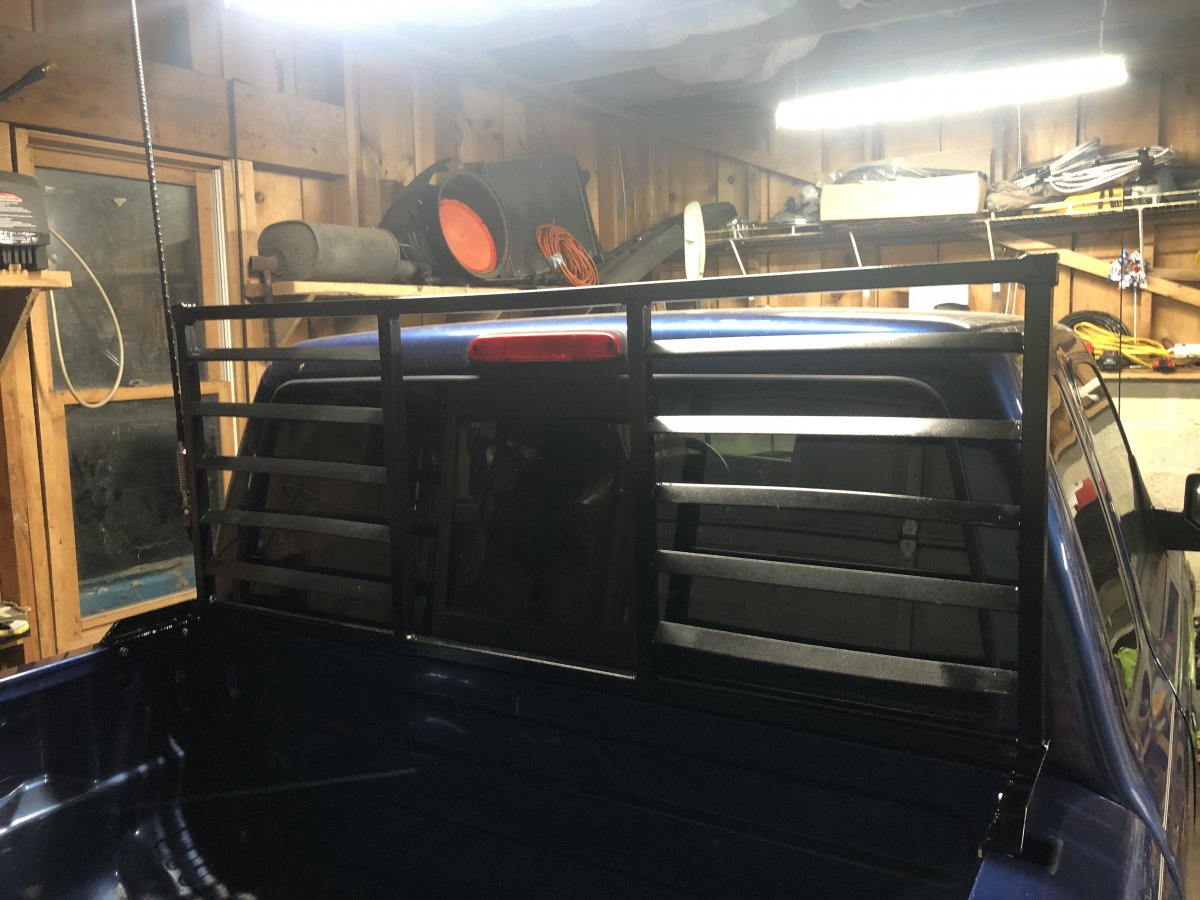

I was gonna post something similar. My F-150 needs a rack. definitely will need removable headache bar. I have plenty of material at the moment, was thinking of just making my own, probably using square tube. the few bends necessary I could easily cut miters and weld in, Plus I like the look of square instead of round. It also seems to help things be not crooked.

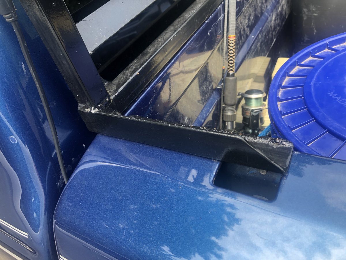

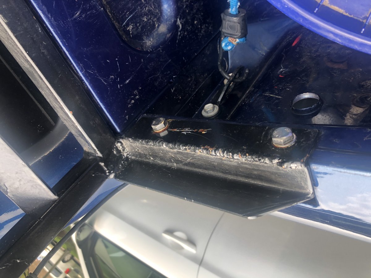

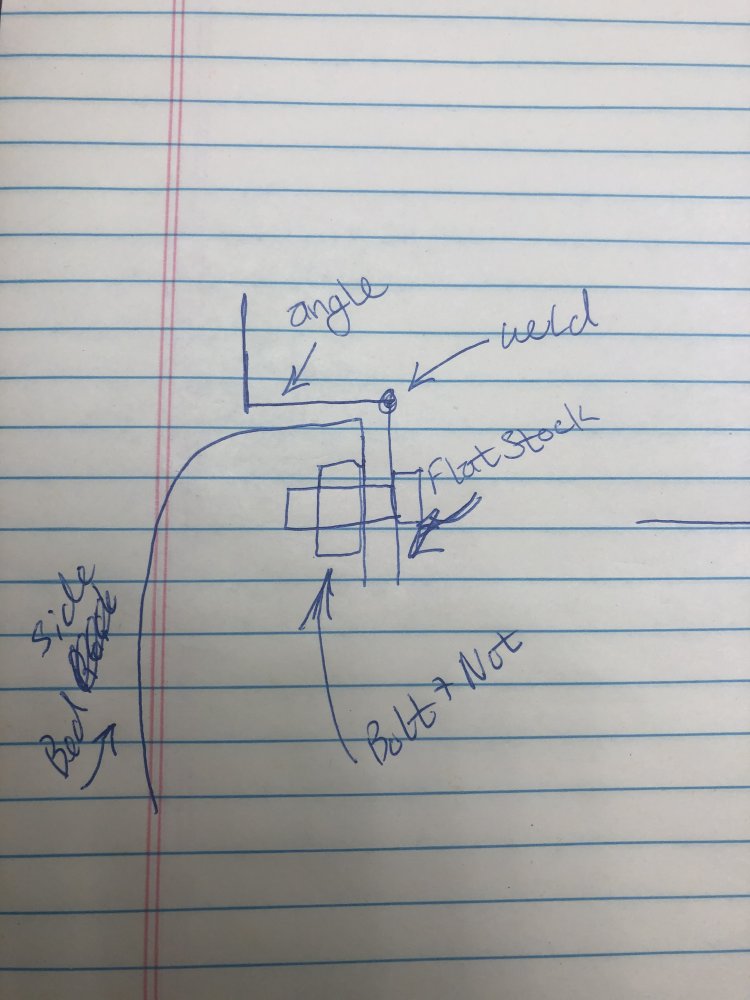

This is how I did it. Used two bolts per side.
Awesome also useful, thanks! I am trying to attach it without drilling holes in the bed, but rather use existing ones. I found some 2x3 stock that fits perfectly in the square holes at the corners. I welded a nut in them so they drop in and bolt through from hole is on the inside that most people hook tie downs to. They stick out a bit, but I am thinking to cut them flush to bed rail, weld some plate to em, and build off that.
I might do a modified version of your design, where I would have bolts pinch clamp it from underneath rather than go through the side...
