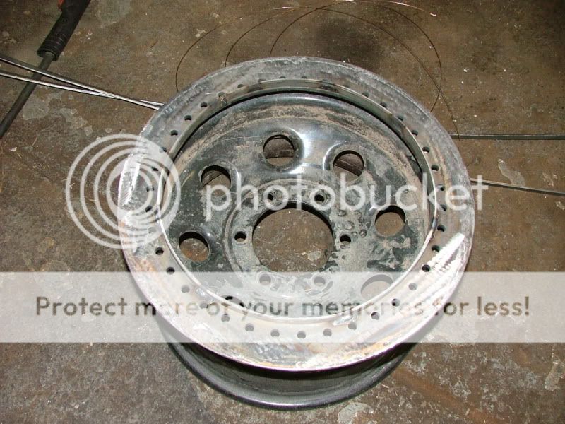

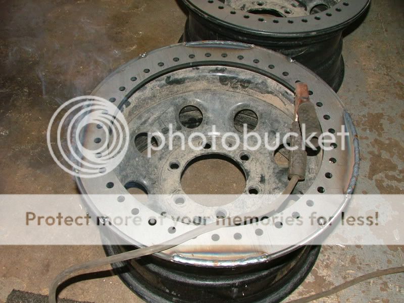

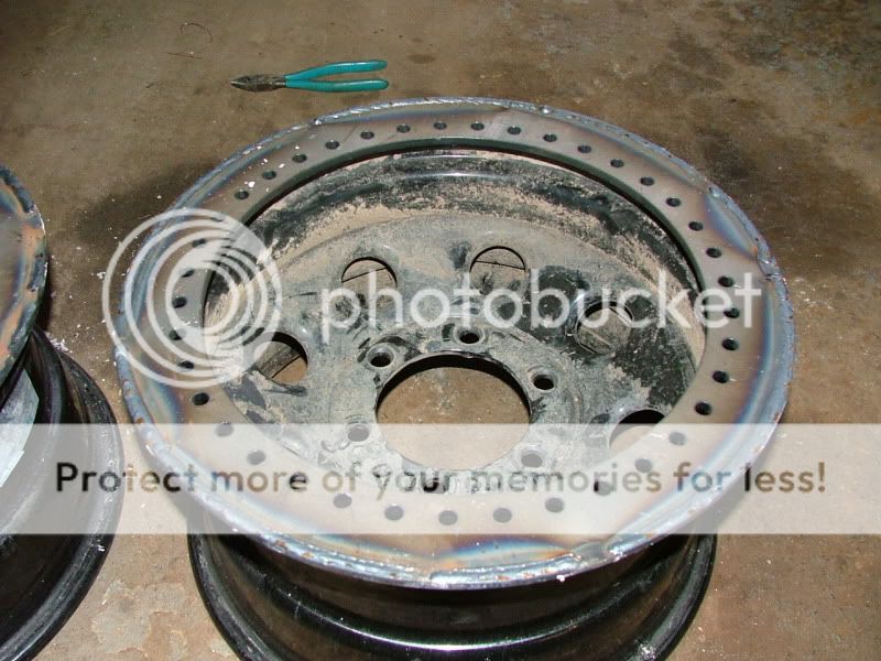

Got started on my bead locks, 2 welded so far
I overlapped my weld starts and stops, I think they are turning out great so far

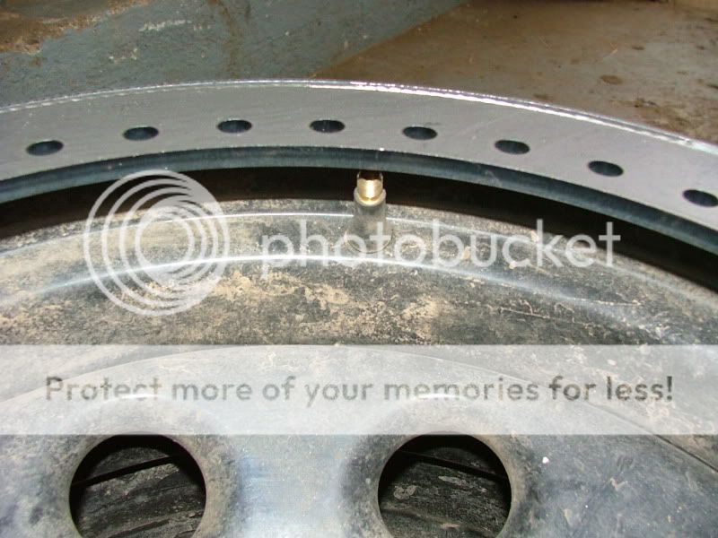

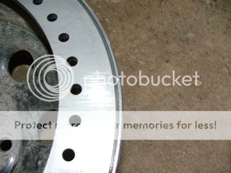

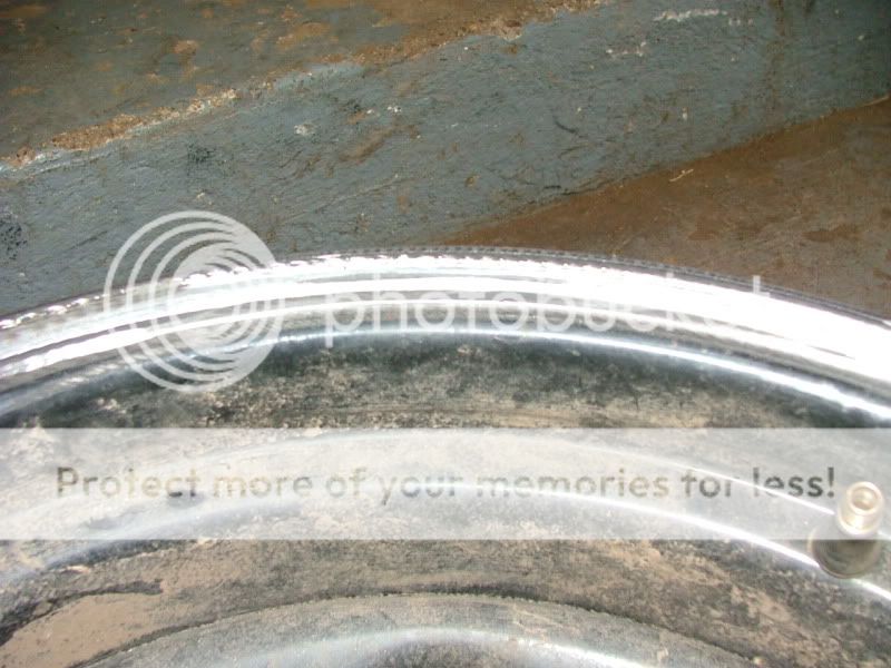

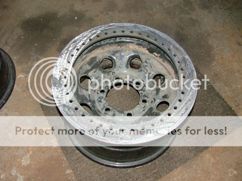

one ground smooth
When it comes to bead locks, I'm not too smart, but does the outside part only get welded, don't the tires get knocked out on the inside too???
I guess what I'm typing, is why only one side ?!?
Robert
P.s. your welds look great
dye pen for airleaks? just an idea, should be able to get one at an industrial supply store.
Of the six sets I have done I have never checked for leaks lol. When I mount the tires each time a goop the hell out of the weld-rubber mating surface with bead sealer. Worked so far on 36 or so tires. And I know its not cause of my welding but the sealer sealing any potential pinholes lol.
Robert
The inner bead is considered a "strong bead" as in its alot harder to knock it off, vs the outside bead which is very easy. Weld the ring on the inside like kyle has. Drop the tire onto the rim with the inner bead normal on the rim then you rest the outside bead on the ring and the other ring clamps the baed of the tire between the rings. I have only ever seen one bead get pulled out of the rings. I have been running my LTB's at 2-3psi for almost two years and knock on wood haven't lost an inner bead yet.
Yup, what CTB2 said. The ring sits inside of the lip, then I welded the gap, then ground smooth. Maybe on the next ones I will take more detailed pictures.
Robert, thanks!
The inner bead is wider also, so it is harder to knock it off.

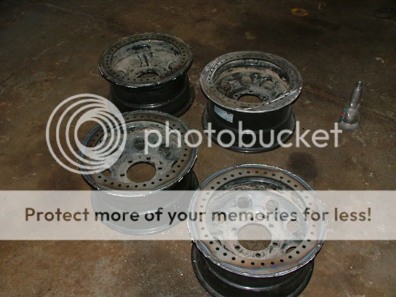

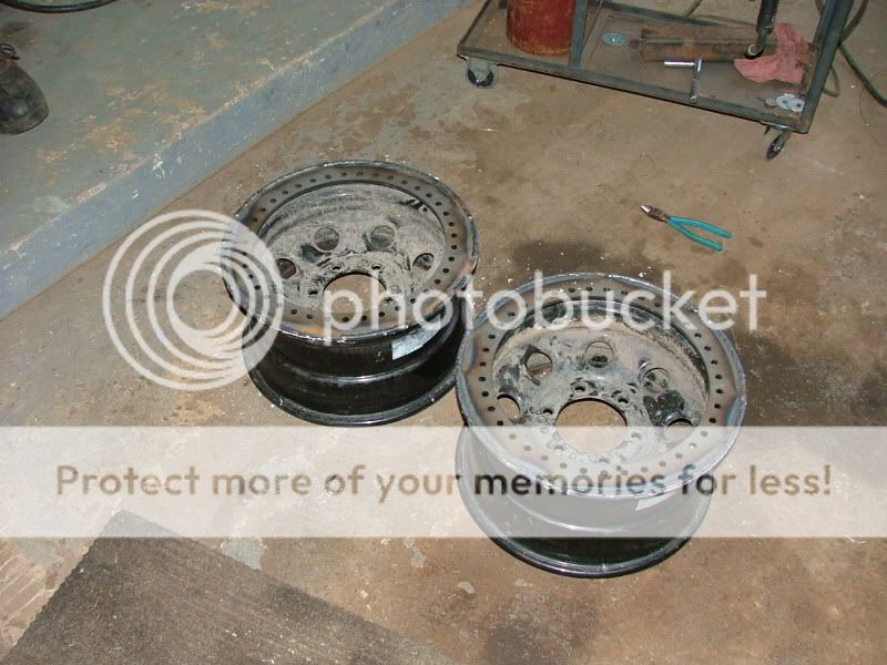

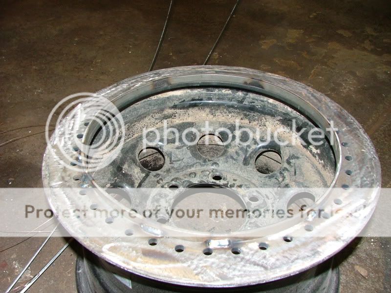

Alright, got the rest of the rings welded into the rims, took a few pictures of the process.
Ground the paint off the inside lip of the rim

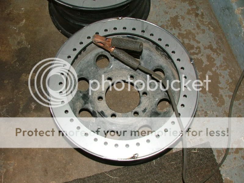

Positioned the ring inside the rim, rotated it so the valve stem was between the bolts.
Here is the gap that gets filled in with weld
Tacked in place

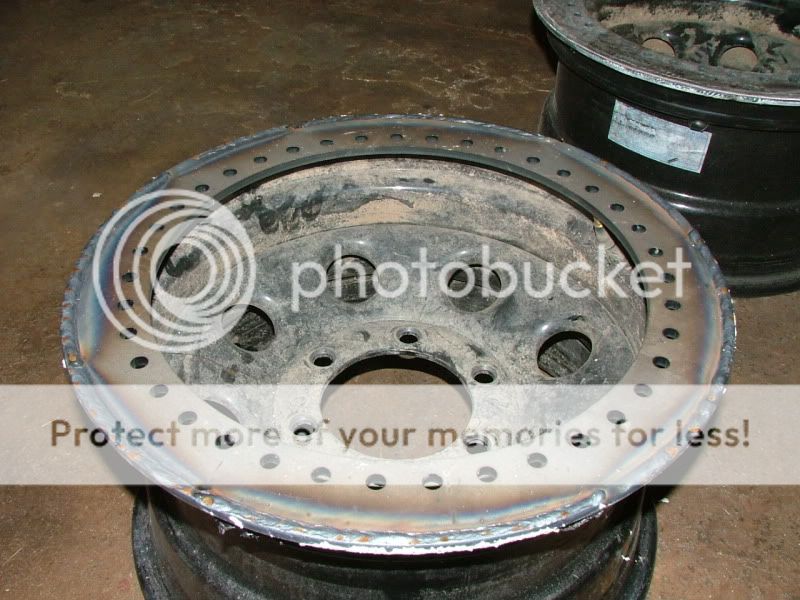

first set of welds, I do 8 separate welds
finished welding
all of them welded up

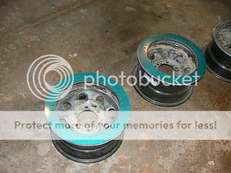

Then I started on my anticoaning rings, they are .125" thick by .5" wide
Then, last of all, I painted my rings booger green. I know I will teased for it, but F it, it's mine and I like it

looks good man, and i like it when the outer rings match the trucks color.....no matter if it's booger green or hot pink
since ya got the paint out might as well hit the front clip too
