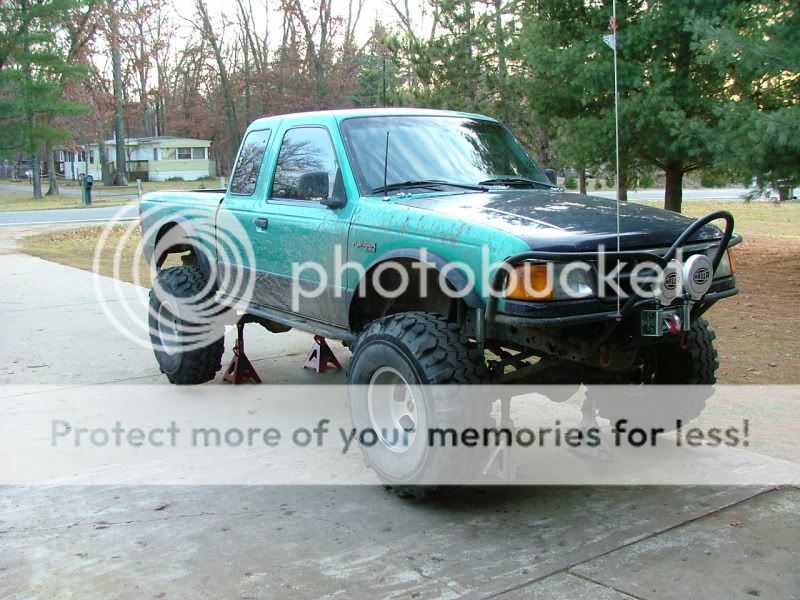

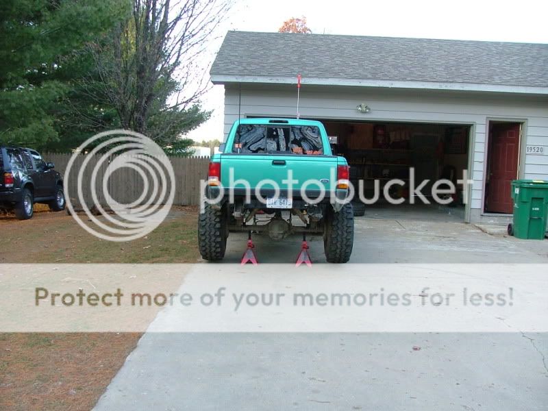

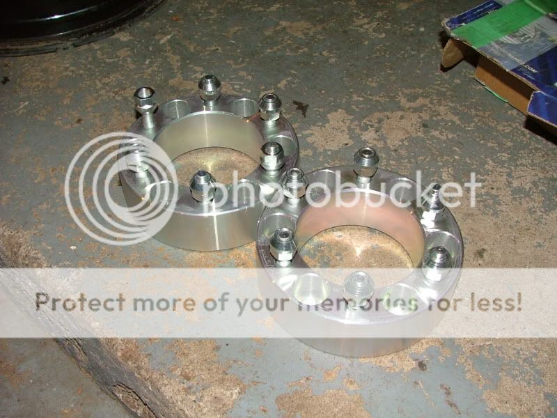

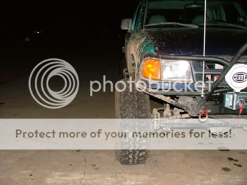

Yesterday I got my spacers, couldn't wait so I put em on (yesterday)
2" spacers to match the rear ones, sweet deal couldn't pass up, $20.50 shipped, new from ebay
before
after

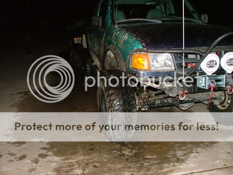

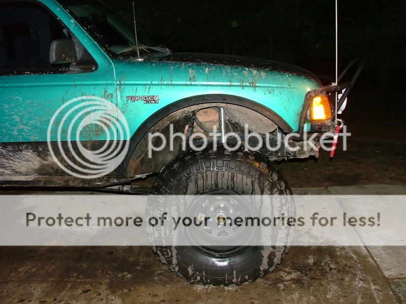

I also put on one flare....I'm like a little kid, can't wait for nothin...

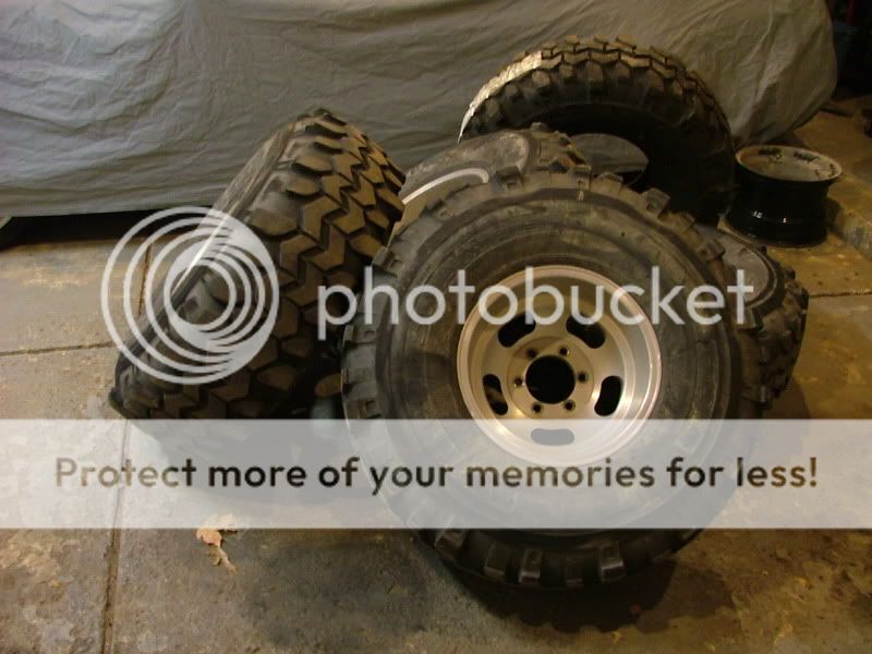

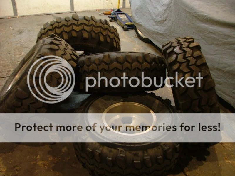

Then a quick look at the new tires and rims...notice the one in back with the sticker on it still??? All for 4 35" BFG MT's.
I also just ordered an ebay groover.....so the fun begins...
Them fender flares look familiar :icon_idea: How you like em so far??
SVT

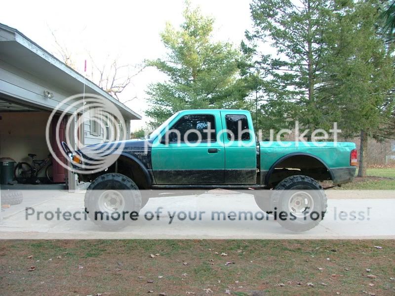

And, got my Pacer Flexy Flares a couple days ago, gonna put em on tomorrow maybe...thanks Bray!
Good to see you're already putting them to good use! Looks like you'll need them more than me anyways with the spacers haha. Man, this truck is turning into a beast!
Those wheels are awesome. :icon_thumby:
I like the flares, they look nice. They are a little bit of a pain to put on and they don't sit real tight to the body in some spots, maybe as it warms up they will relax a little.

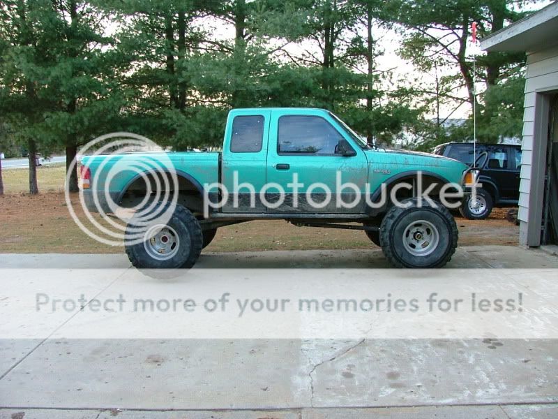

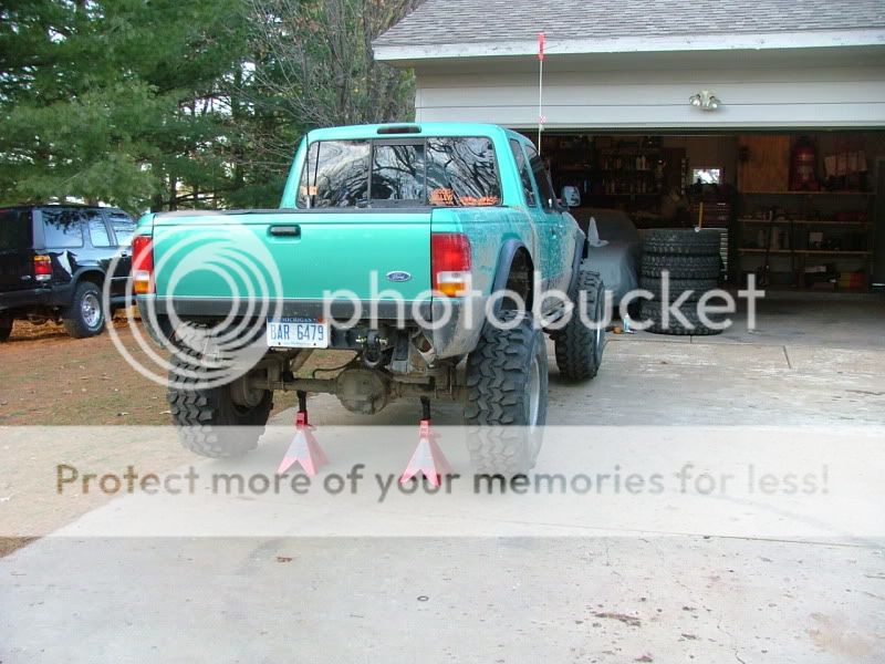

Got all the flares put on, got my adaptors for the rear today and put on. I rolled the new chewies up infront of the truck to put em on but they wont fit with out new lug nuts, I got some with them, but different size thread. They have shank style lug nuts and I could buy some, but I would rather have steel wheels. SO here is the new look, on jackstands, but it wont last long, gonna swap rims.
check the new width

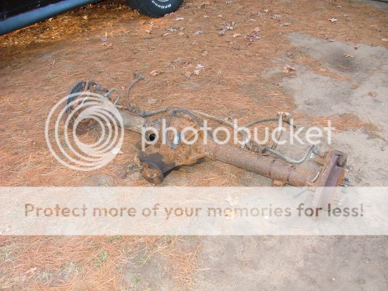

new to me axle.....think I'm gonna try and take the axles out of it and put it in the ranger housing with a new 31spline locker. Then I can prep the new housing for a 4 link maybe???
Thanks for lookin
If you have the small ranger 8.8, the explorer 8.8 shafts won't fit in the housing. The bearings in the housing at the end of the tubes will be to small to slide the 31 spline shafts through.
Alright. I know you can do it on a Mustang 8.8, figured the ranger would be the same.
Guess I will add a 8.8 swap kit to my list of things to buy....

LOL, I like the wheels just not sure if I wanna run em or not.....keep them on run black steel???? You guys help me decide!!
Where the hell did you find spacers that cheap? All the ones I ever seen on there were over $100.
I bought them from some dude who got them in a 'lot buy', started bidding low.....lucky me!
