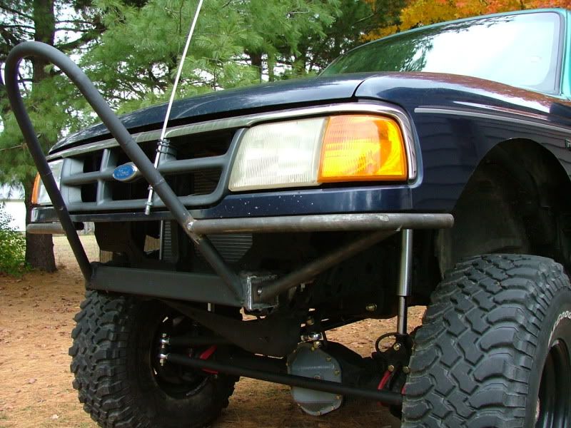

Time for a new bumper. The factory one serves no purpose and I need some recovery points, so here is the start. 2x3x 1/4" wall tube, frame notched to fit and welded in. Then I put on the stinger, gotta have it. The stinger is off of the old bumper, trying to work it in, but I might just make a new one....this one is kinda mess up.

Still have a ways to go, think I am gonna tie the stinger into the shock hoops. Still need to make a flag mount....
cut your front header panel like i did mine, gives ya an extra half inch of clearance and less to paint...

Yeah, guess we will see. I kinda like the flat bottom.

Worked on the bumper more till I ran out of tube...

Gonna run some tube into the grill and attach it to the hoops, run another cross car inside of the hoop, add some shackle hangers and maybe a winch plate of some sort.
