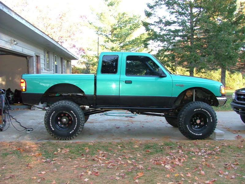

I want that truck so bad. I set it as my backround at school and kids were saying thats a crazy ranger haha. I wanna see it at full lock while flexing.

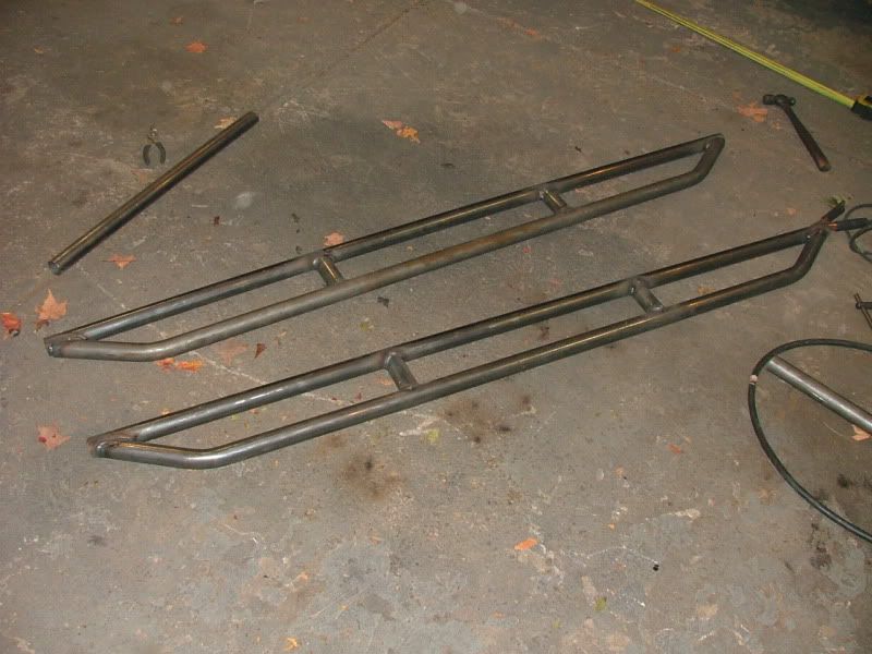

Update, started my sliders. Decided to keep my rockers in tack for now. Sliders are made out of 1.5" diameter with an 1/8 wall welded seam tube.....got it cheap, should work fine.
Nice. Ive got a set of Trail Gear sliders sitting around....just been too lazy to get them on. Are you going to bolt yours in, or weld them solid to the frame? Not sure what I should do. Oh...and are you plating the frame at all?
I am going to plate the frame, I cut some 3x4 3/16 thick plates for it. It is all going to get welded on.

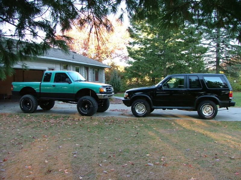

And about height, lowered it 1" today, took out my overloads. here are some dimensions
slider height
frame and cross member
my roof height is about 76" and here is a comparison shot next to my daily, almost stock Exploder
I think I like the height, just want some bigger meats for it.

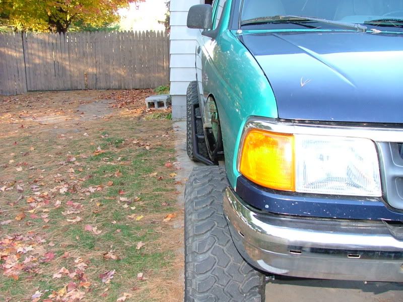

I like the sliders, how did you mount them to the frame?
