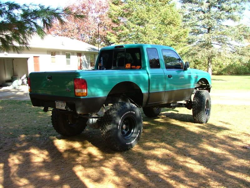

Alright, added my 1.5* bushings, tracks better but still need a sway bar if I am gonna drive it much. Good enough to get me to the trails.....
Descion time....cut the fenders, yes or no??? I think I'm gonna do it. Basically remove the flare with the cut off wheel.
DO IT....i think it looks so much better...but i am kind of swayed.....
On my way....it looks too stock. I will post pictures when done!
man your truck looks like it be very fun you have a lot of flex to nice work keep up an post the progress being made
exactly that what i liked about it...too much stockness with factory flares :D
plus that would let you lower it more if need be
Well, after a couple of hours I have this...
And now I have a cut to shit truck, and I don't like it
I love it! Make it looks so much more....ummm, not stock? LOL
I also managed to put my CB in so I am all set to wheel. Now I just gotta go wheel it. No one wants to wheel and I don't wanna go alone on my shake down run. I might go explore a little tonight after my wife gets home from work to and I can turn in my kid watching duties for the day....
looks way better Kyle, suits the truck. Now get the truck painted back to the way it was....
Already on it, getting a line on paint and gonna spray the hood and fender before winter.
Dude that turned out really well, it makes me giddy to start on mine.....did I just say giddy?
