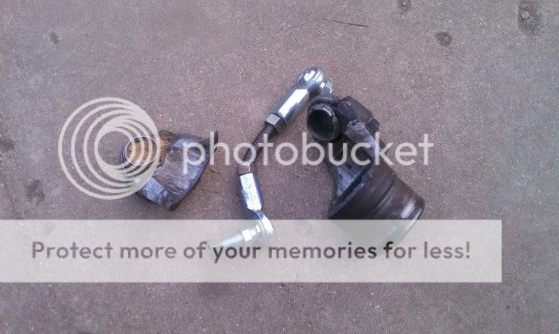

Well, guess I should update this. Took it out wheeling last weekend and broke it again. I ended up splitting the yoke on the front output of the case, apparently you can remove too much material
When the yoke broke it took out my front twin stick shifter linkage.
Gonna run 1330 joints now and I am gonna try and fit a cv in there so I can use all my travel.

Your linkage looks like it only needs a new rod in it.
I think you need to be a touch lighter on the skinny pedal.

Yeah, I have a whole chuck of threaded rod, got it all fixed.
Lol, skinny pedal makes it fun, just need to find the weak links and that is helping :icon_twisted:

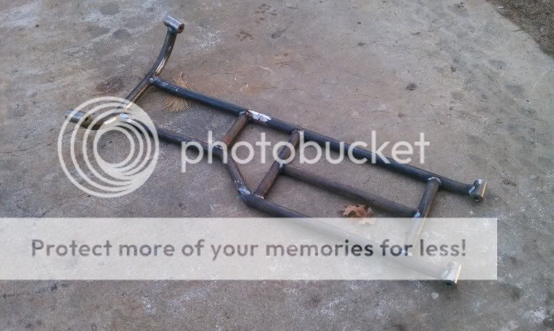

Front drive shaft made and Installed, swapped out wedge bushings for better pinion angle, fixed tcase shifter, made a skid plate frame, just need to skin it with some 3/16, and put longer shocks in the rear along with some shock hoops.
Pics
Skid

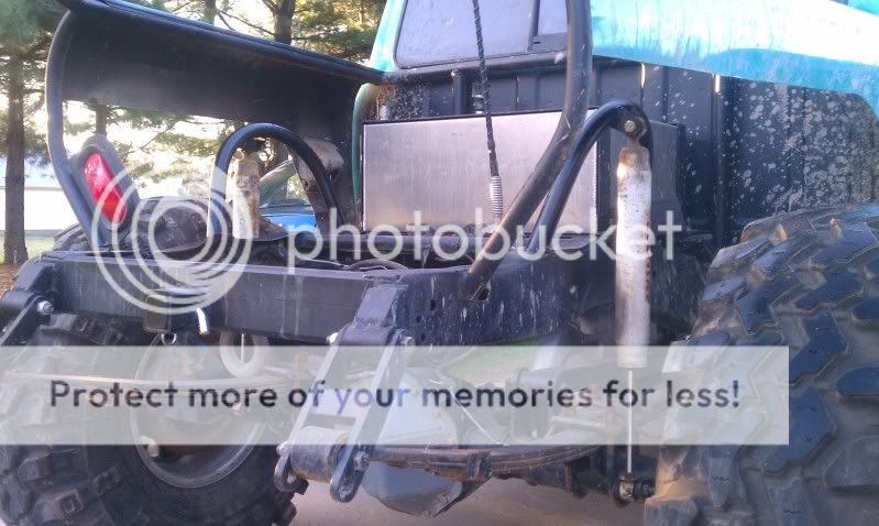

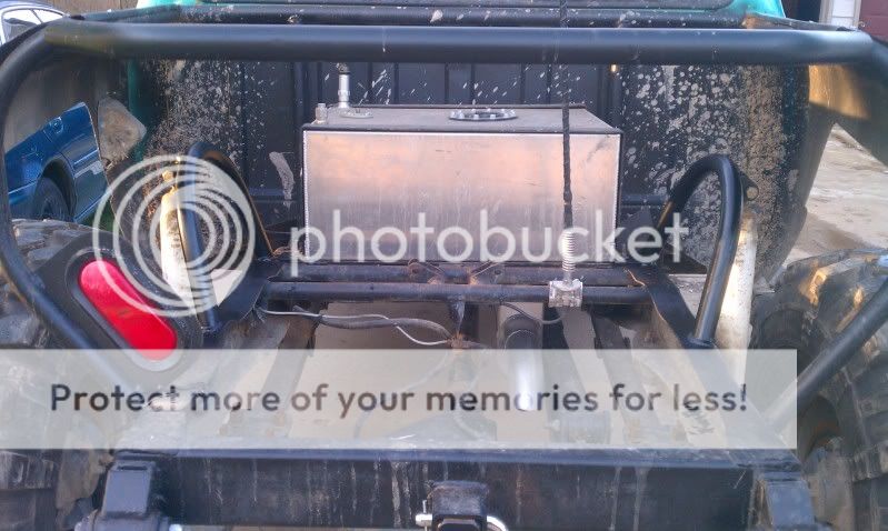

Shocks
Kyle M's Ranger Rebuild
If the longer shocks work out, ill get some new, better ones as these ones are whipped
