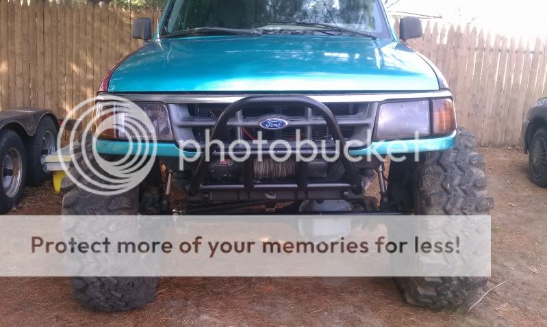

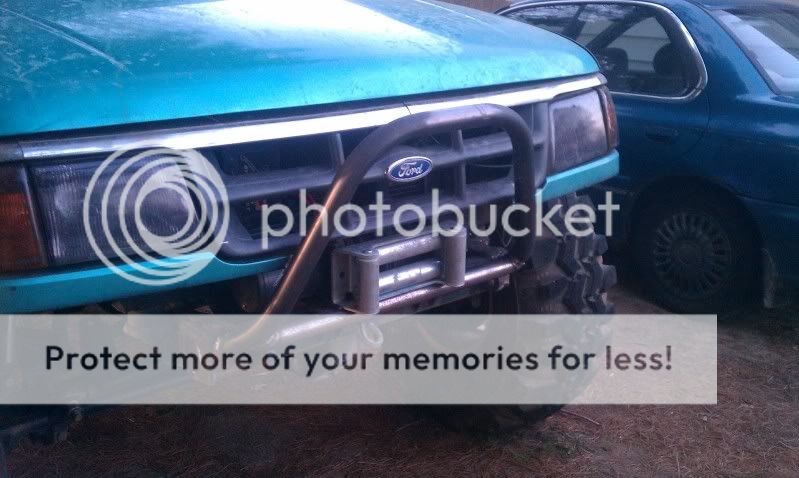

Started making my front stinger, winch guard tonight. I am happy with it so far, just not sure what I'm gonna do for a fairlead mount, I don't like that part of it. Might just box it in with tube to guide the cable onto the drum and go without the rollers, ill just smash em up anyway lol.

Looks good Kyle. You could use round bar to go out slightly in front of the fairlead (under it, but slightly in front. Look at the one on my explorer) just gusset the bottom to provide the "smashing" support. I plan to do the same to mine

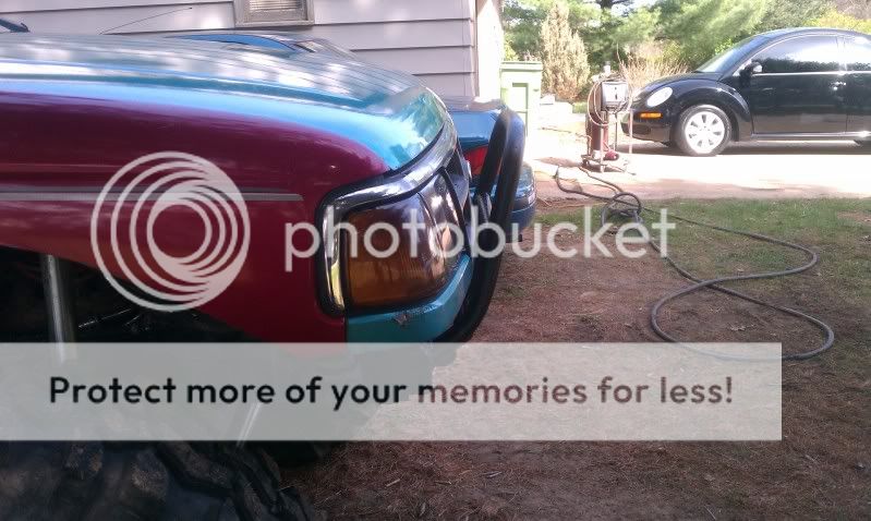

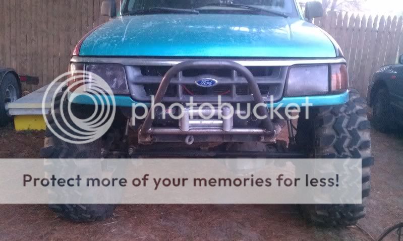

Finished the bumper and fairlead. Just tubed a Fairlead, gonna switch to rope so this should be fine. Looks nice and clean too.
