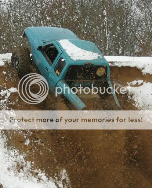

Here is a picture for proof it wheels...

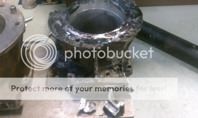

As I kinda wrote last night, I pulled the trans and found some more damage. I broke the trans adaptor where it mounts to the tranny mont/crossmember.

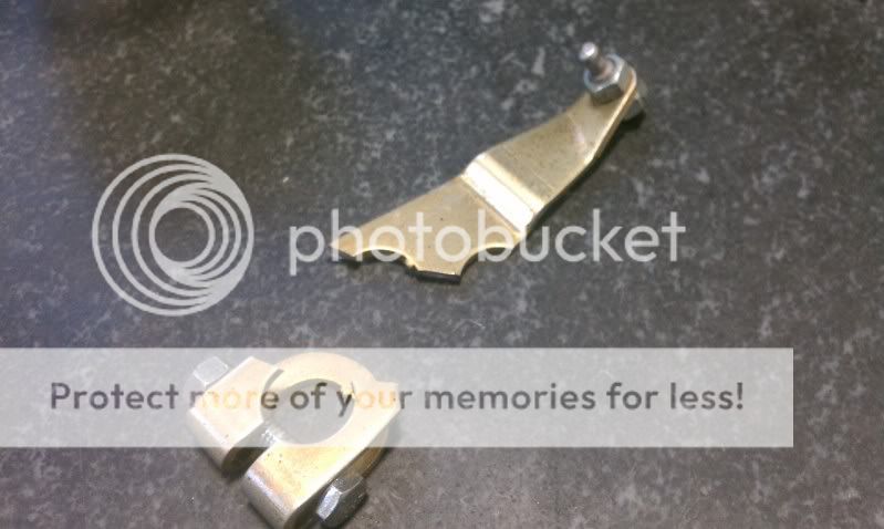

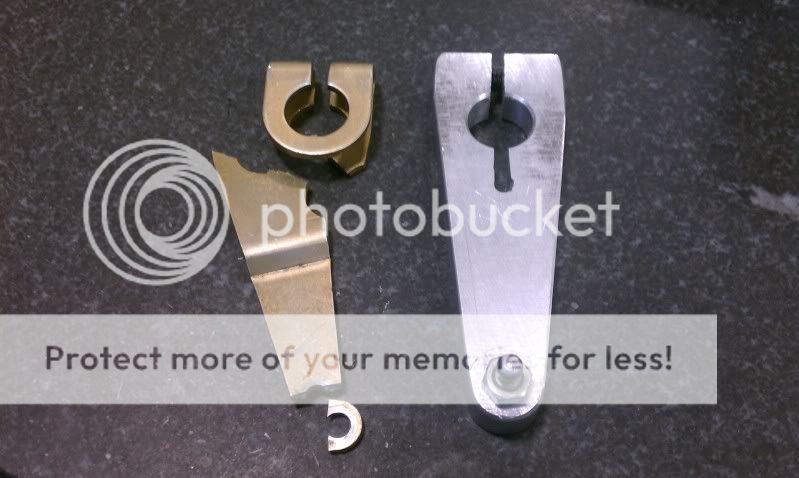

Broke shifter linkage

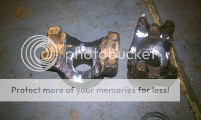

To fix the front for now, I am gonna put my 1330 yoke on and get a conversion joint, grind some more and limit it more just in case. I am pretty sure the broken tranny mount caused the tranny to lift, which put the joint in bind and broke the yoke.

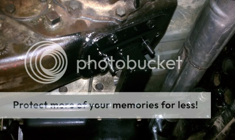

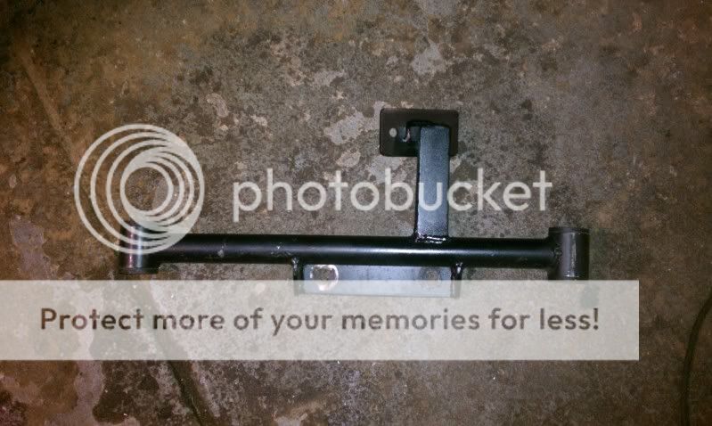

T case support made, added to the original tranny cross

Installed

I also made a new shifter linkage, better than the busted up one for sure! I made it out of 1/2" thick aluminum.

Here are my newly modified yokes. I counter bored the pinion nut holes 1/4" deeper and put spacers under the yoke when installed to gain the clearance i need. I am gonna run a 1330 yoke on my 60 (had it) and a 1310 yoke on the 205 with a conversion joint at the axle for now. If I have no issues I may buy another 1310 yoke. Might just step up to 1350 too, who knows....
