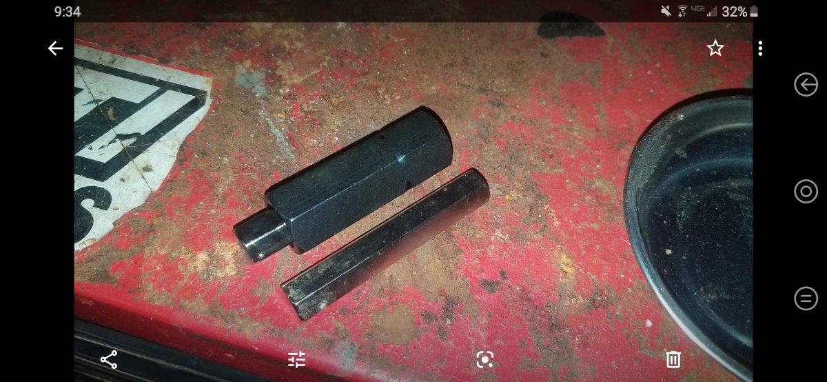

Start spraying the nut on the top of the front shocks now.... and buy one of these... and then be prepared to use a sawzall. :icon_rofl:
Stupidest design for a upper shock mount in history...

I've changed mucho lot of shocks in my day so I'm fimilar with the problems.
My simple cure for nuts I can access like the Ranger is a good ole fashioned nut splitter. Good one with an impact driver will take that puppie off in seconds.
I just looked at my Ranger and I don't even have to take the tire/rim off to access the nut. Should be easy-peasey.
