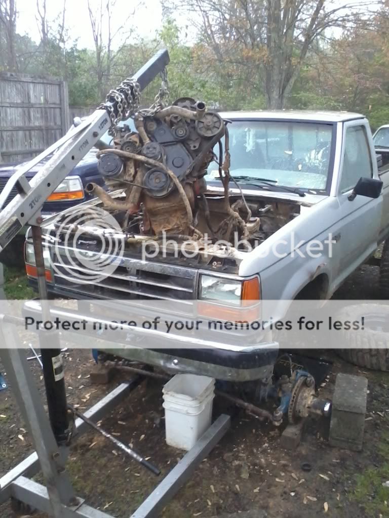

Got almost everything out of the way about to pick up an engine hoist and say goodbye for good to the 2.3!

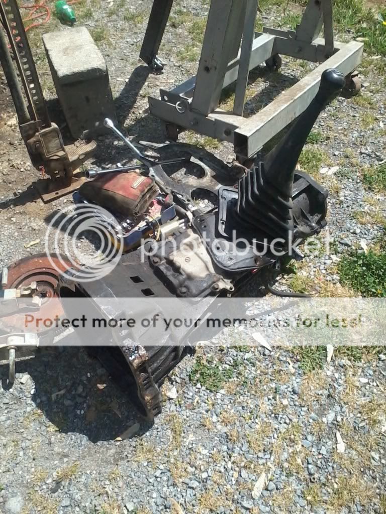

Only had 2 4.0 manuals at the jy. One was bad so I hope this ones good. It didn't have any notes on it and the motor was already pulled.

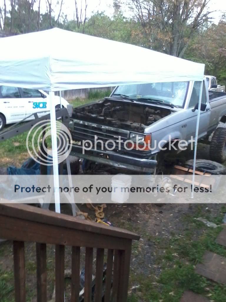

Work done yesterday
Koty's 91 Ranger Build Thread
Then its been raining since....
You need a garage Koty
Sent from my PC36100 using Tapatalk 2
Or at least a concrete surface to work on.
LOL that canopy is my new garage! I was just excited to be out of the rain
