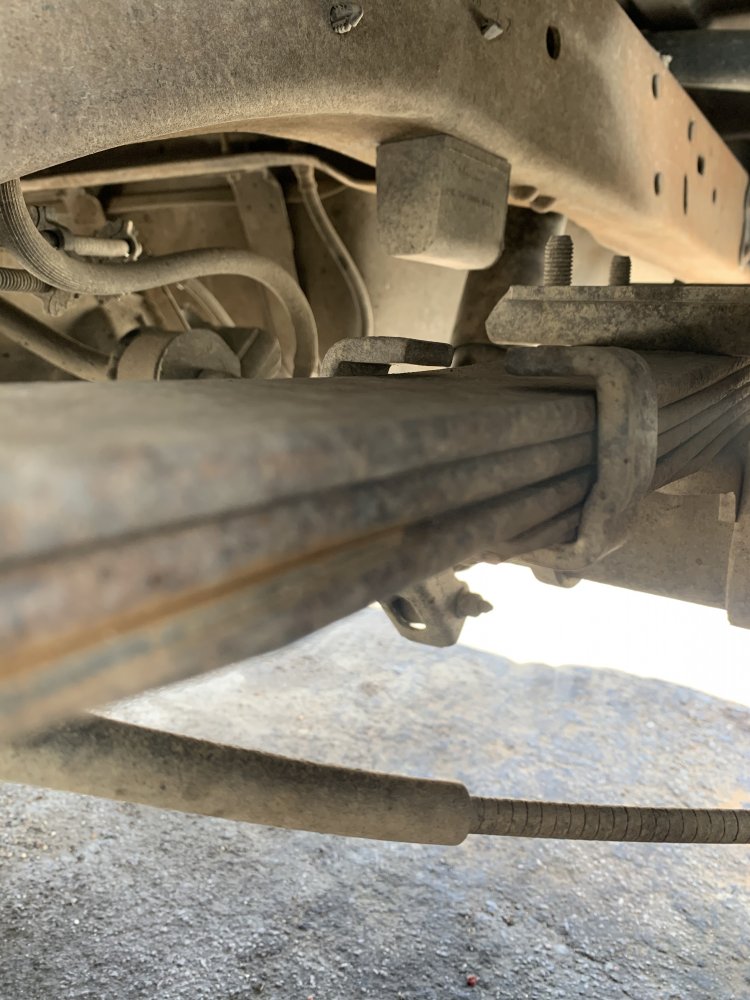

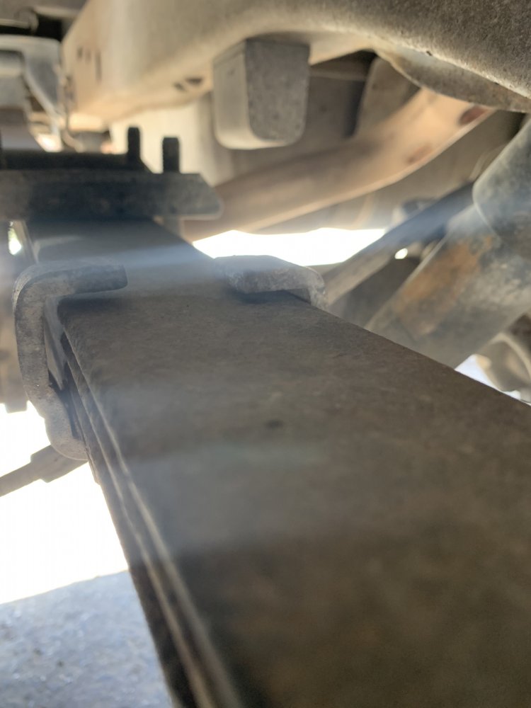

I’m getting a really weird knocking noise from my 87’ Bronco ii. Everything looks good to me and I just replaced all the shocks. Could it be this spacing on this bracket attached to the leaf springs?

No the spring clamps are fine like that. Looks like something is hitting the exhaust though, also looks like the parking brake cable is hitting the shock. :dunno:
