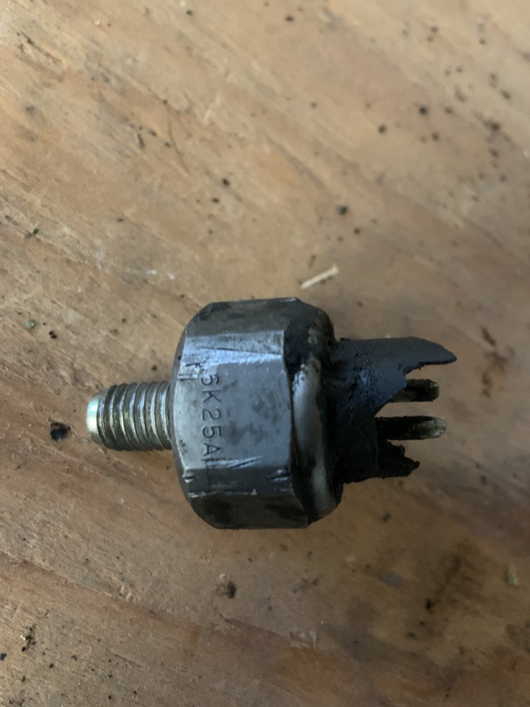

Where is the plug for this sensor? I’m in the middle of a rebuild and I found the sensor but I can’t find the plug
Left side of engine in a separate harness with the low oil level sensor 3 wires in the harness. I will look for my evtm manual later for the wire colors. No one makes those sensors anymore and the ones in the salvage yards look like yours ( broken connector).
Where is the plug for this sensor? I’m in the middle of a rebuild and I found the sensor but I can’t find the plug View attachment 49359
If this is your 89, it isn't there. Someone must have put an 86 or 87 engine in the truck at some point since the knock sensor wasn't used on a 2.9 after 87.
Th
Thanks man. I have been trying to figure it out for months. Never even thought the motor may have been swapped.
