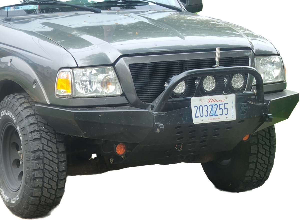

The amber lights come on with the factory driving light switch. The three NiLight LEDs are on a piece of 1 inch tube with three tabs I welded in between the bull bar support braces.
I really didn't want a winch mount as part of the bumper... rather a 2 inch receiver. They didn't have one then... but they do now. At some point I will just do a bit of cutting and weld a 2 inch receiver in.

That's what I meant, a receiver. You put the winch on a carrier then it goes into the receiver of course, front or rear, as needed, and stays, probably, in the tool box otherwise.
Ah, I think I do not have driving/fog lights switch however the wiring is there in the dash and by the lights (that aren't there) so maybe I need different bezel and the switch?
Can't run those add'l lights off the headlights I think it'd be illegal and blind people so yeah, needs separate switch for them.

What size tires are you running. If I can I want to make sure if/when I go to 33" that bumper will meet inspection requirements, looks like it should.
Does it interfered with working with anything underneath?

Receiver has to be really sturdily mounted you might be putting a lot of force on it.

Not sure if I'd get lights from them but might want the tabs for them on the bull bar.

I will say... that front bumper wing survived a side swipe by my youngest daughter with a mear scratch. It opened her car up like a can opener. So there is that...
