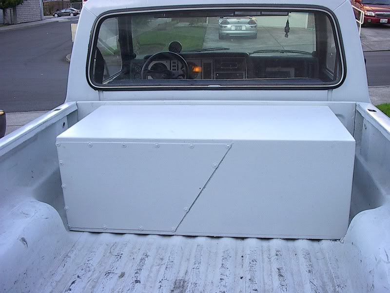

opps! I forgot the pics! Here are some of the sub enclosure and the rest of the stereo.
4th order bandpass with a single 15 inch sub getting 450-500 watts.

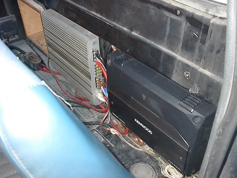

amps and 8x10 blowthru port, yeah I know its dirty.

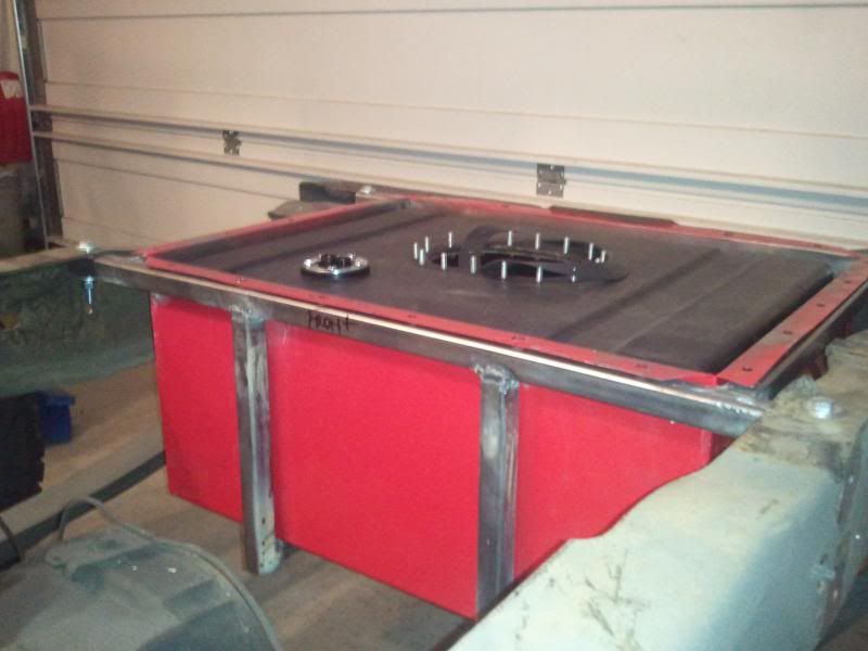

Fuel cell and intank 255 lph pump

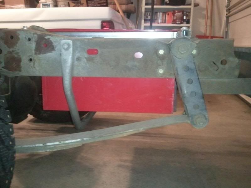

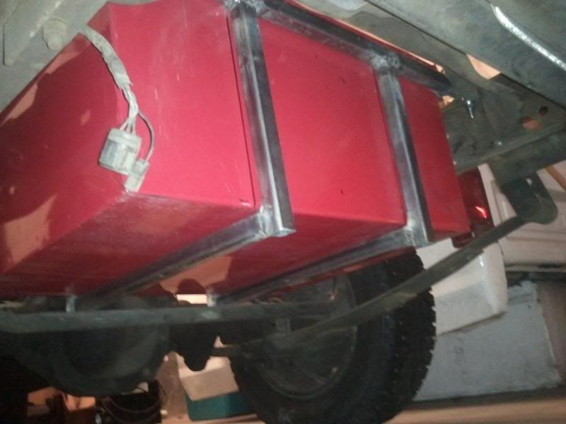

Been working on installing an RCI 16 gallon fuel cell and can between the rear frame rails.
I cut and welded a copy of Speedway Motors fuel cell bracket from 1x1 1/8 wall mild steel tube. :icon_welder:
The Speedway Motors bracket below.... (The picture shows the RCI cell mounted)
http://www.speedwaymotors.com/Bolt-In-Fuel-Cell-Brackets,56241.html
Here are pics of my fuel cell bracket bolted in the truck with the can fitted...

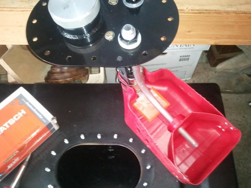

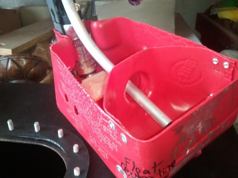

Here are a few pics of the DW200 pump and DIY slosh tank.......
The return line will fill the smaller side of the tank then spill into the side with the pickup screen. I think......:icon_thumby:
