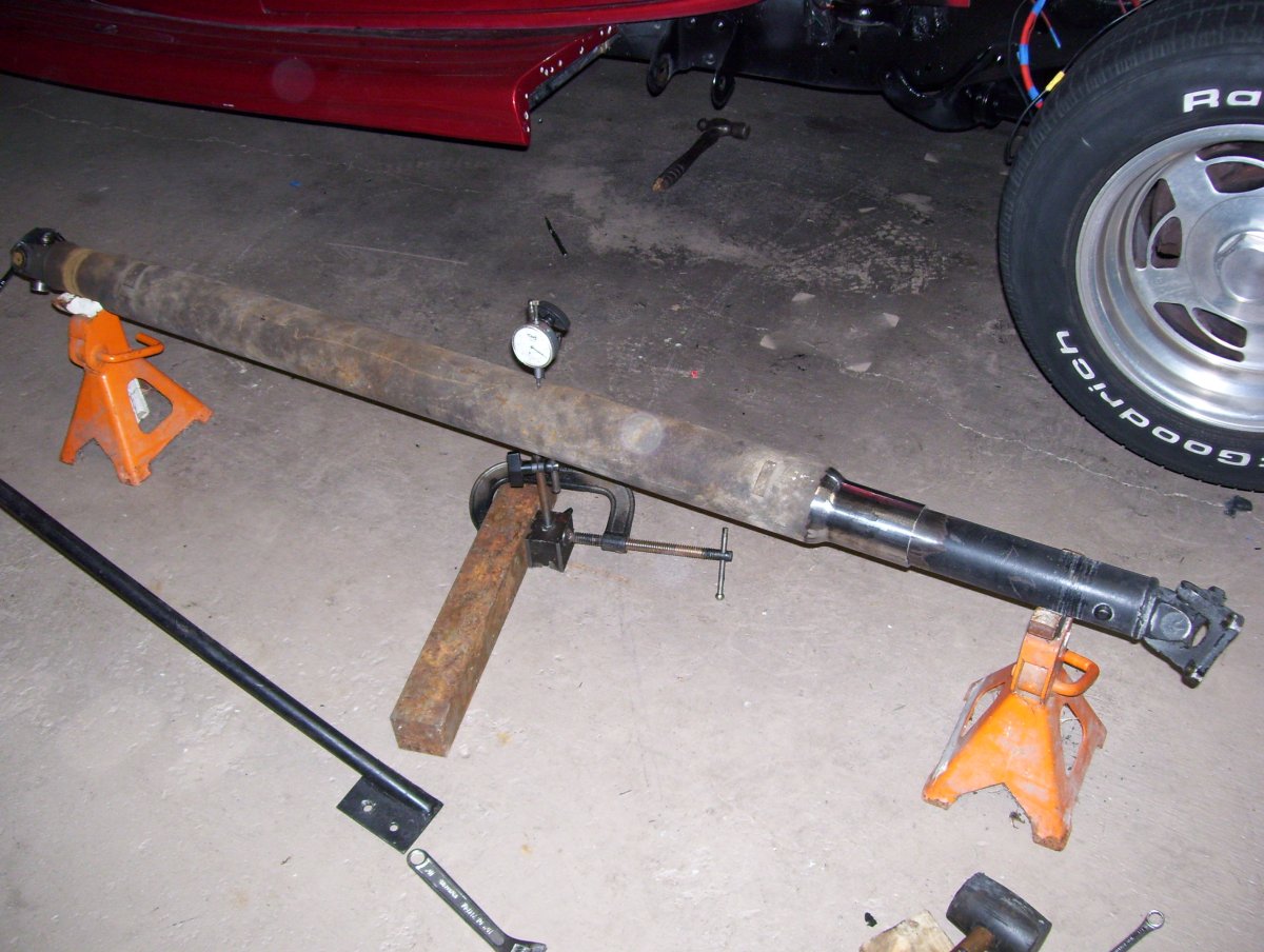

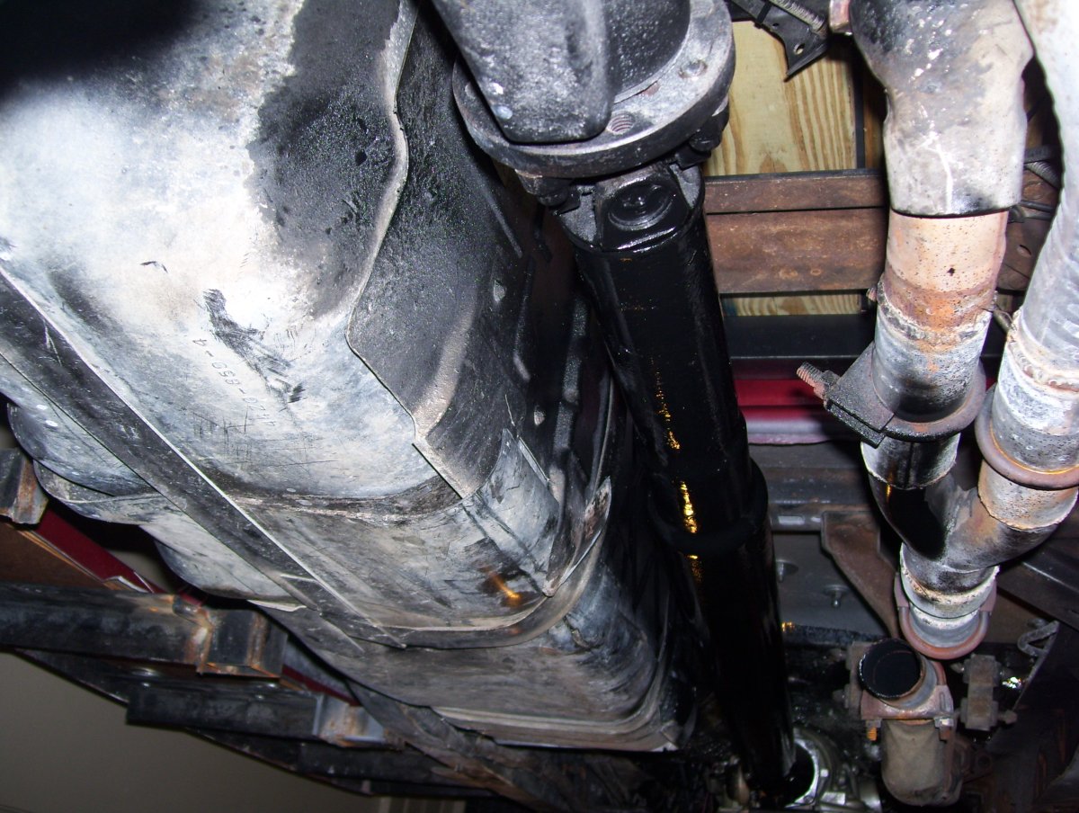

Since the hybrid shaft isn't a tight fit where the two pieces slide together to get a tap-in fit.....then twist the Ranger shaft section to line up the fixed u-joint eyes with those on the sbc shaft.....
Then I'll set the drive shaft on v-blocks and use a dial indicator to keep the shaft true/straight as I tack-weld the 2 pieces together ........then test fit the hybrid on the truck.....then set it back on the v-blocks & slowly weld it solid....
Innnnnnnnstalled!!!!!!!!!!

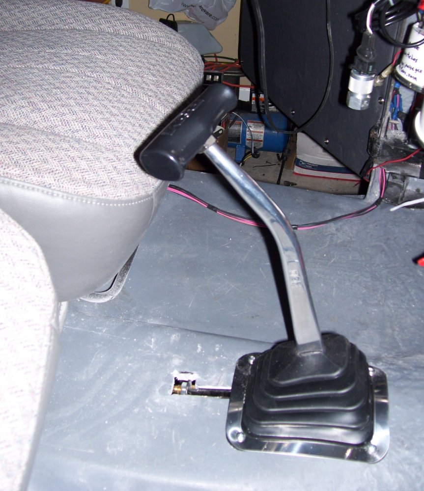

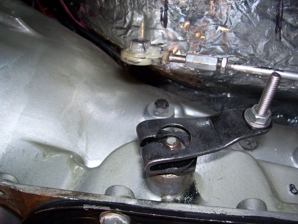

I sawed off most of the OEM chevy xmsn shift-arm and welded a universal shift arm to the part of the oem arm that slides onto the xmsn shift shaft...
then I floor-mounted the B&M Unimatic shifter/put it in the Park position/ran the cable to the xmsn shift bracket & bolted it on/adjusted the linkage to engage all gears on the auto/xmsn....

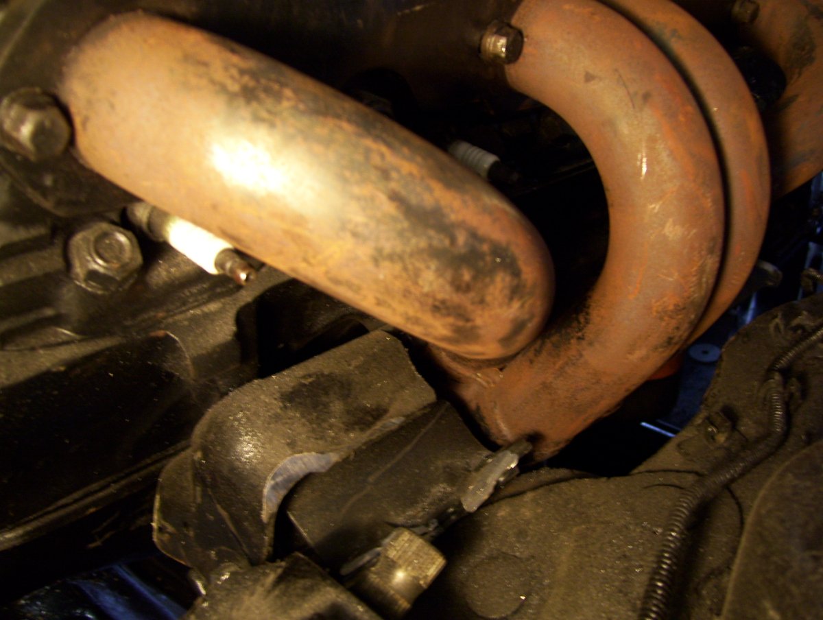

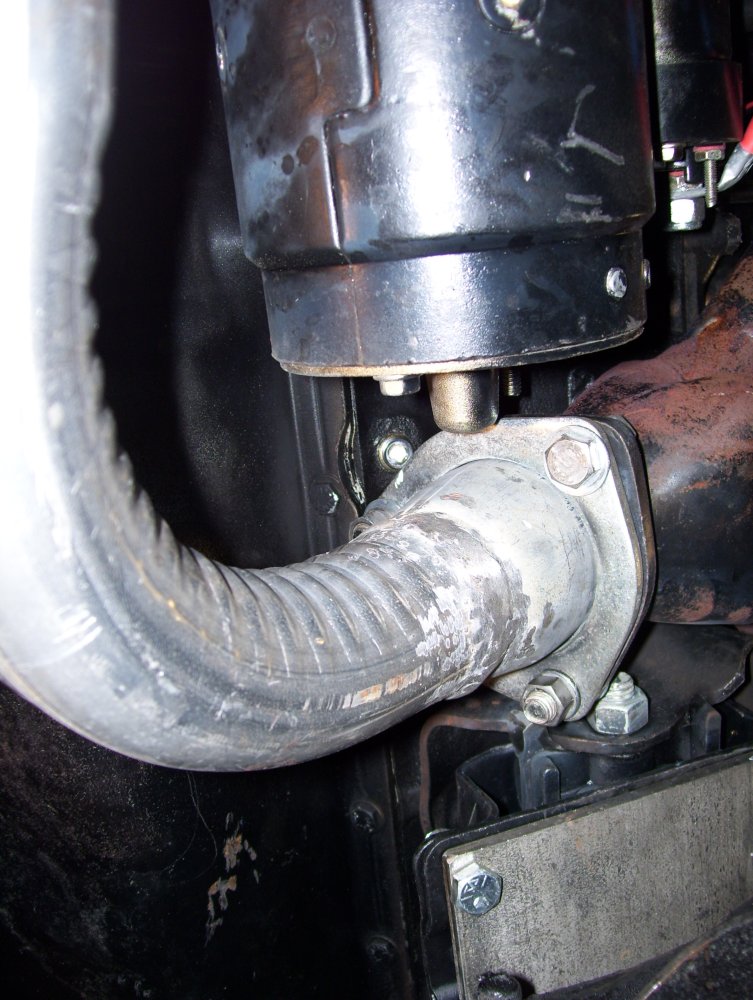

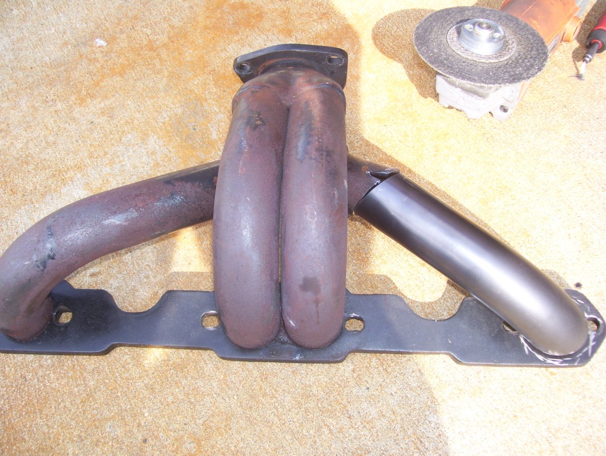

Wednesday......I'm staying away from the wiring today.....so here's whats happening to the headers.....I mocked up the 90 degree bend & welded it into place....now to the parts store for the drivers side bend......there's a good view of the passengers side motor mount adapter plate....
It looks like the starter is in the way, but it's only the camera angle----the down-tube easily bolts in place with 1" clearance from the starter.....

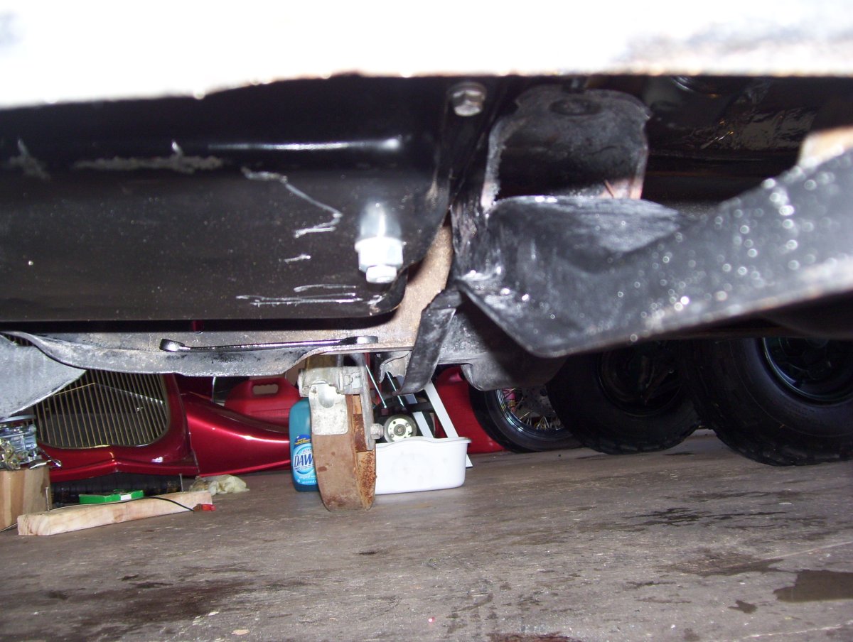

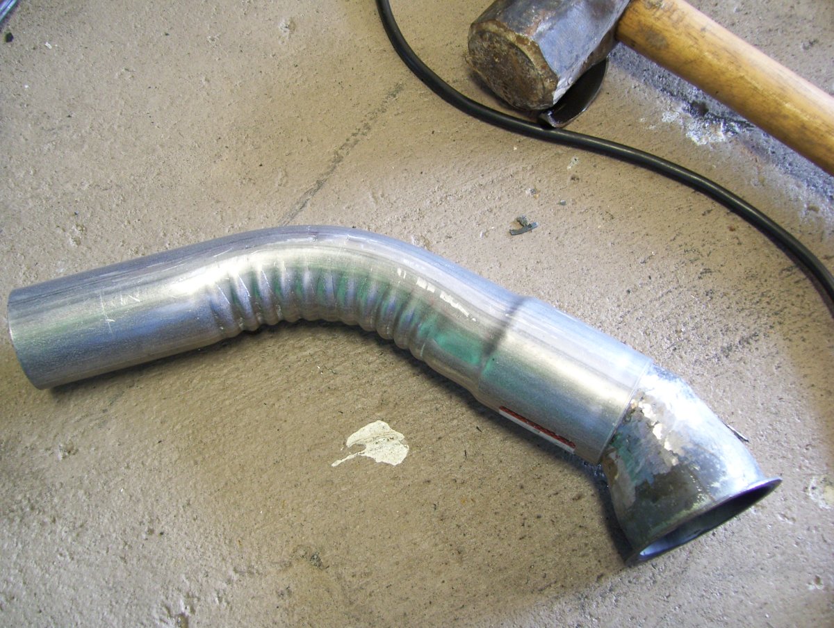

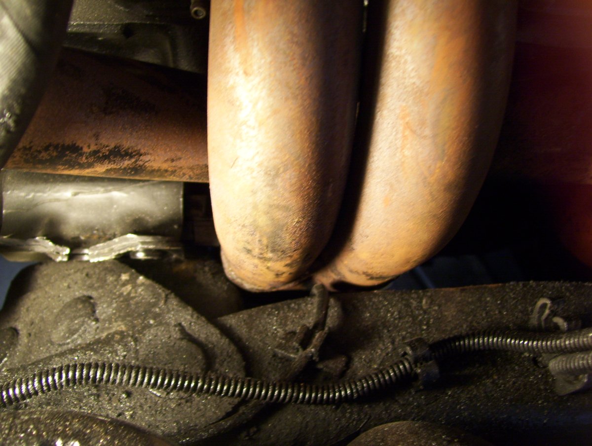

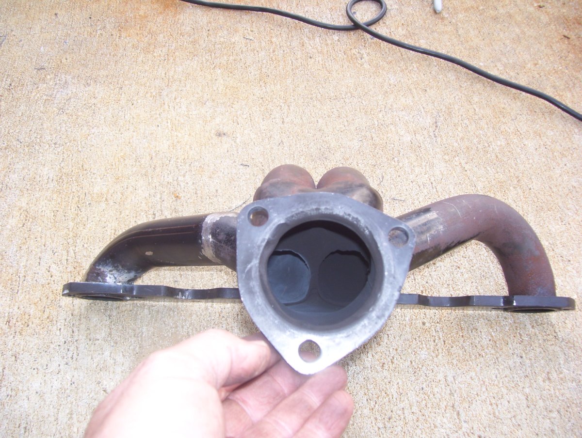

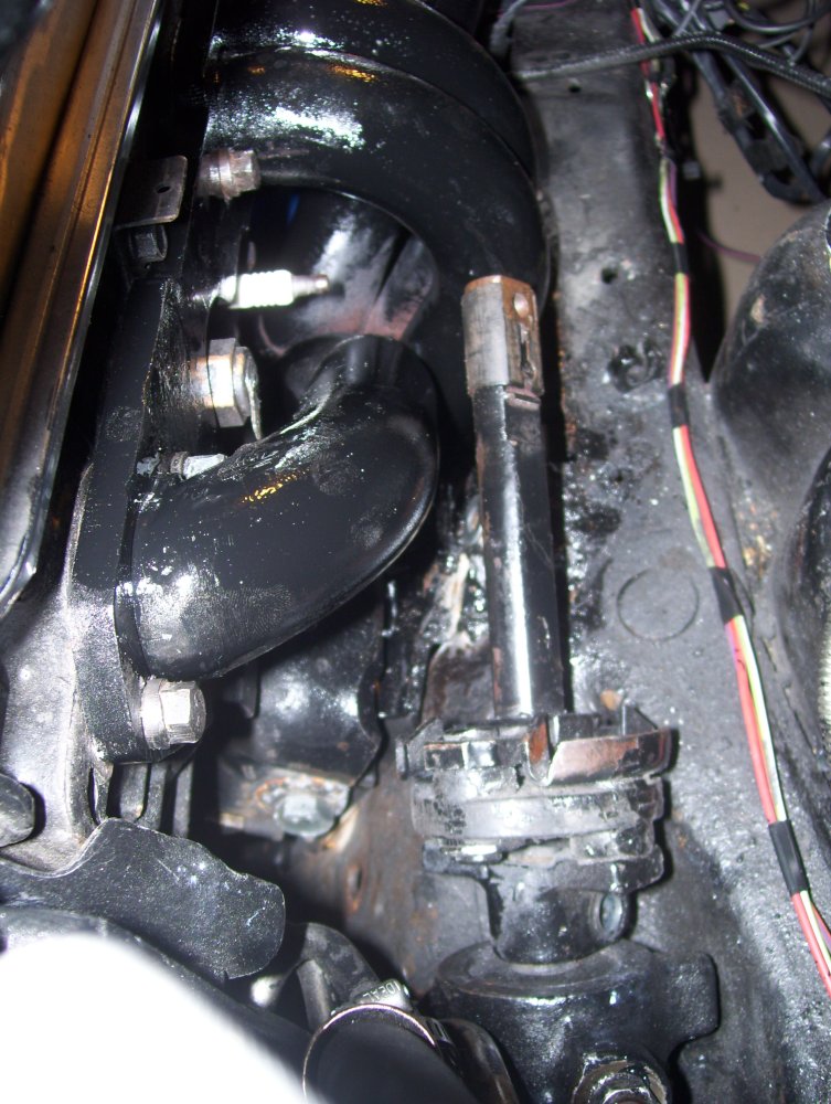

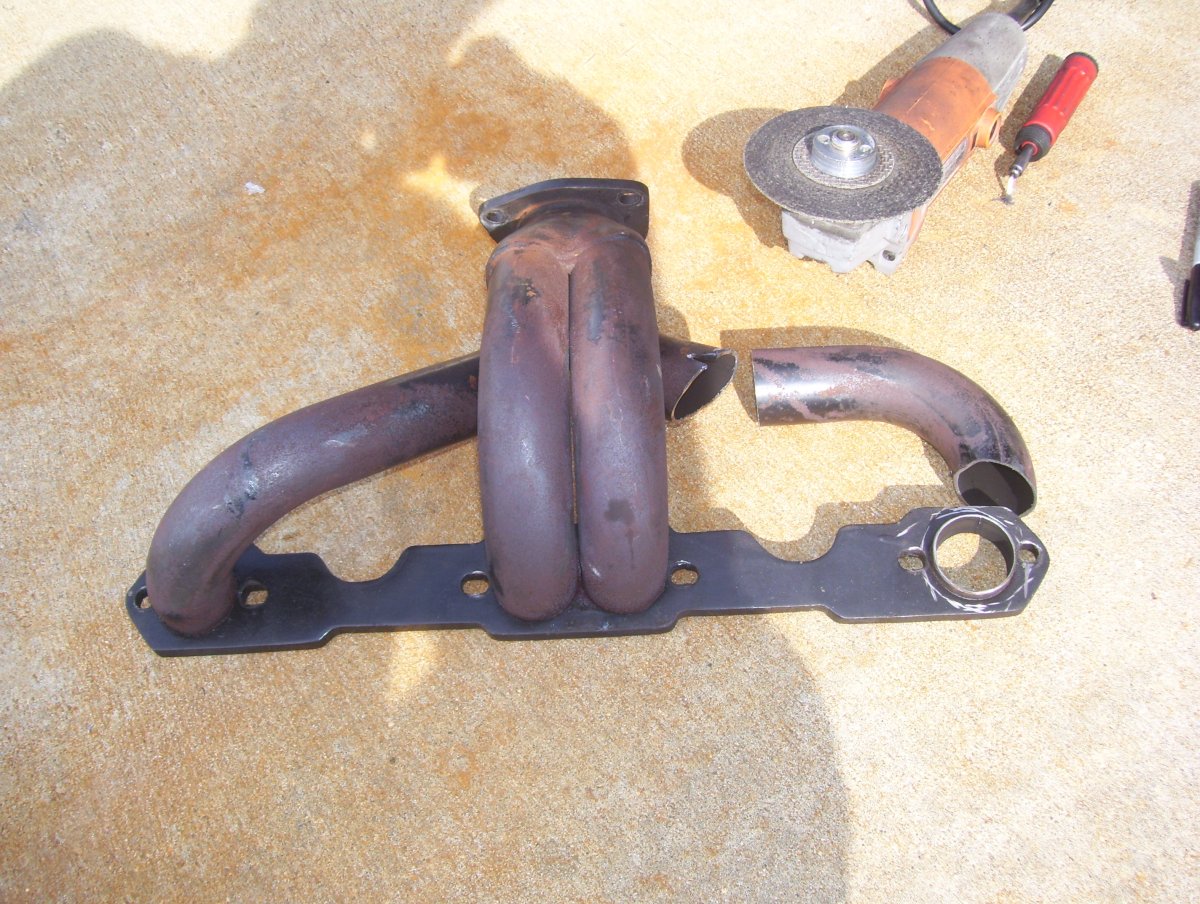

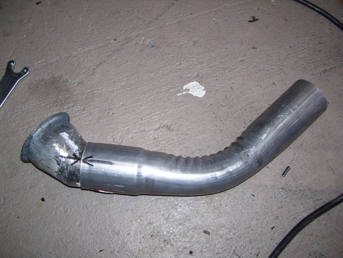

It's a different story on the drivers side header...the header tube overlaps the frame bracket by 1/2" .....the down-tube won't fit unless I modify the the connector pipe that's bolted to the block-hugger header (I could have avoided the prob. by using another type header....but that would have made it too easy...LOL!)
I cut notches in 2 different places....tapped the gaps closed with the ball peen...test-fitted the hybrid...then welded everything up.....
It fits!!!!!!!!!!........

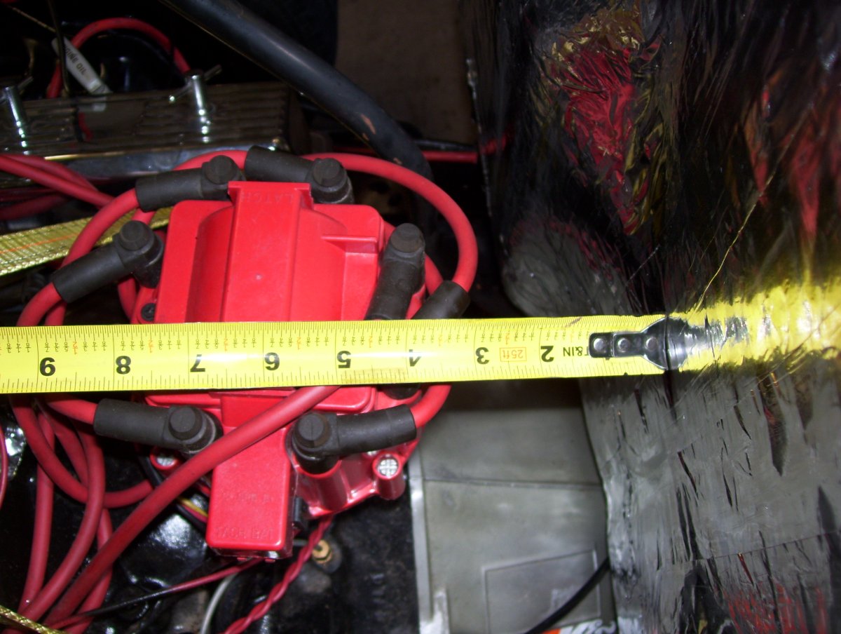

O.K.......3"s btwn the dist. and the firewall.....that's gooooood.....the engine can go back 3 more inches...(when I lower the engine on the motor mounts....I oughta get an inch clearance between the dist. & the firewall)
