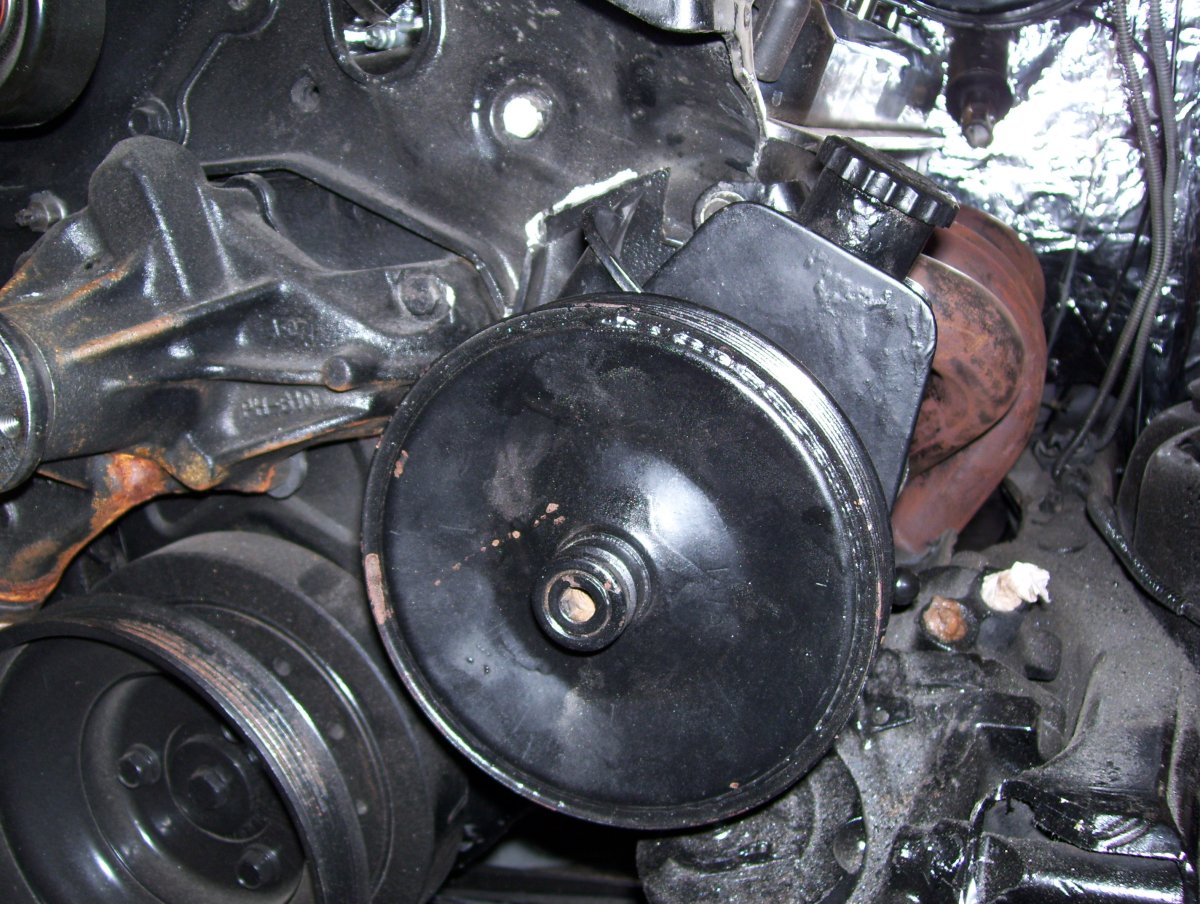

EDIT: This afternoon.....the hybrid gm/ford power steering hose finally is getting replace (I ran outta power steering fluid)....the new hybrid was picked up after lunch & looks real good....Pics when I finish chargin the camera battries (N.O. talk fo batteries)
RE-EDIT: Battries are hot.........................................the top end goes to the Ford steering box / bottom end goes to the gm pum p.....

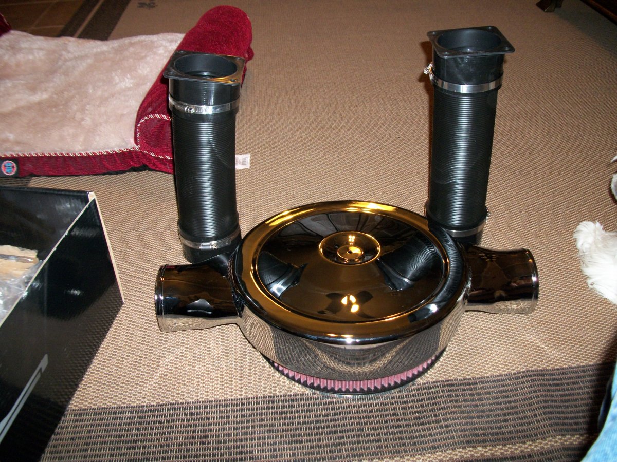

Have I got a surprize for you guys.....Hint: it goes on the Ranger & my Darling Wife bought it for me for our wedding aniversary...(of course she doesn't know what it does....that's why I put it in the basket & let her push the BUY NOW button.......
Ohhhhhh.anothe big hint: it's k-k-k-k-k-k-krome!
