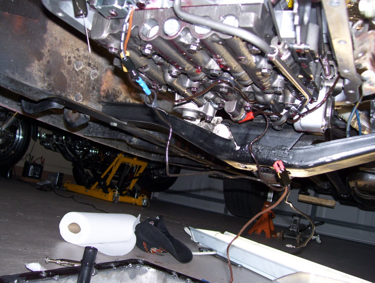

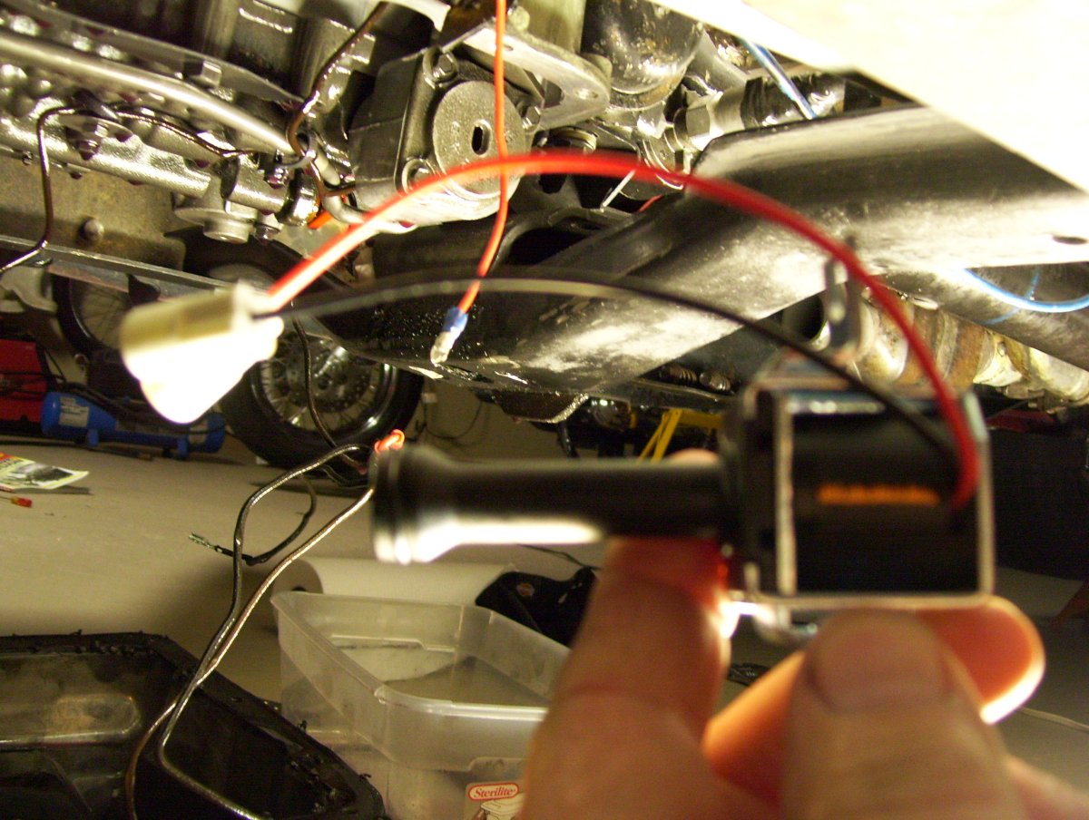

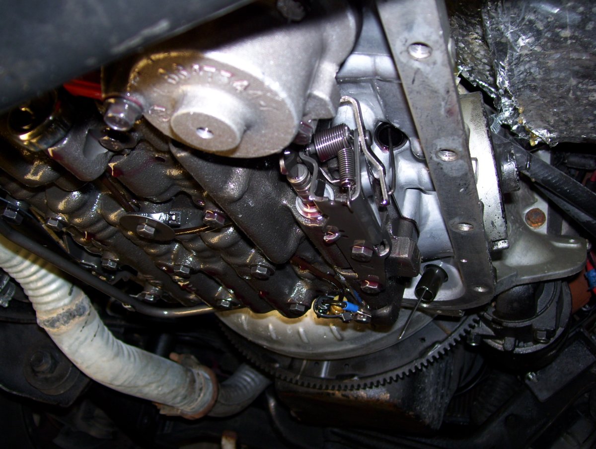

EDIT: later that same day....I put it back in the air to spray bomb some weld mods./missed spots/etc......now that the xmsn is shifting good manually, I'll connect the overdrive switch/wiring all the way to the dash using the leftover OEM wires that are color-coded from the OEM Ranger overdrive harness.

Pics of the Xmsn rewiring.......................

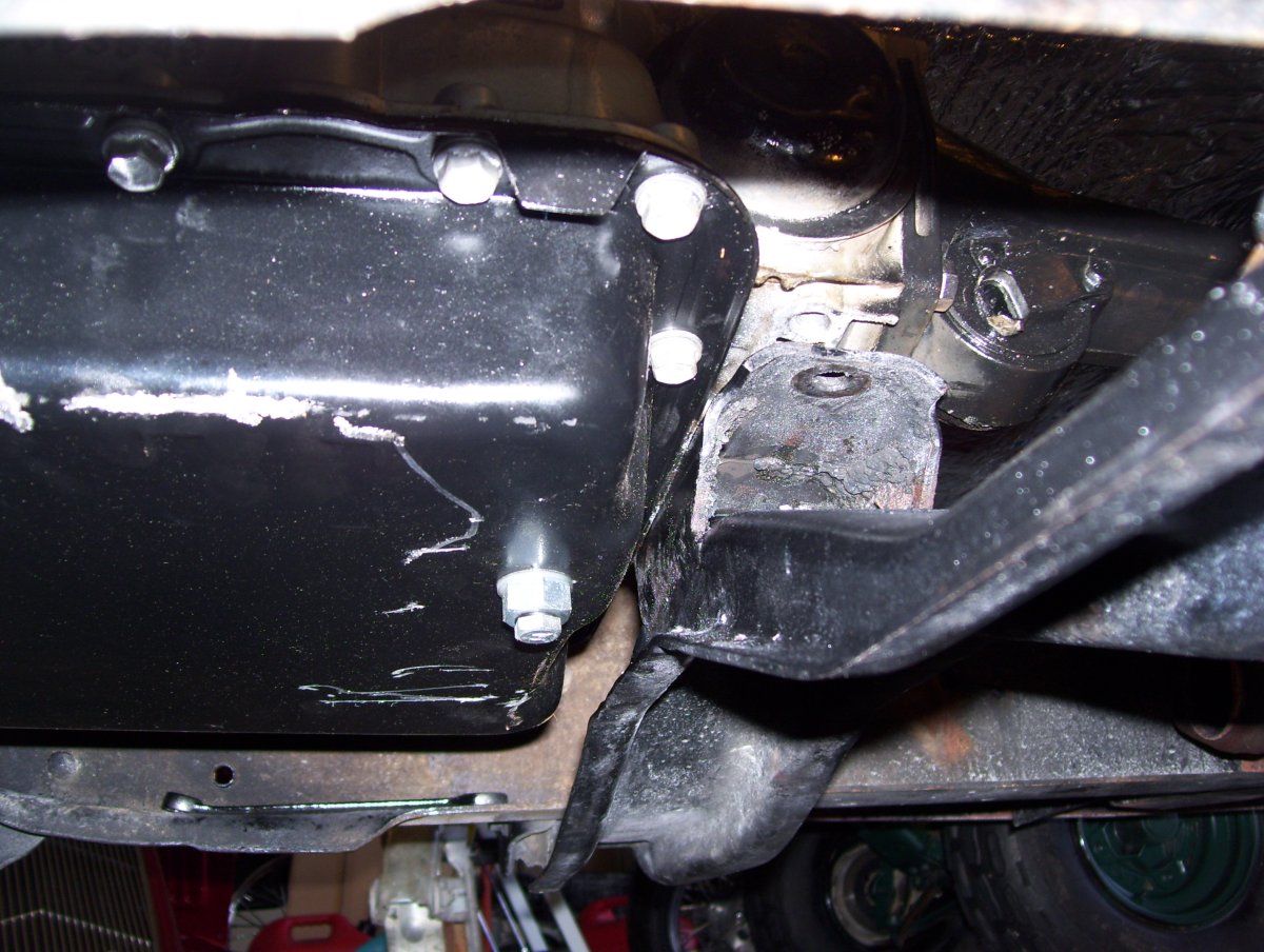

Now that it's actually shifting into 4th, it turns 2800 rpm at 60......just like when the 2.9L/AOD drive train was in it.....ap-parrotly the xmsn has a bad 4th gear pressure switch, because I wired up the O/D from the ign. to the low vacuum switch to the dash ON/OFF switch to the xmsn, but it's still not shifting into O/D........a minor technicality....I enjoy removing the xmsn pan....Now that I welded a QUIK-DRAIN PLUG into the bottom of it!!!!!
When I get back home Sunday, I'll drop the pan & check everything with an ohm guage & pressure check the 4th gear switch & lock-up solenoid & add that xmsn pressure guage whilst I got the truk off the ground agiiiiiiiin...
