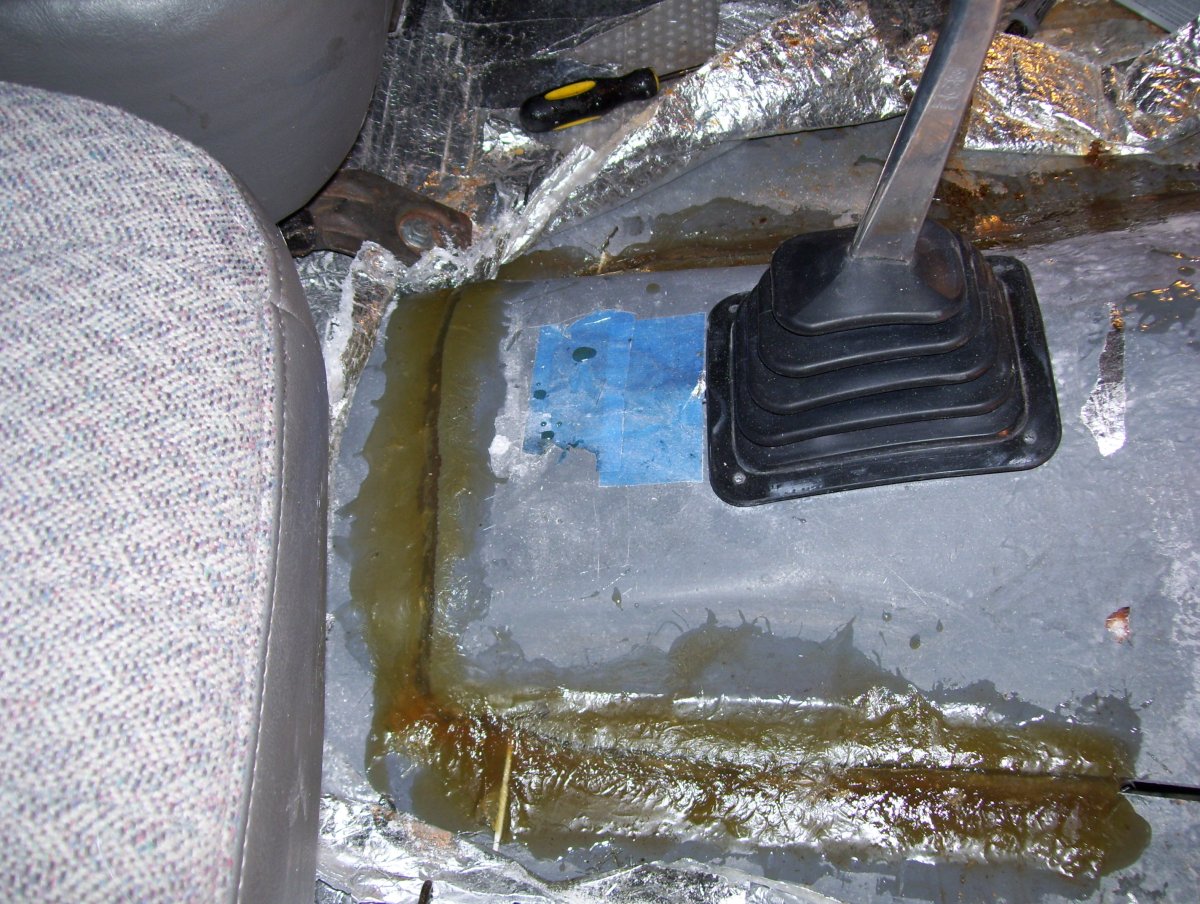

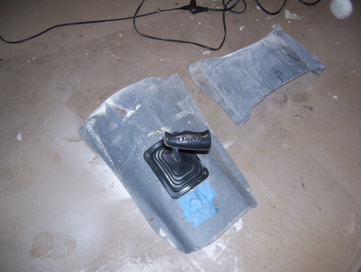

The tunnel is going back in place....in 2 pieces.....it's a lot easier raising the section with the floor shifter & getting the bottom of the shifter to clear an inch over the xmsn than the 1/4" i was getting wrestling with a 42" long chunk.....then the 2nd piece.....the hump at the firewall which needs raising 2" to clear the top/front of the xmsn & the ports for the cooler fittings/lines..
The rear half of the tunnel is glued in place.....gotta go get some more paalaastic hardener tomorrera...

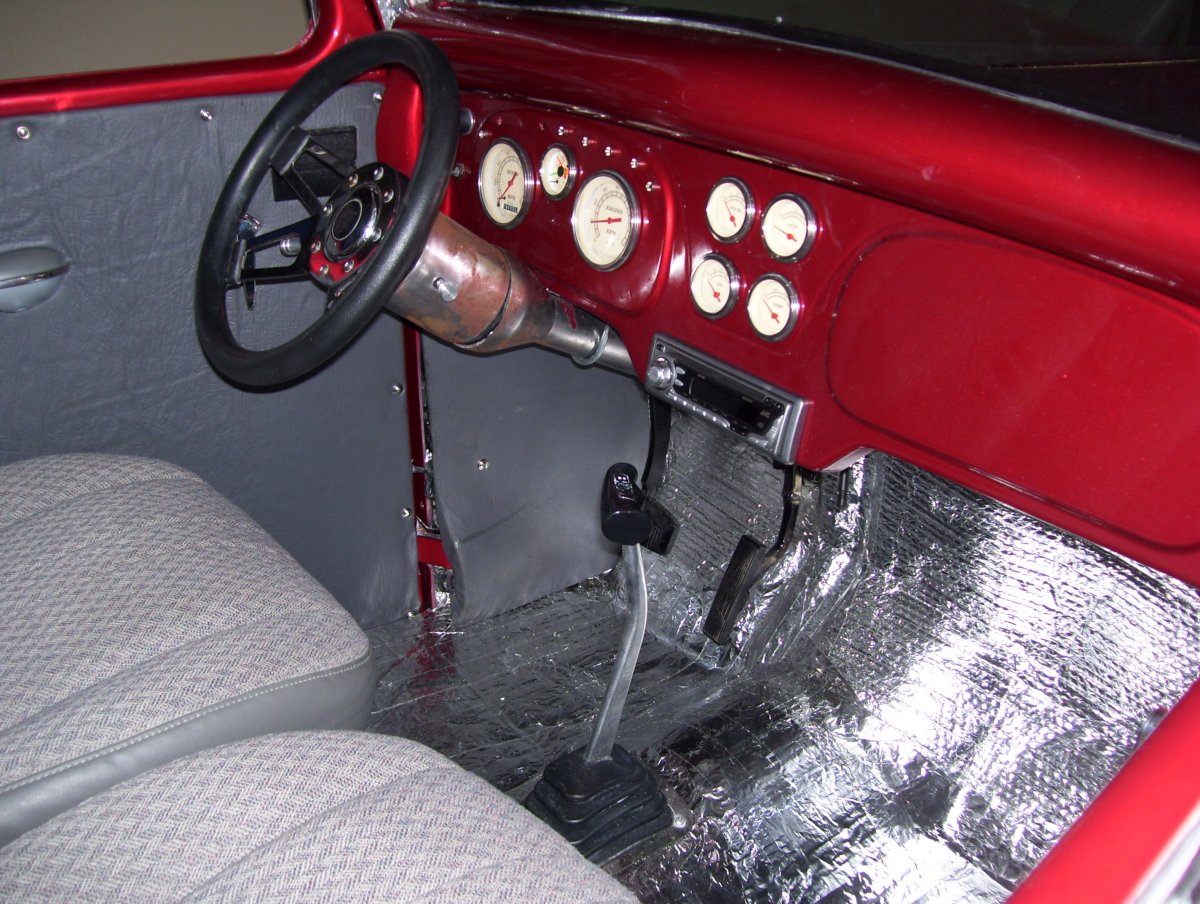

I just about got the last section of tunnel replaced.....and I'll add the last layer of insulation before I drop it off at the upholstery shop to get the floor covered....I'll miss the sound of the A/T clicking thru the gears & the pavement flying under my feet....

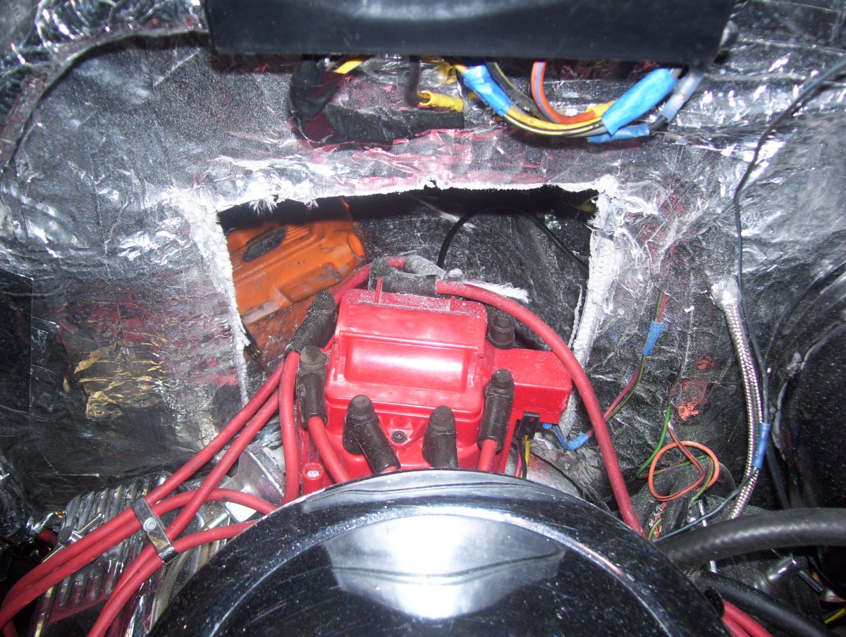

You can see an aluminum panel above the freshly glued trans tunnel...the panel is 3" deep into the firewall to allow room for the distributor when I moved the engine rearward to install an electric puller-fan on the back side of the radiator.

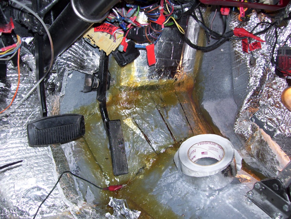

the flo-boad is notched/re-arched & re-installed....
now I gotta get in there with the new shiny-stuff-insulation & put a fresh layer of it over the 1st layer of heat/soundproofing....

The floorboard is tooo-getherrrrr aginnnnn...
Another layer of tanning blanket is taped in place...
Annnnnd new flo-mats are gonna keep it from getting nasty til I drop it off next week at Mad Man Marks' upholstery shop!
