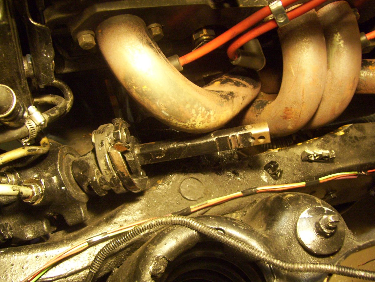

Tomorrow I'll try & move the steering column over to the left 1 inch so's I can use a 1 piece steering shaft from the end of the column to the rag-joint on the steering box (eliminating the coupler & 2nd universal joint)
Then the steering shaft won't get so hot causing the fluid to boil in the steering box......
I also will avoid having to use 2 universal joints to reconnect the steering box shaft to the column lower shaft........

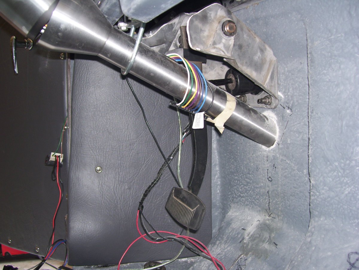

I have to move the brake booster/column support over to the left 2 inches....then I has to move the brake pedal 2" to the right....
then I has to move the steering column firewall hole 1" up & to the left & move the column dash bracket 1/2" to the left...
then I gots to adjust the tilt mechanism on the column so that the steering wheel sits parallel with the dash & centered with the driver's seat...

Update: the brake booster/brake pedal bracket is now moved left 2"......the brake pedal arm is modified so it sits 2" to the right where it needs to be....

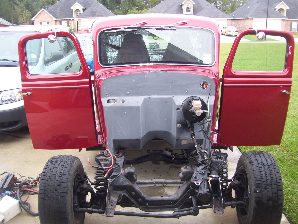

the steering column needs moving to the left to line up with the steering box.....now to the hardware store for supplies to seal up the unused holes in the fire wall.....i
You can barely notice the the steering wheel is now off-center to the lefy...good news is it not is centered in the middle of the seat!
One small step for man......one giant leap for the lab-rat!!!!
the steering is did......the wheel in the cab now turns the front wheels....

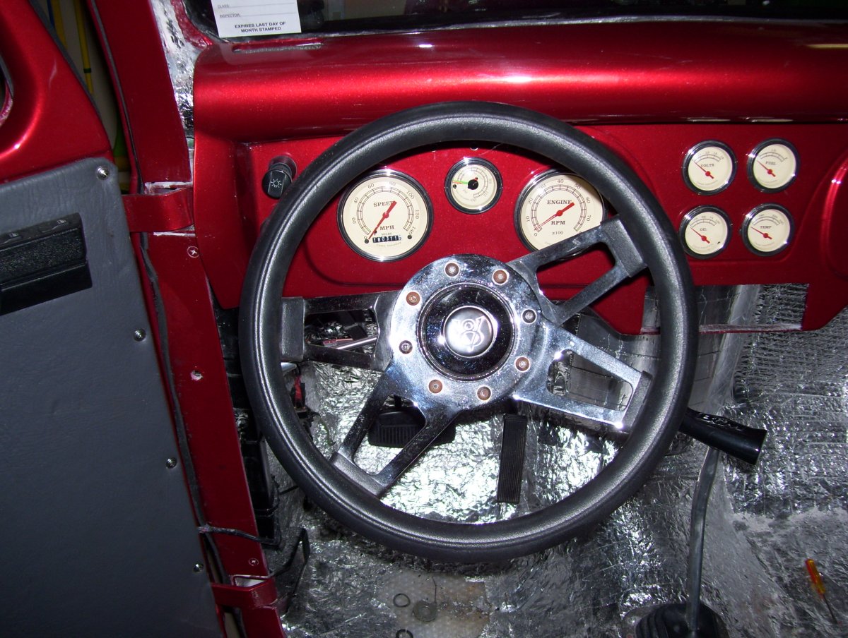

looks Great DG!!!! hows the inside look with the chages you made?
Mn_..........everything looks the same......brake pedal is relocated in OEM bracket to be same distance from gas pedal as OEM........steering column is almost directly in line with steering box spline shaft......steering wheel is 1" left of center but isn't noticeable when sitting in drivers seat....tilt column didn't have to be rotated left or right (like I thought it would) to get the steering wheel to be square with the dash.....only had to use 1 universal steering joint (instead of 3 joints w/bracket support like i thought)....those aftermarket steering columns are great---you can fit em anywhere....
