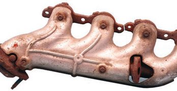

Well I’ve given up trying to find headers. I spent some time today drawing up a flange pattern based on the exhaust gasket. There’s a huge steel fabrication company right next door to my shop. I figure based on some other stuff they’ve made for me, they’ll cost about $50 for the laser cut and materials. I found 3>1 collectors and pre bent 1 1/2 exhaust pipe bits at Jegs. I figure all in all it’ll cost me less than $200 to make a set. If they turn out, I’ll have them ceramic coated. Now that I’m down the Offy 4bbl rabbit hole, I ordered a stage 1 cam from Summit. Pics coming........

Headers/exhaust manifolds are engineered to provide lower pressure at the exhaust valves on that bank at a certain RPM
The size of the tube and its length to the collector decides the RPM band for lowest pressure
The velocity of the exhaust traveling down the smaller tube as it enters the larger collector causes a pressure drop in the other tubes on that collector, lowering the pressure, this causes some of the exhaust to be PULLED out, leaving more power on the crank because it doesn't have to PUSH it out
It's called scavenged power because it's free/scavenged from exhaust velocity
This is also where the MYTH of Back Pressure came from
Car makers have been using this scavenged power since the 1950's
People would put larger pipes/tubes on the heads and then LOSE POWER
They would attribute that loss of power to "engine must need back pressure"
No 4-stroke engine needs back pressure, lol
What happened is they removed a scavenging/engineered exhaust manifold and lost that extra power
There are low-range, mid-range(stock) and high-range(racing) designs for scavenging exhausts
Even single "straight pipes" have a perfect diameter and length to get a scavenging effect at a specific RPM
