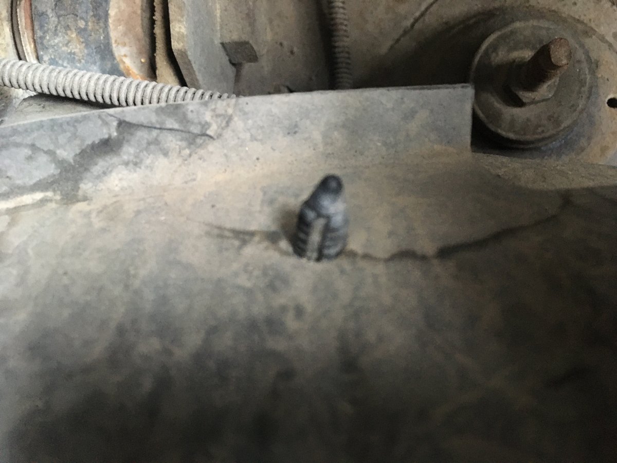

ALSO, what is this big ball thingy? could this be a source of vacuum leak
I am novice mechanic trying to teach myself how to do this :0

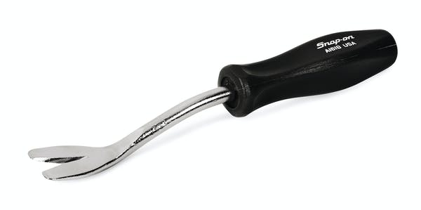

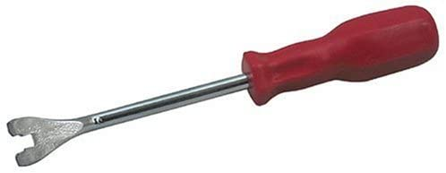

We don't say "ball thingy" here, that's a vacuum reservoir. In the past they looked like soup cans.
That will pop right out with an upholstery clip tool. I bought mine from Snap-On in the late 70's for $30, you can find one for $7 or so that doesn't say Snap On but will work fine.
67237
The Snap On tool looks a little nicer
67238
will it just pop out with my hands and/or a small screwdriver?
