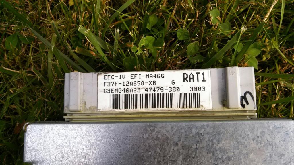

heres the pic on the tag of my current auto ecu:

Yeah, the part number in the pic you posted crosses to a 4.0, A/T, probably California emissions.
