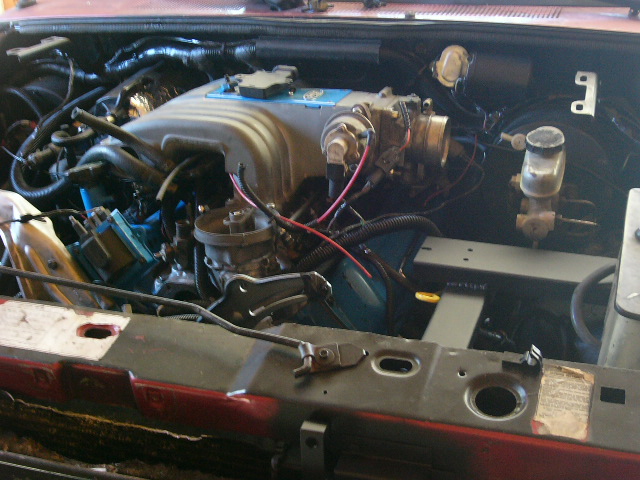

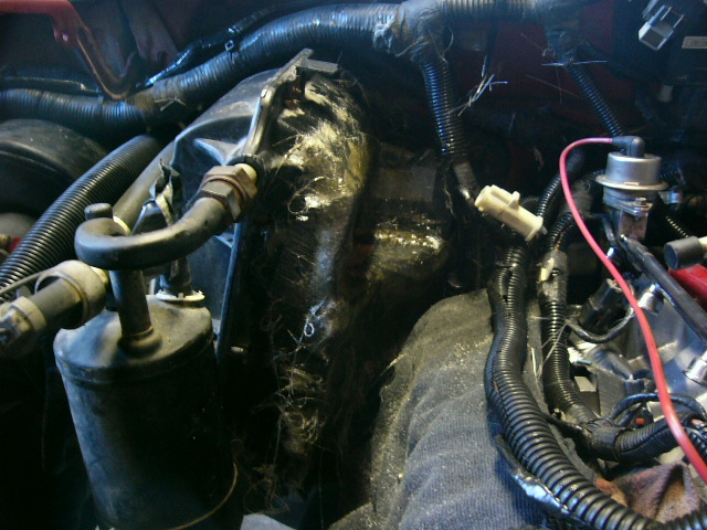

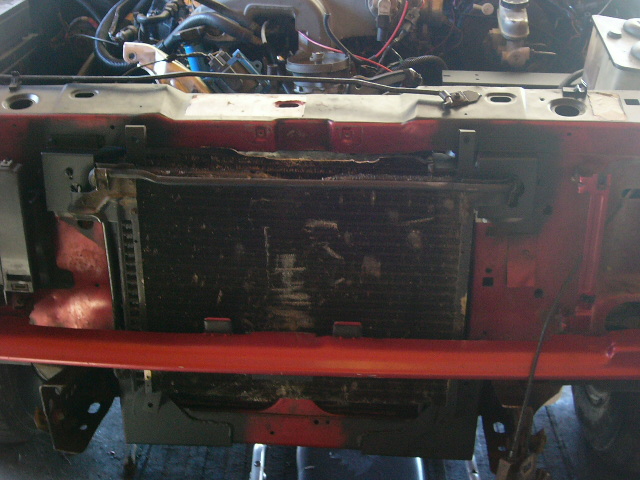

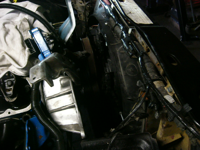

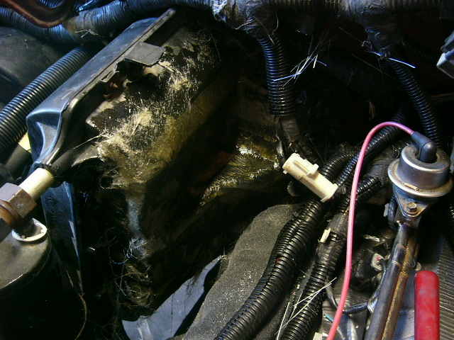

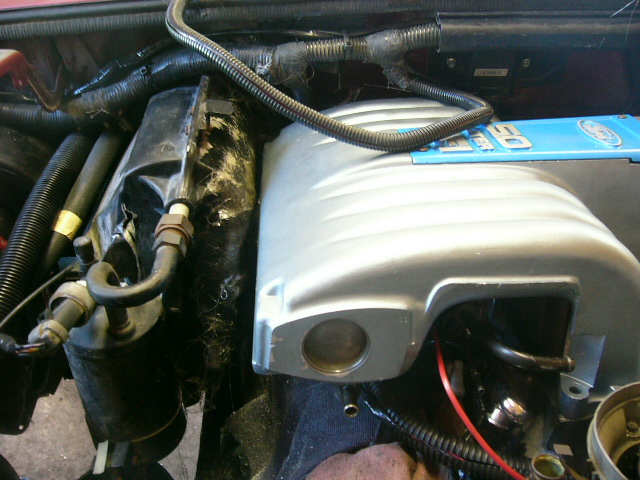

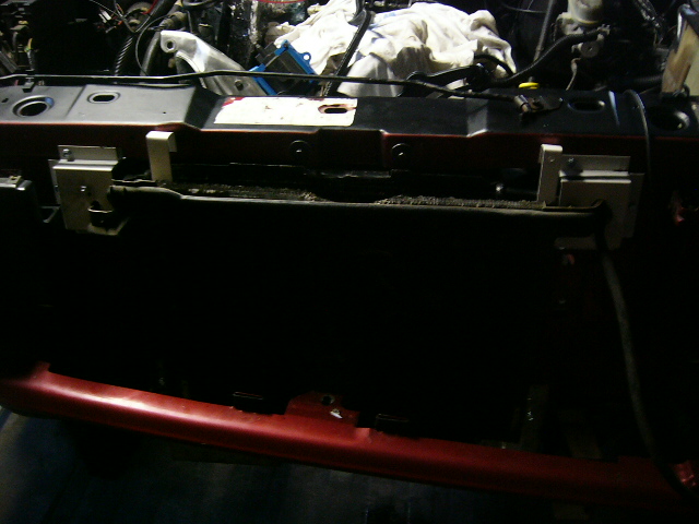

here are some pictures of my heater i cut quite much of it out because im going to run my plenum the way a crown vic and other cars had theres. But mines is an HO. i have plenty of clearance to run my air filter attachments and all my wiring has been lengthen. Also 1 picture is of my radiator and how i made a holder so my radiator could go forward. The other holes you see in that picture are for my condenser. Hope you like it.

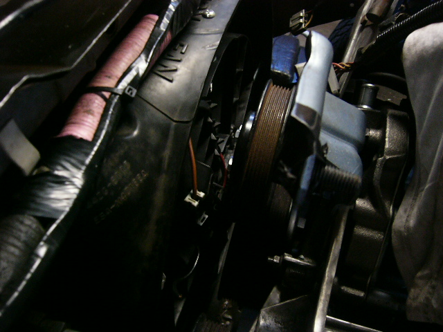

here are a few pictures of my front end coming together. also i put the electric fan in and it really fits well.

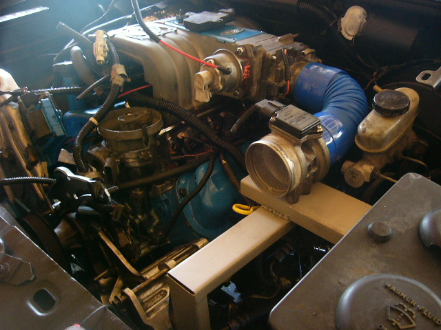

Update on my truck
I have wired the efi system and i have voltage going to EEC and fuel pump works and TFI is giving the correct readings to start motor. I have primed the oil pump the motor sounds good when just turning it over i haven't started it yet tho. I'm just coming up with a way of mounting my mass air system. You will notice in picture my frame that i made to mount it to. My motor is HO but i decided to put my plenum the opposite way this is why i had to come up with a mass air system mount.

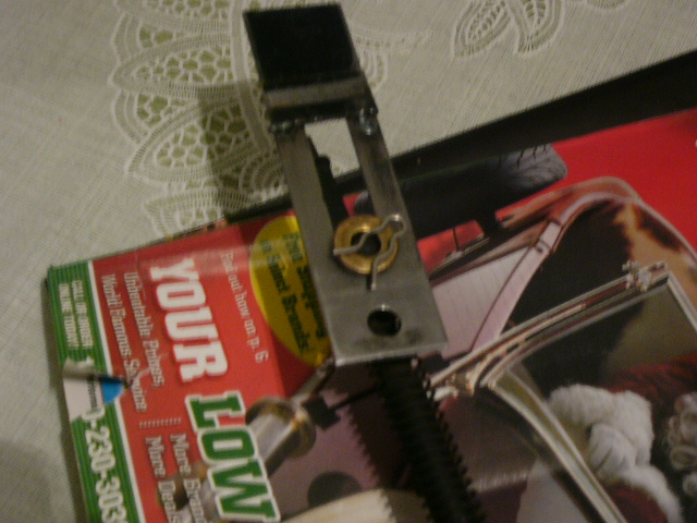

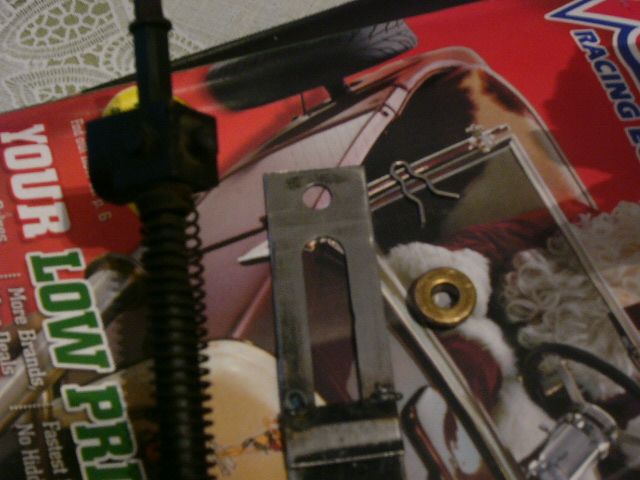

c4 kickdown cable bracket extension
Hey guys this is what i made for my c4 kickdown cable extension i didnt want to buy 1 of those pricey lokar ones. I used a piece of metal and cut a slot in it so when the throttle is fully open the c4 tranny engages about 3/8 of and inch real simple and cheap. I got the piece of brass and clip off an 89 crown vic i believe but that came from the junk yard.
