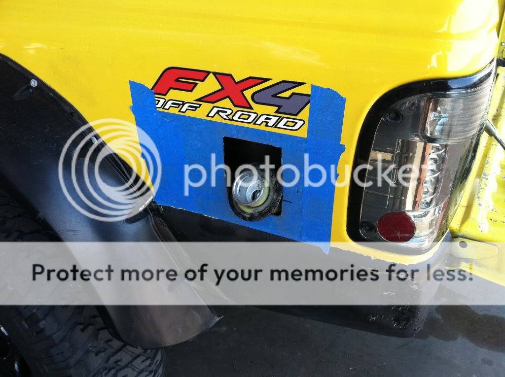

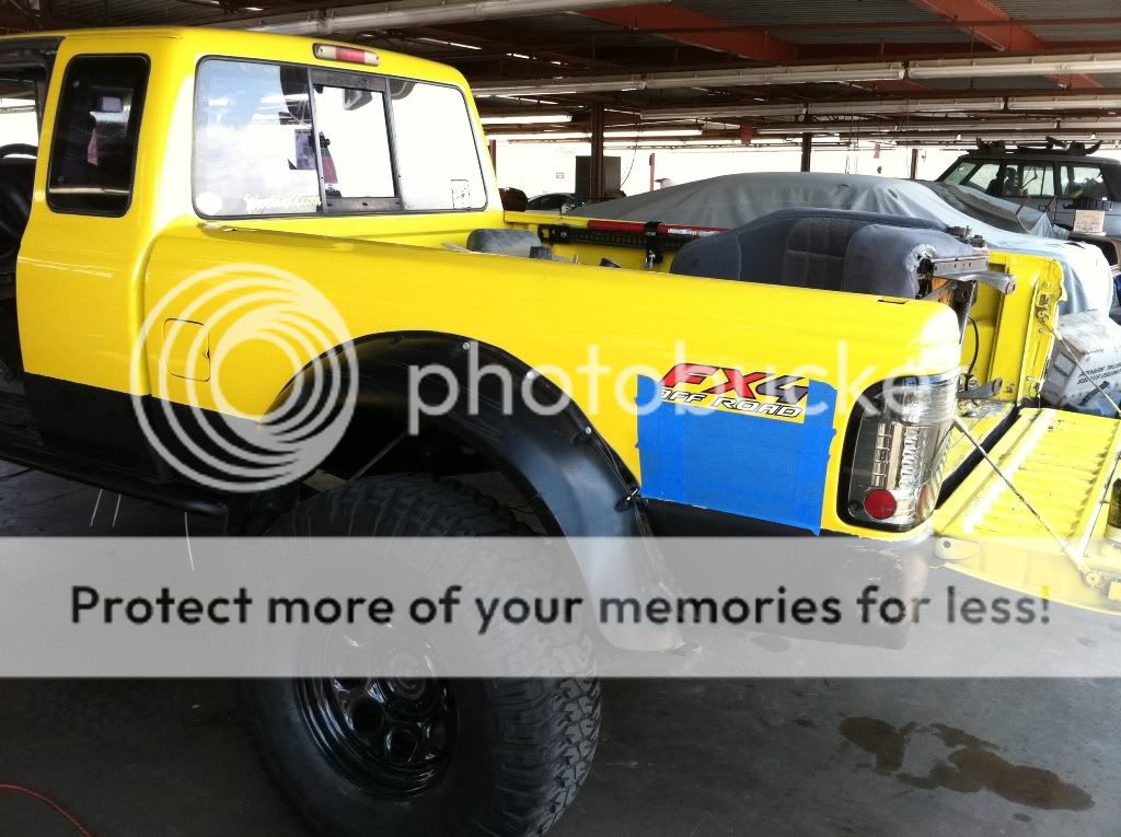

Finished what i started today. First, I laid out some blue tape where i wanted the hole.
Josh40601's Build Thread. (D-ranged)
Then i cut a hole in the good side of the bed
The bed and the filler neck were not getting along, so i cut a chunk out of the bed that i will fill in later. (sometime this week)

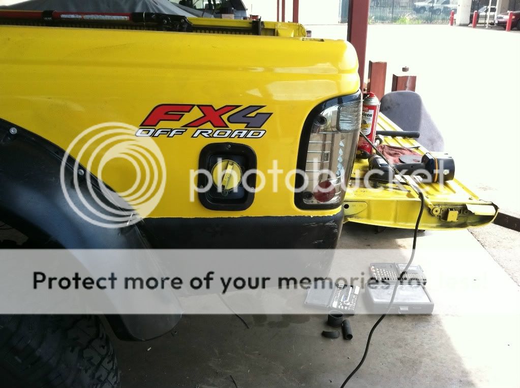

Then i drilled my holes, and mounted the new-to-me Jeep Thingy

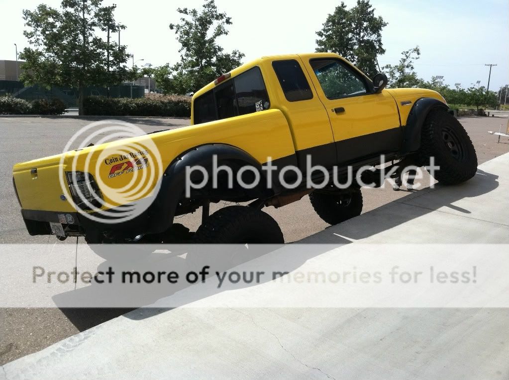

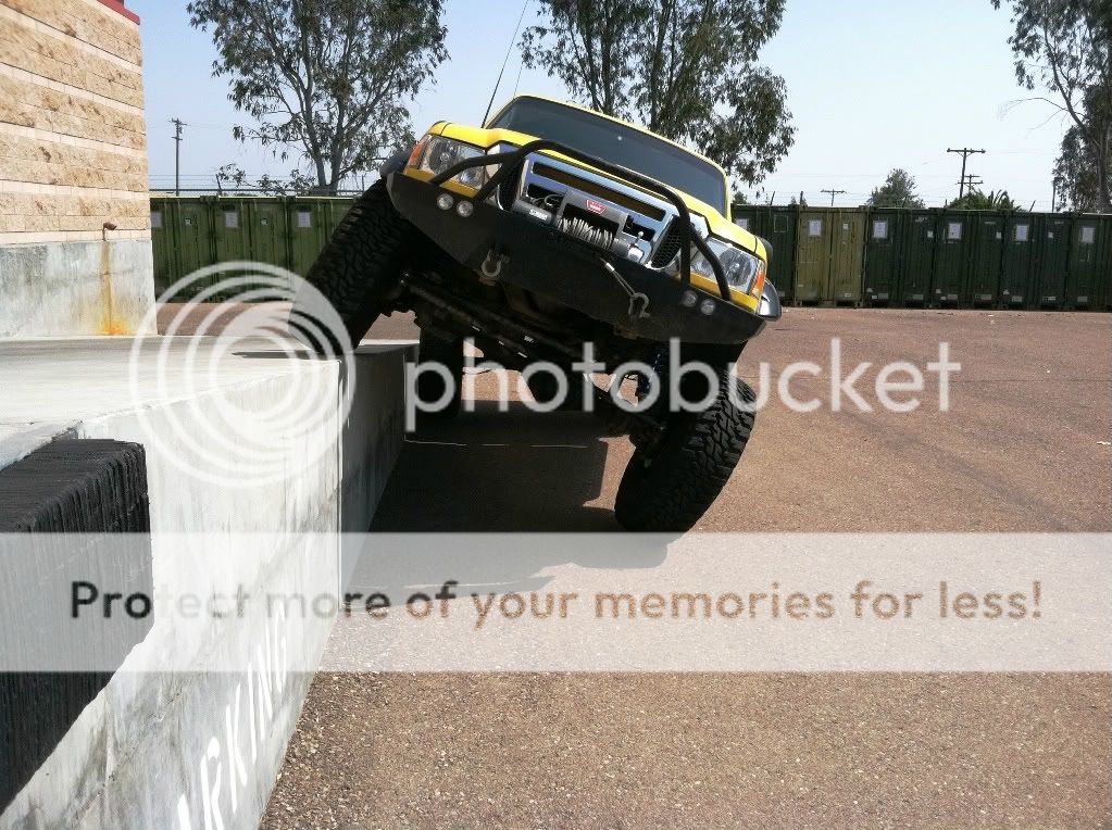

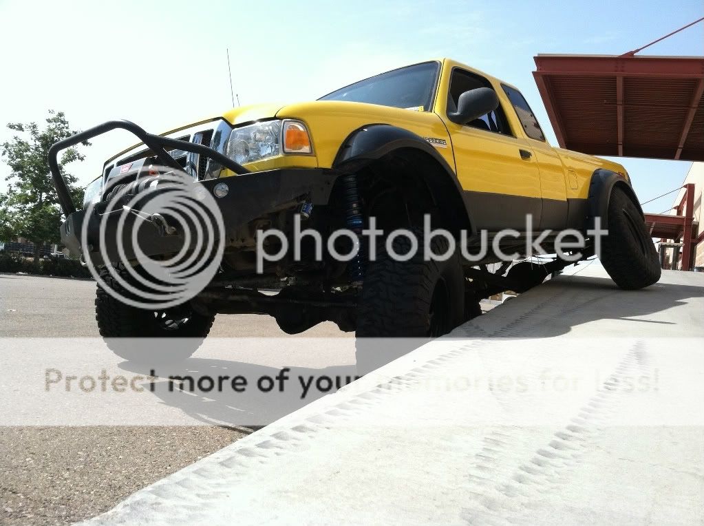

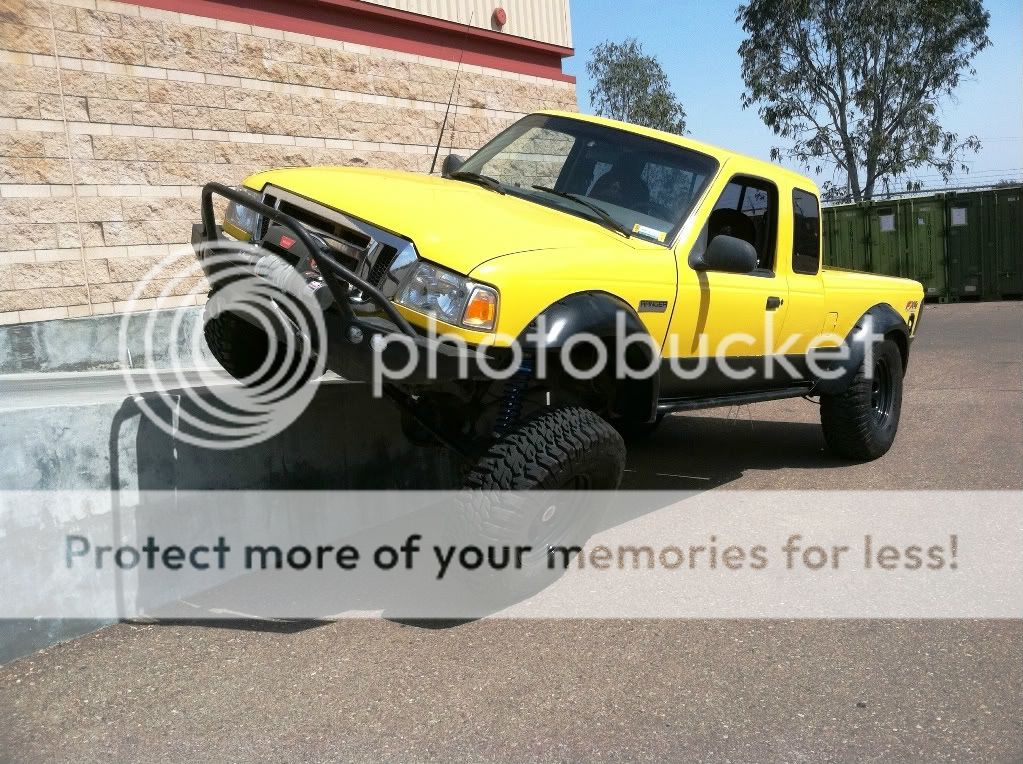

Once i got all the filler neck crap done, I installed my new-to-me driver seat. Next on the list was to install my new coils. I took the old 450 coils off, and put on a set of 200 coils on top, and moved the 300 coils to the bottom. I'm not too happy with the change, as it doesn't seem to flex out any better than before. Maybe it is due to running 2 14" springs? Still not sure, but i am glad it lowered the front end down. A LOT.
Took some loading dock poser shots to see if she flexed any better. Not really any different.

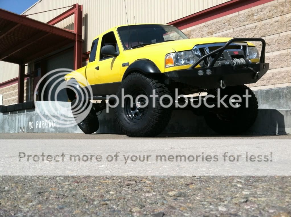

And my favorite shot...

nice zip ties lol. how come you dont have a regular hook on your winch line? id think the clevis would be a pain to always having to unscrew it.
Some use duct tape, I use zip ties :thefinger:
Clevis works. Never got one when i got the winch
zip ties are better anyways lol truck looks good either way.
i thought maybe you used it for a suck down winch but i didnt remember seeing a d ring on the front axle
Gotta love that frame flex in the articulation shots lol.
nope. Just never bought a hook. I get shit for it all the time from the guys i wheel with.
It's a lot better than it used to be. The crossmember i put in for the gas tank helped a little

Are the control arms keeping the front from flexing more?
That could be it as well.
i like the "no parking" on the last pic lol.

when you gonna fill in the old gas door? i'm rushing you.. i know... oh well!
