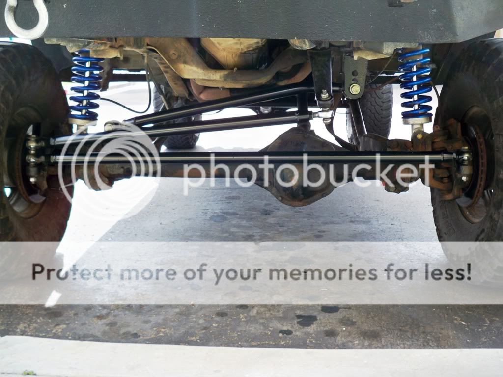

Well, I got the steering redone this past saturday. (I know, i will give you guys pics when i get home) Upgraded from the mild steel that was on there, to 1.5" .120 wall DOM with 3/4" rod ends on 5/8" grade 8 bolts. For the track rod, i went with the same tube, but went with 7/8" rod ends.
The balljoints are shot. They were the old ones from when i bought the axle used, so no telling how old they are. I just ordered 4 new ones. Hopefully get those in next weekend.

Here is a shot of the new steering
how long do heims last for you? i've heard not to use them on a DD, they wear out to quick
I've got a heim on my trac bar. Had it for 2 years now and its starting to get loose. Not sloppy, but there's little to no resistance to rotate the ball in the body. I'll probably replace it at the end of this season. I see a decent amount of sandy watery mud too.
but what about on the steering?
mine are already showing signs of wear.... Even though rod ends wear out quickly, the only thing that wears out is the Teflon. They just make noise, but still work. They make rod ends that can handle daily driving, they are just expensive. when i redo the axle, I'll put the good ones in.
hey Josh....just an observation.....
I think if ya were to pull the bolt on the pitman arm and put the link on top that you would then have it more parrallel with the track bar....
however, I do think it looks really good:icon_thumby::icon_thumby:
l8r, John
Its the line running from pivot to pivot. Not too shabby where its at:
