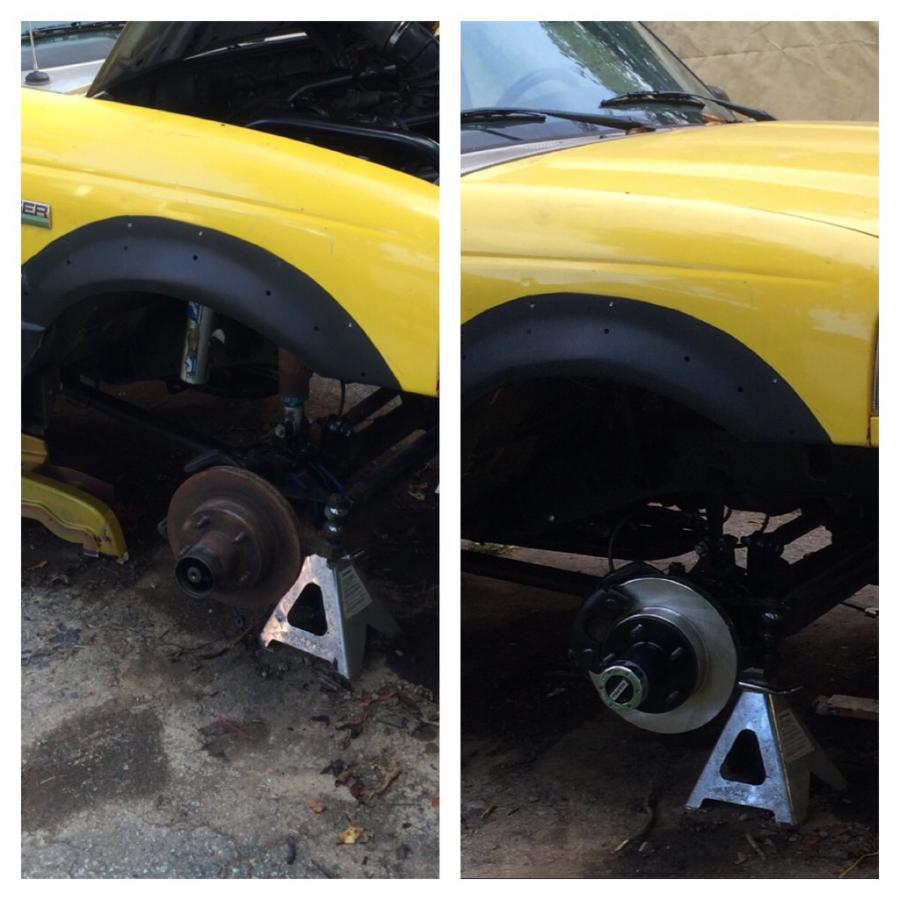

Last two days were all about rebuilding the hubs brakes and bearings. After cleaning or replacing everything, the axle shafts won't go into the lockouts.
I'll deal with it after paint. Coilovers off, springs going on tomorrow, tune up, and off to the body shop

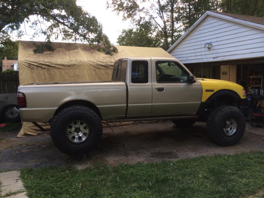

Topper off. Battery cables ran to the bed. brakes plumbed. tune up complete. Shocks back together.

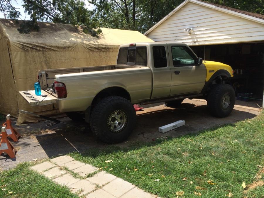

Definitely has that lean that I'm not keen on. It does have about 300lbs of shit in the bed but it's still wayyyyy too low in the back.

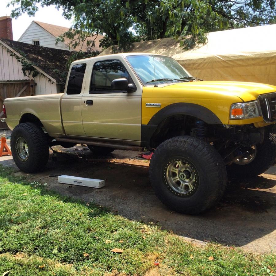

This is level. I'm hoping it settles as id like it about an inch or 2 lower, but I'll be ok with this as long as it rides and drives well.

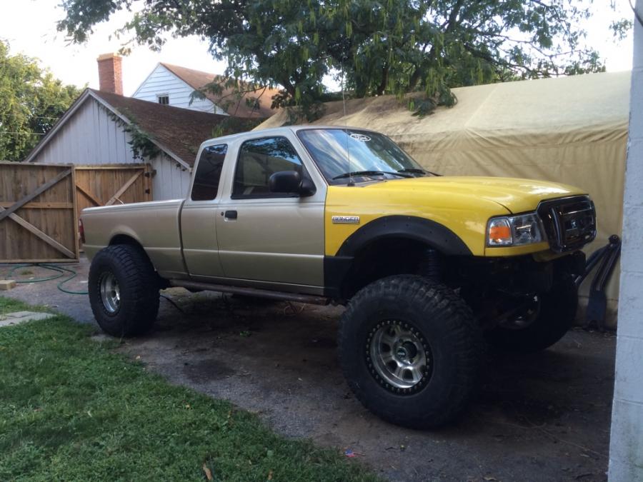

Still got that bro lean, but close enough. I'll likely just use a shorter spring up front and call it a day.
