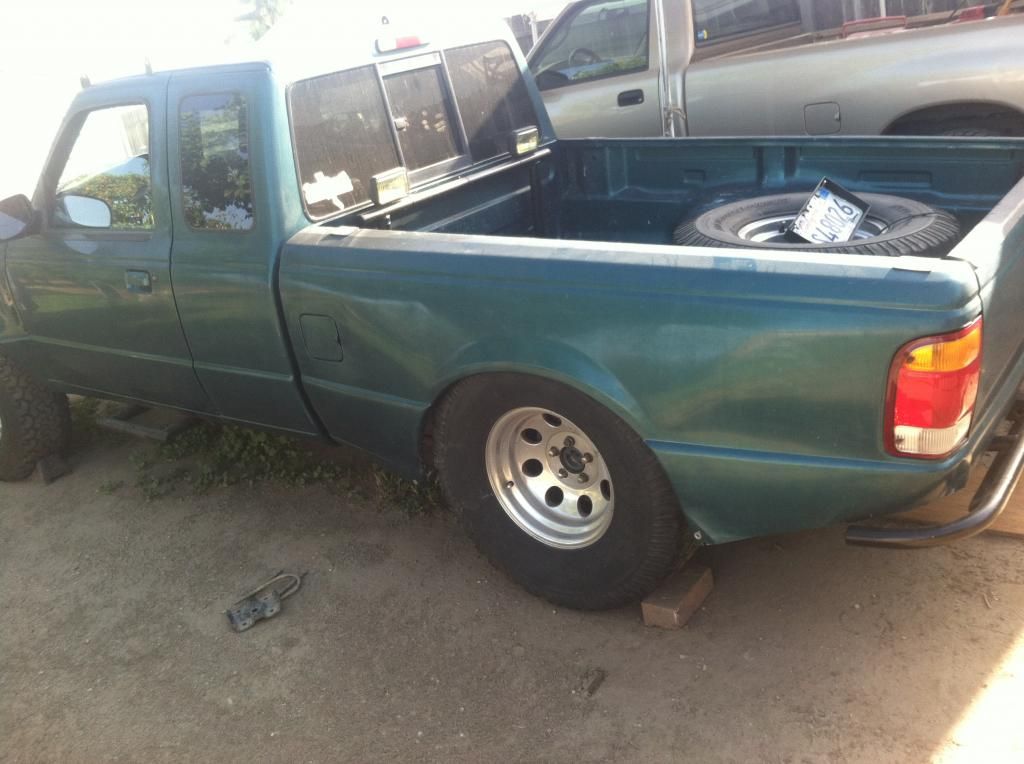

leafs were sagged out when I bought it so I had a leaf added and the packs re arched

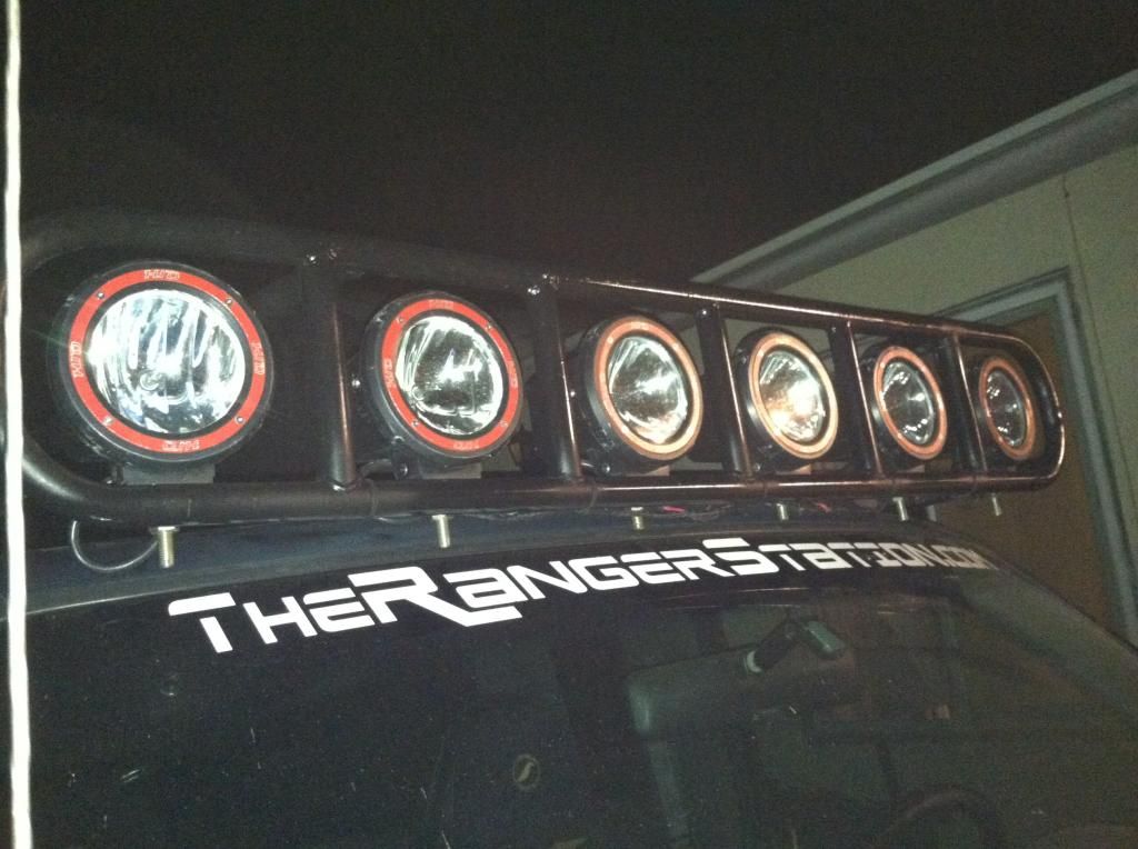

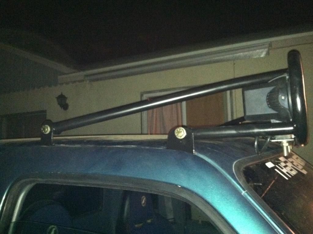

while the truck was torn down in the backyard I decided to build a roof light bar. picked up 6 4" kragen red rings for a steal from a buddy selling his inventory. so got straight to it and knocked it out in about 2 hours

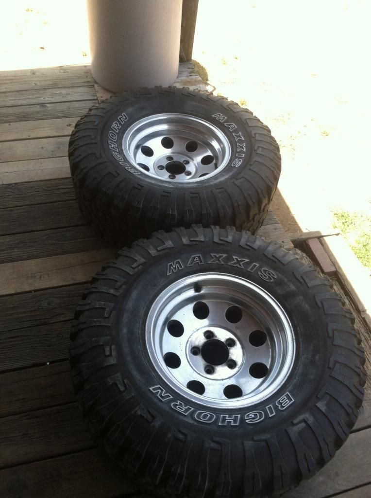

also picked up 2 maxxis bighorn mts from a guy on DR and got those mounted

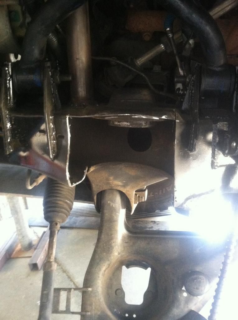

and finally the biggest change of the truck, mounting the coilovers. being an xlt had to plasma cut out the stock coil buckets and plate in the frame. went to my buddys shop, bbm offroad in brea, and used his plasma cutter. cut out the buckets and cut out the plating and got it all welded in. had the temporary shock hoops fre fabbed and installed :icon_welder:

Could you post a better pic of the roof light bar?
sorry for the lack of updates guys was busy with work and just went on a 10 day hunting/camping trip. pics are on the way

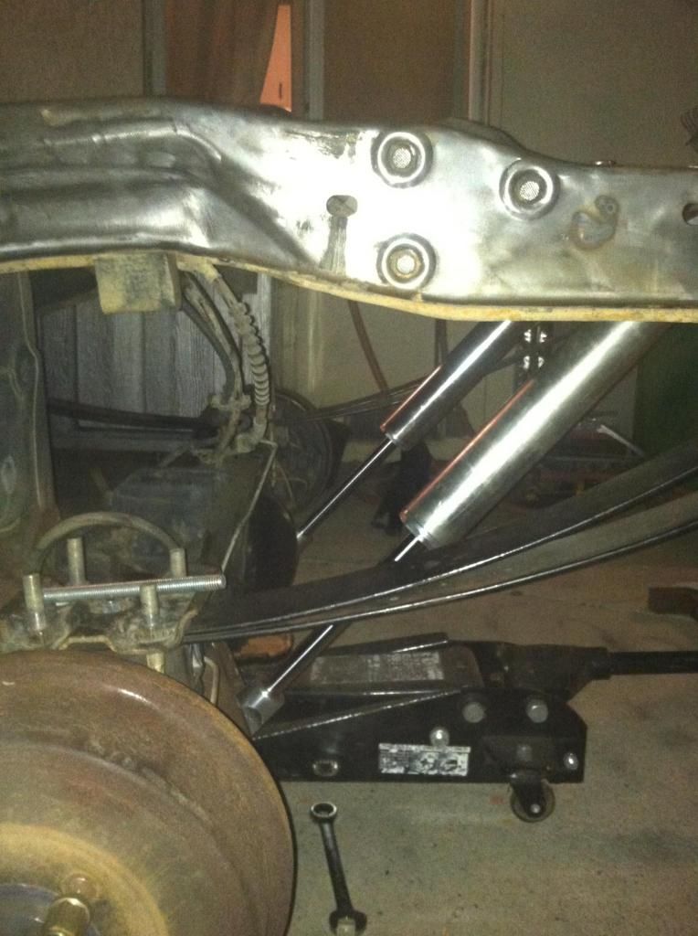

and heres the update on the truck. I pulled the bed cleaned up the grease oil and gunk. welded the seam on the frame and the gas tank cross member. was gonna do more tubes between the frame but I ran out of tubing so that will be down the road. I cut out the stock crossmember that held the charcoal canister because it was in the way and cracked. moved the shackles and hangers back to gain droop and minimize leaf separation. mounted 2.5x 10 foa shocks just enough to clear the bed and maximize travel while keeping the angle somewhat decent. will be changed eventually as I plan to canti the rear and do sua. so when I first tore the truck apart leafs cycled 11". after moving the shackles hangers back went up to 16.5 with no shocks and with little leaf separation. limiting my droop was the driveshaft hitting the crossmember. gonna bend a 180 at my buddys shop and weld that in place of the crossmember down the road sometime in the future. once shocks got mounted cycled 15.5. got the pack together and had little to no leaf separation at full droop. only thing left is to get straps mounted. already have 20" straps. next thing on the list is to get all the parts together for the front kit and buy material. heres the pics I got.

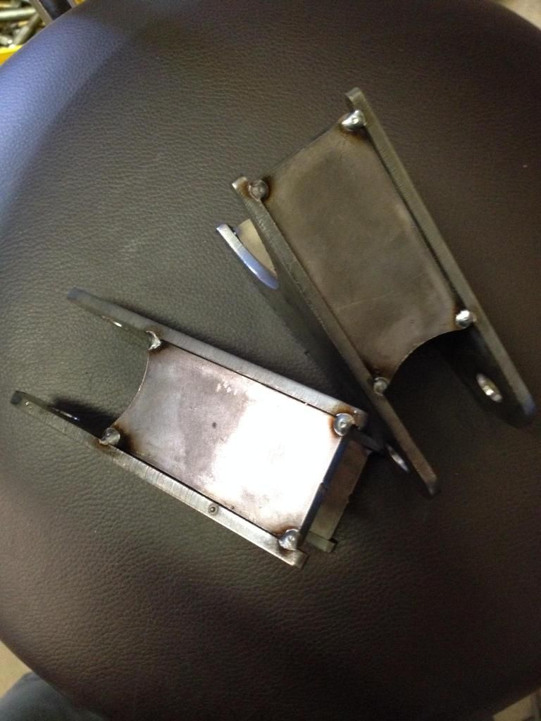

heres the shock mounts that I got from bbm offroad. in house cnc cut
full bump
full droop
