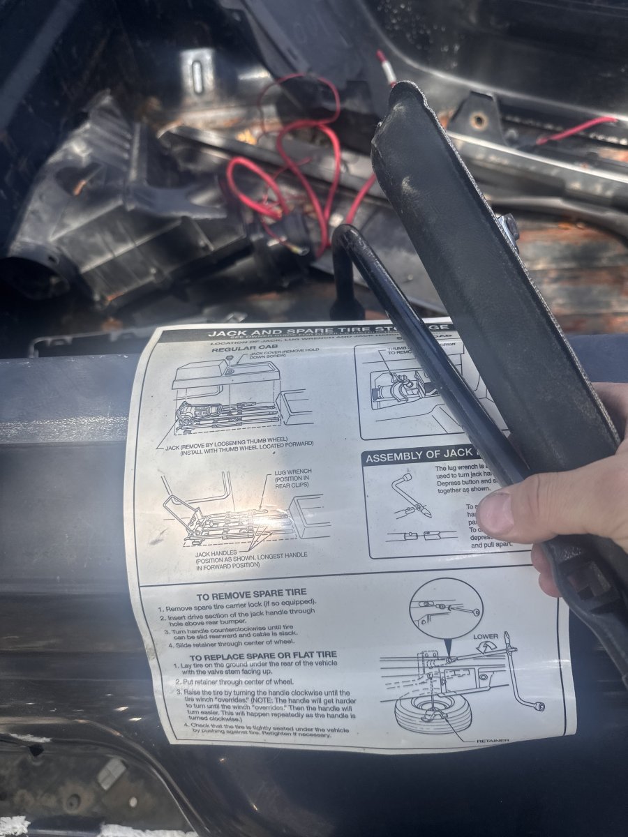

Found an original lug wrench, extensions in bag, and document for the jack while at the junkyard dropping off the old rear end. Also got replacement bolts for the seat since I’m missing 2.
Not bad.

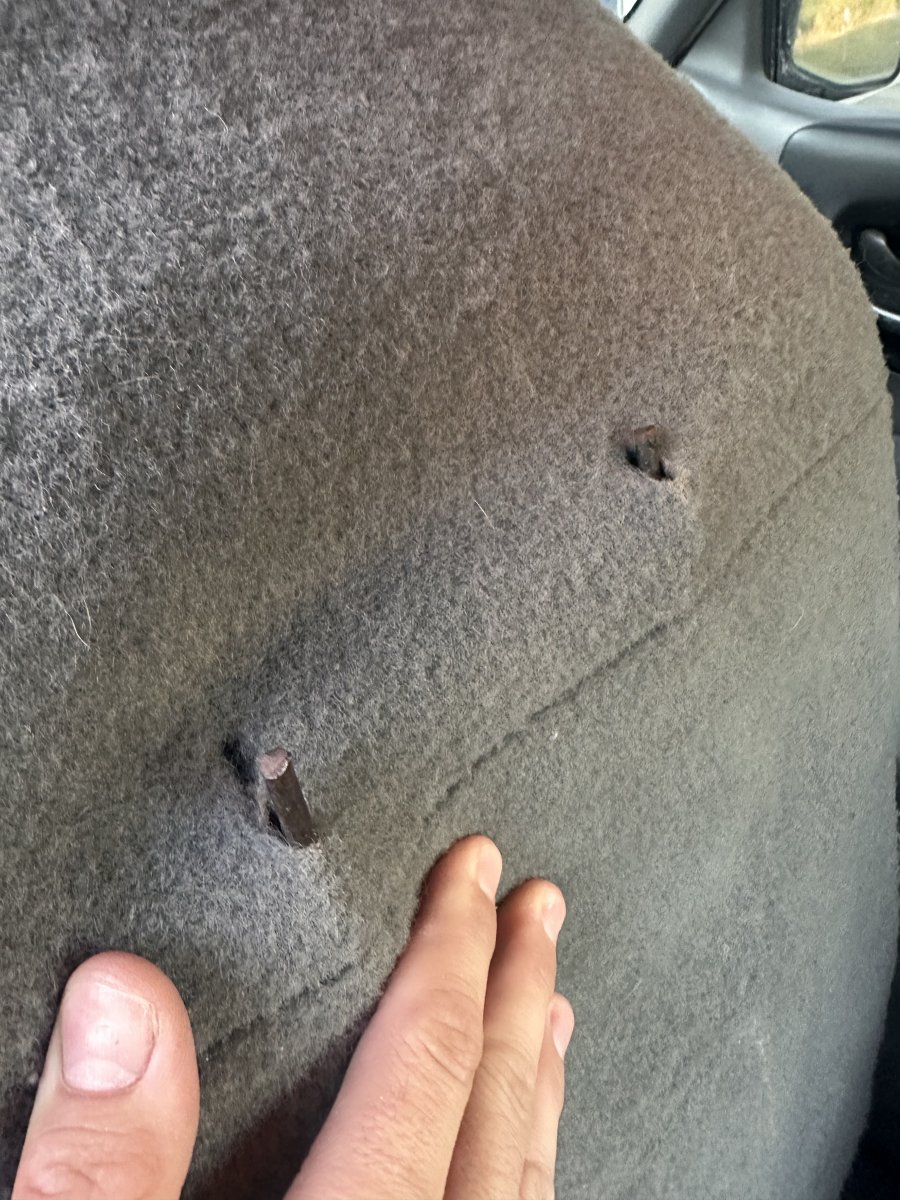

Just noticed this with the drivers seat back. Guess the metal broke at some point. The rest of the seats are in good shape.
:icon_welder:
The back is pretty easy to take apart. Strip it, weld it, and reassemble.
